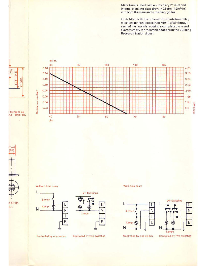

They were really good and had a search though their archives (initially they could not find the model number) and dusted off the installation and wiring guide for this actual model!
The first one shows the air extraction rate and wiring guide.
I am not sure why air resistance decreases as volume extracted increases. I would, given a constant speed, and air pressure in the room, have thought that this would be a constant. Anywaym if it gets up to around 115m3/hr, this is pretty good and much higher than expected. Even the lowest figure of 68m3/hr is good enough really.
The wiring diagram and the last page seems to suggest the white cable is for a time delay modual which was proabably an option at the time.
It's the other way around; as air resistance decreases, i.e. as the length of the duct between the fan and the outside world decreases, the volume per unit time increases.
I get it..
So i assume that the time from the lowest extraction amount 68m3/hr to the highest 115m3/hr is actually a small amount of time. So once at full speed after a minute or so should it hover around the maxium extraction rate...assuming ideal working conditions?
No.
As the length of the duct increases, the extraction rate decreases.
Of course, the more ducting..... the more resistence, got it.
I was making the mistake of think the graph was over time.....
So the resisitance in the graph, as you said in your first post, is the resitance of the ducting to the outside world. The fan therefore operates with an m3/hr in relation to the resistance of said ducting.
Am I therefore correct in assuming that as it is the top floor flat with a flat roof, and the extractor is at ceiling level; as there is a tiny distance between the extractor and the outlet, resitance should be low.
