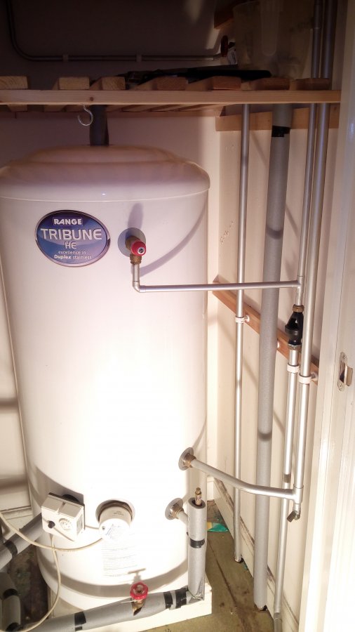

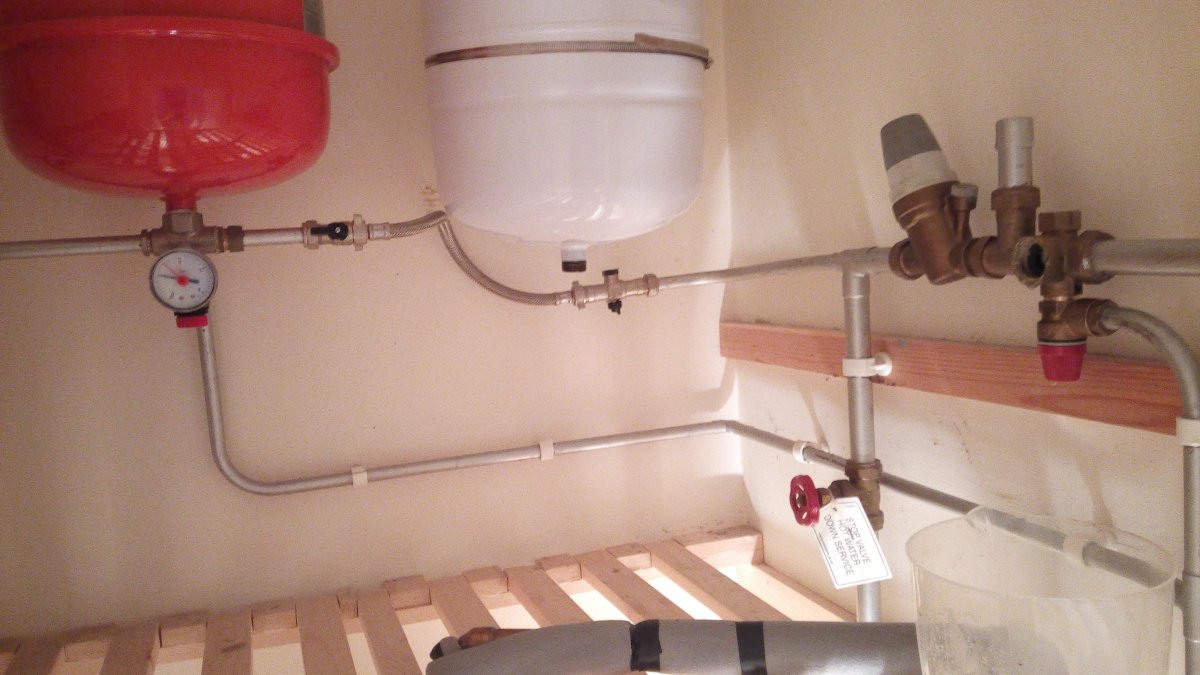

I noticed water coming out of a light socket on floor below where water tank and expansion vessels are.
Looking in the cupboard it was obvious to see the silver flexi hose that connects one of two expansion vessels was leaking and judging by the amount of water on the floor it had for a day or two.
I've isolated the water turning two wheels water inlets I assume. Turned on all the hot water taps and turned off the boiler.
I released most of the rest of the water turning the red PRV and the water went out through the tundish and then out of the house.
I simply want to replace the silver flexi hose to the white expansion vessel that connects to a PRV. This isn't a problem.
My concern is re-pressurising the system.
1) In what order do I re-open the valves.
2) Do I leave the hot taps on or off when doing this.
3) Which one of the two red wheels do I turn first.
Or does none of this matter
See two pictures of my system
I believe I'm right in saying the system pressure needs to be at 1bar when water system is cold.
Thanks for looking and hope you may be able to help.

Shouldn't make any difference what order you do it in. I'd leave the hot taps closed and then crack one open afterward to let out the trapped air.
And one bar is the target pressure when cold.
The silver hose is the filling loop for the heating system - when not filling the system both the black lever valves should be off, the hose removed and caps screwed onto the connections. Frequently the hose is left in place which means it can potentially leak and also the valves at each end can let by very slightly which can result in the pressure in the heating system creeping up to that of the incoming mains supply (might be 5 bar or more).
I assume by red valves you mean the two similar looking gate valves? One labelled 'stop valve hot water' (incoming mains supply to the cylinder) and the other one at the base of the cylinder (being used as a lockshield for the heating flow through the the cylinder coil).
The first should be fully open (close back quarter turn from full open to stop it jamming open) and the second returned to whatever setting it was at before you turned it.
Closing the red gate valves and running off all your hot water was unnecessary! Would be wise to call in a G3 qualified plumber to check the system (which should be done annually anyway) as you have been fiddling with the safety devices without knowing what you're doing.

He's already taken the other silver hose to the white (hot water) vessel off.
OP, just don't, whatever you do, buy a hose with an integral valve. The connection between the vessel and the PRV on the right must never be severed in normal use.
OK - thought he was talking about the filling loop, wouldn't it be better to replace the hose to the white expansion vessel with rigid pipework?

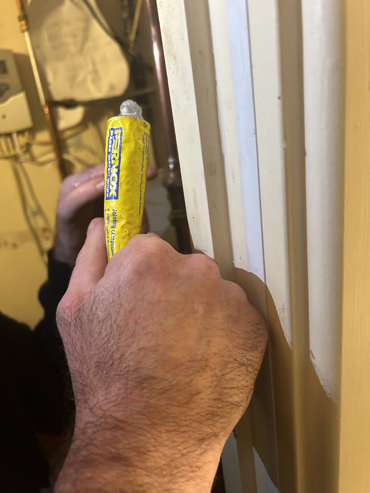

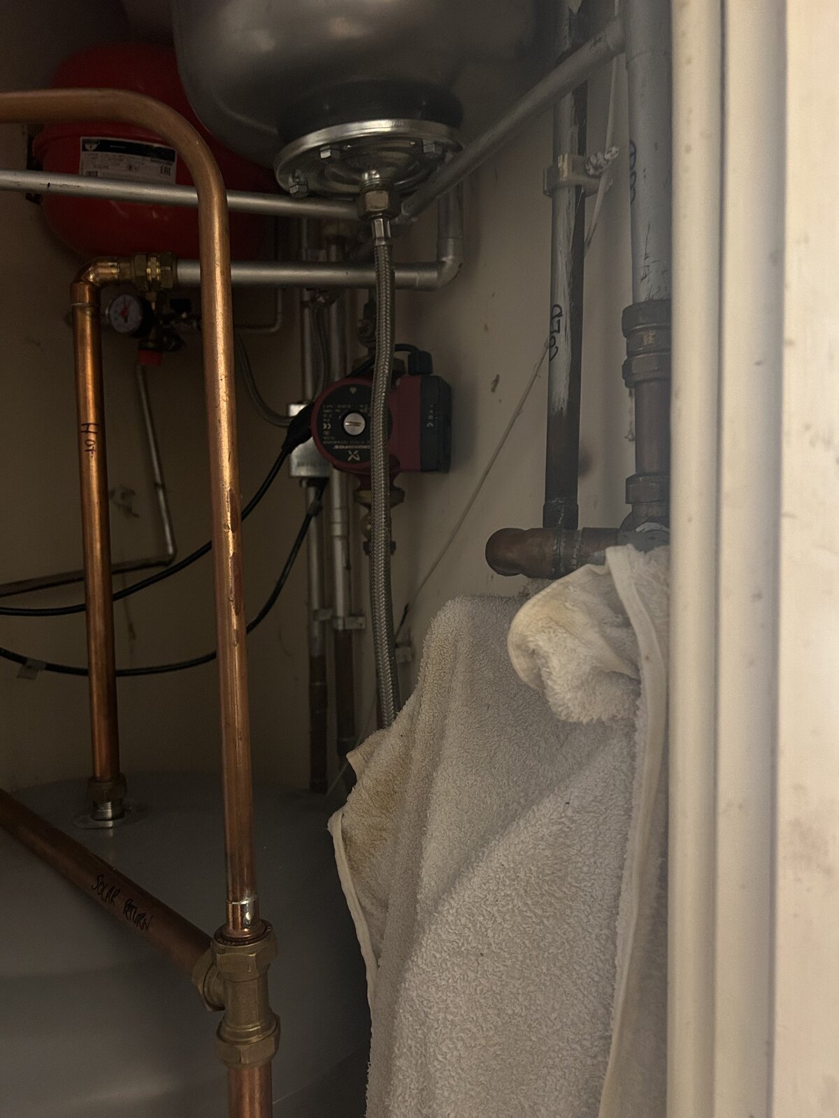

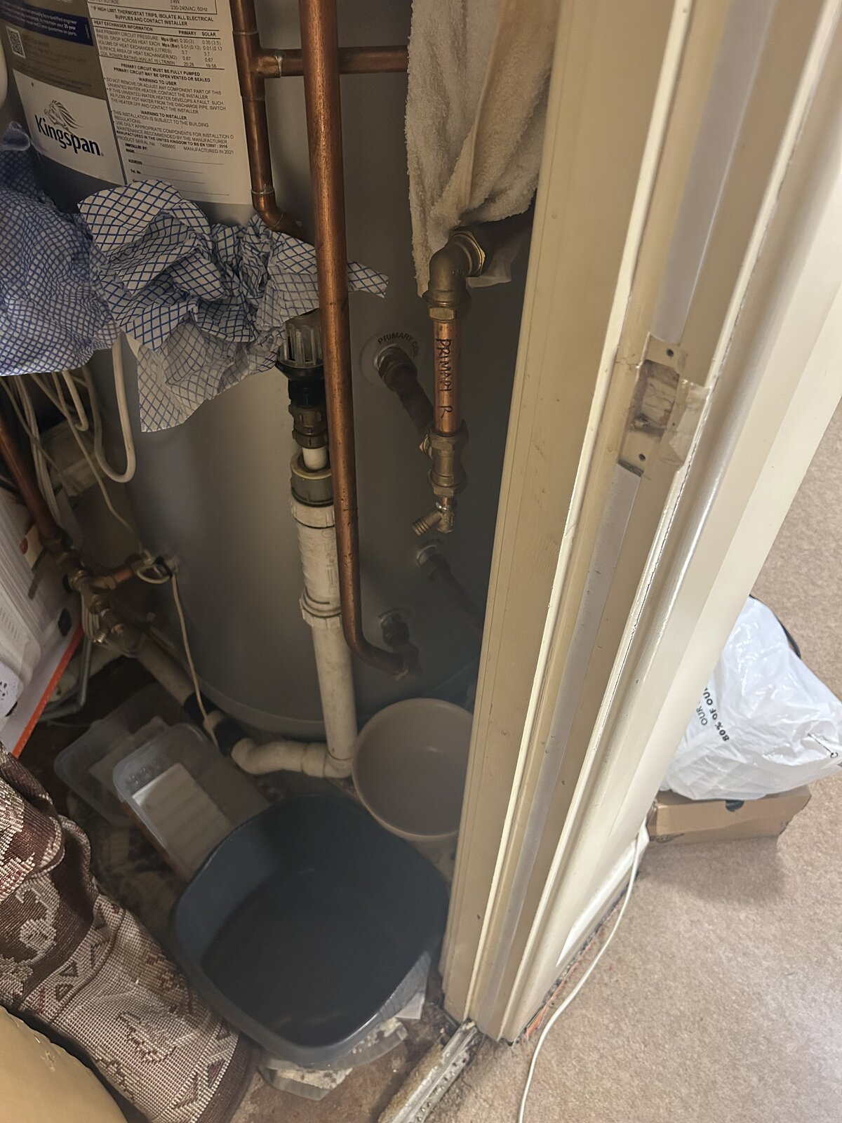

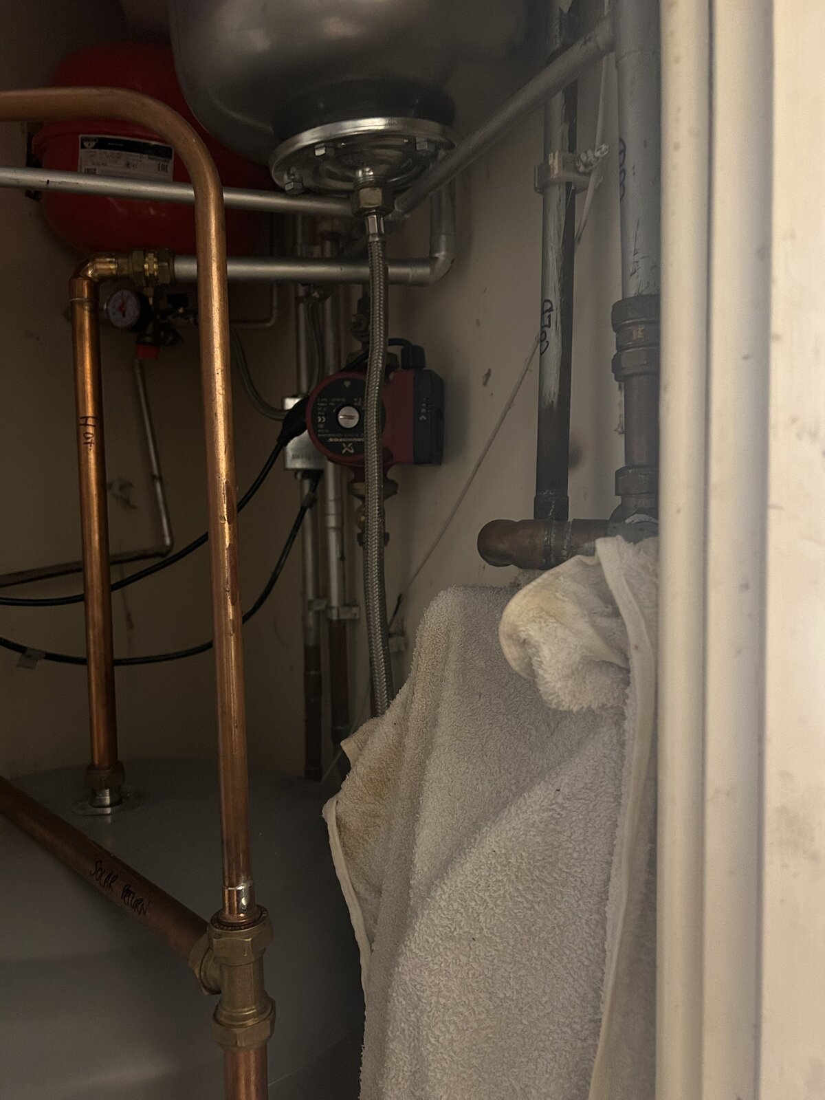

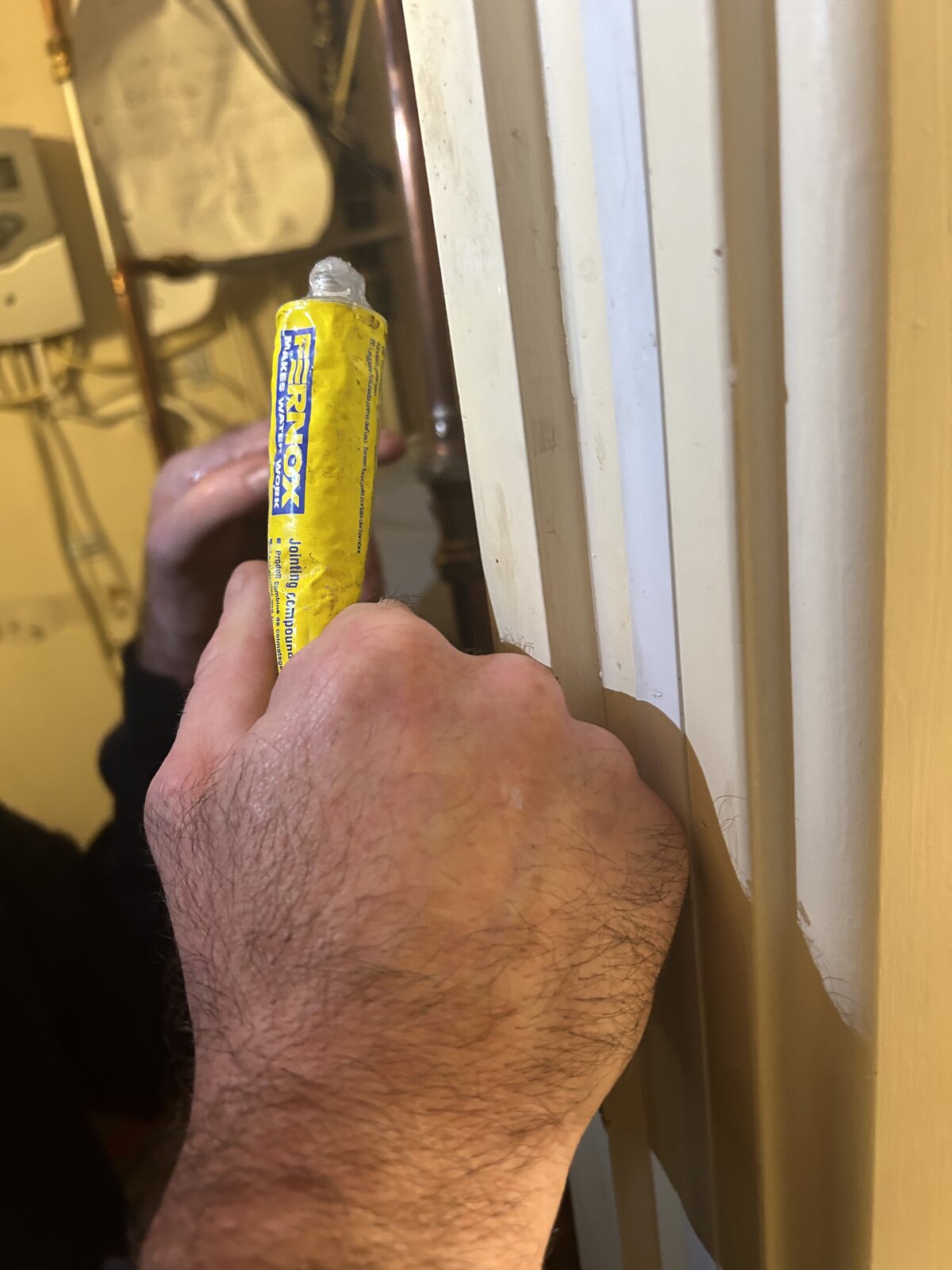

1. The flexi hose on my silver expansion vessel is spraying water . It became worse after a sealant was placed around the leaks on 31.12.24. The water supply is now, turned off.
2. The plumbers have been called back but are still not responding. I’m unhappy.

Happy new year. I was searching for a solution to the leak from the flexi hose, on my silver expansion vessel and found this forum. These threads are helpful to a homeowner. For now, the insurance company has allocated a plumber ‍ but he may comeback on 2.1.25 and not today. Many learning outcomes are relevant because the hose should be checked on a yearly or shorter basis. I’d like the option of a fixed pipe, if possible!! However, no legal disagreement is necessary. I’m just tired but I’m using the stop tap , until the leak is repaired.

Firstly, the flexi pipe wouldn't be checked @ a yearly service unless it was leaking at the time, if it starts to leak then it's just one of those things I'm afraid.
That would usually only be one of 3 things, the nut is loose, the washer inside the connection has burst or the hose itself is burst. It's a pretty easy fix though, the latter 2 both require the HW system to be depressurised. Tighten the nut, replace the rubber washer or replace the hose.
The latter 2 need to be performed by an Unvented qualified professional.
Am sure you can get an emergency plumber but it will cost you!
Perhaps ask insurers if they will cover it?
And, as above, they need G3 qualification for unvented systems.
Madrab : The hose is burst and it is spraying water but I’ve applied the stop cork tap , until water is needed. 2. The signs are that the hose was bent on installation and has now burst. The washer ? Doesn’t seem to be. 3. The matter got worse from 26.12.24 until now, because the allocated plumber has a family need and refused to come on 30.12.24 as promised. 4. On a new thread: Not quite now, since I am new to this topic and online page. Cheers.
