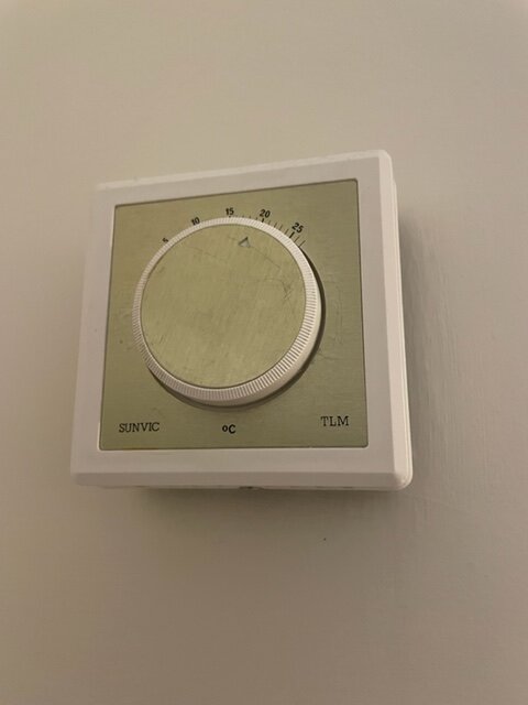

Hi,
I'd like to replace the below with something new and digital. The dial is so insensitive it is impossible to set a temperature, you can tap it (not moving the dial) and it will come on/go off depending on the state it was in. If I set it to 20 degrees I think it actually ranges from 18 to 25 so I'm forever moving it 1/1000th of a mm in either direction.
We knocked down a wall that it was on and it had to be repositioned somewhere less than ideal, kind of now stuck up in a corner.
Ideally I want a remote sensor I can put in the middle of the room and it feed back the actual room temperature to the thermostat. Failing that, just something that is more sensitive/accurate on the dial (or digital).
All this does is turn on ceiling heating. It is not connected to a boiler or anything else. I believe it is 240V so perhaps that limits my choice.

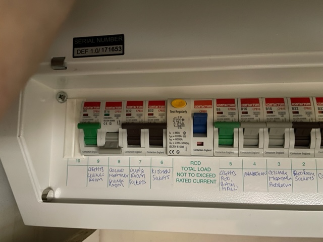

B16 is indeed 16A, [B relates to its sensitivity] and as the thermostat is rated at 20A it would seem likely that it is switching the full load; in which case you would need to find a similarly rated thermostat as a direct replacement. [Most of the thermostats that are usually recommended on here are for systems with boilers and so only need to be rated at a few amps.] Although it might be worth seeing if you can find out the actual current draw of the heater.

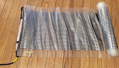

I've done more digging and it is an ESWA system and I suppose the ceiling has these (attached) somewhere above the plasterboard.

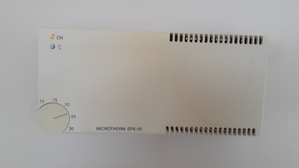

A neighbour has the EFK-20 thermostat (attached), but I can't find one anywhere. And ideally I'd like a smart version or a dumb version with a remote sensor I can place in the room
Stem - I see your comment on this other thread - https://www.diynot.com/diy/threads/eswa-ceiling-heating-thermostat-and-controls.564427/ - those 1/2/3/4/5 thermostats are in my other rooms.
