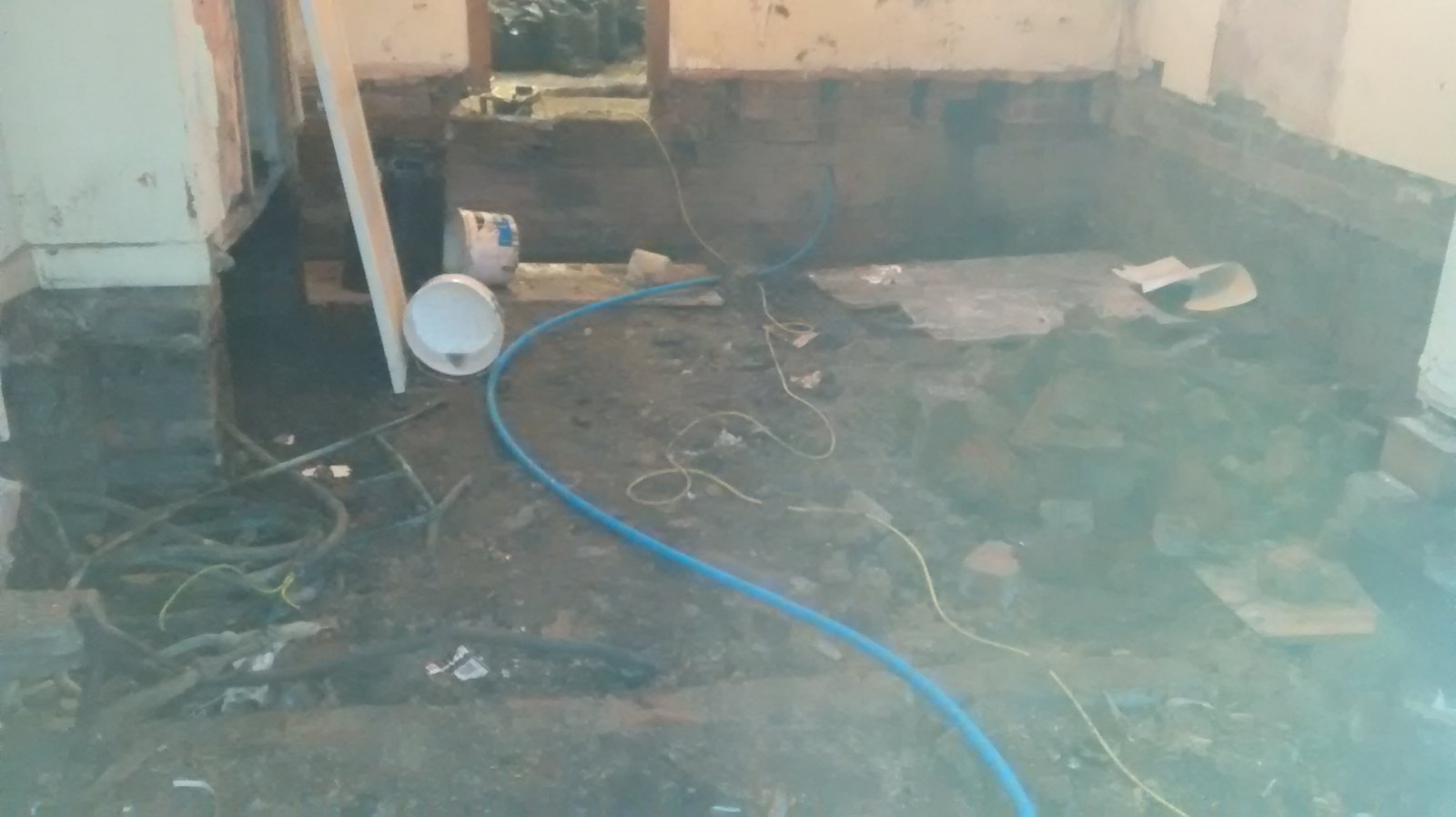

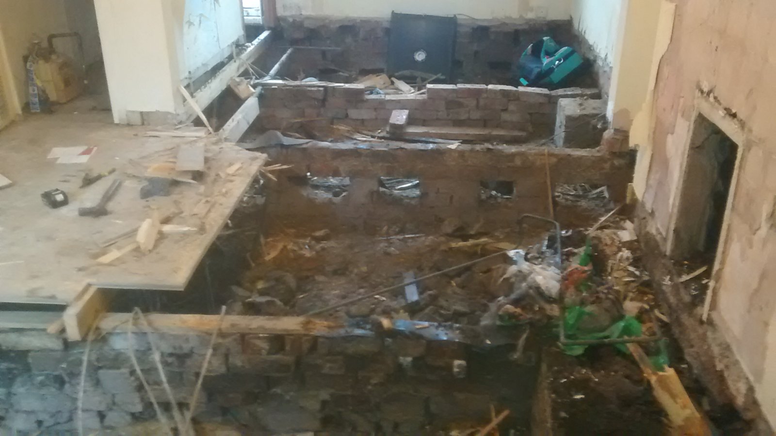

I bought it at auction.. bit last minute dash... it is to be rented.. depth from floor boards is = 630mm Ill check out seconds and co, thanks
Ive attached pic of floor.. sleeper walls have gone now and ive already dug out footings at either end

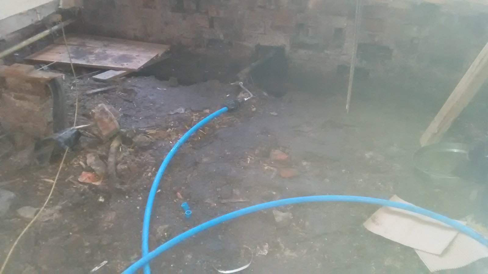

You can just replace a suspended floor with a solid concrete floor. The ground needs to be load bearing. If it isnt then the floor and walls will move separately.
If the ground is good, and is sub soil below your floor you may be ok.
Otherwise, fit a suspended floor.

Now I can see the need for the sleeper walls. The joists normally go across the shortest distance, not the longest. Don't try and get your sleeper wall level to the floor though; as a DIYer, it'll be easier to leave it half inch lower than the underside of the joists, and then pack the joists to get the level you need.
Ive attached here another couple of pics of floor - its all clay so i guess it should be ok to support a concrete floor.
