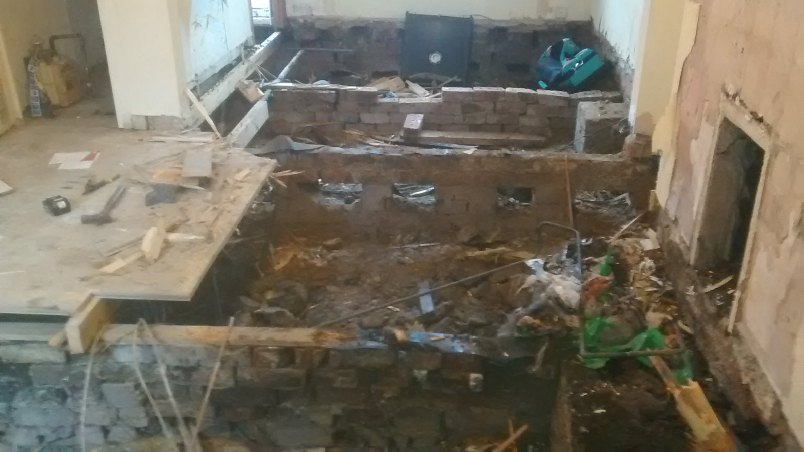

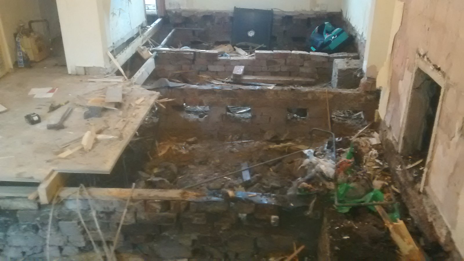

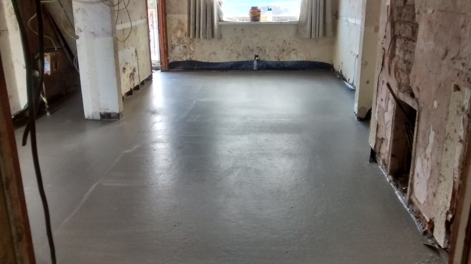

Well finally got my floor down see pics... very happy with result.. :) there is 150mm of type 1 hardcore, around 20mm of sharp sand, dpm, 150mm of insulation, dpm, self leveling concrete.. which is absolutely bang on level..

Great effort legepe.
Just a couple of questions. Did you have to put expansion gaps in atall? And where the dpm is against the wall, do you just bond it to the wall or does it have to be chased into the brickwork???
Its got 25mm upright insulation on all walls, I didnt put expansion gaps.. just made a couple of cuts around 1/3 through concrete so when it cracks hopefully it will crack there... the dpm is only to hold the concrete.. it needs to be taped up properly where necessary... walls are injected with dampsolve
