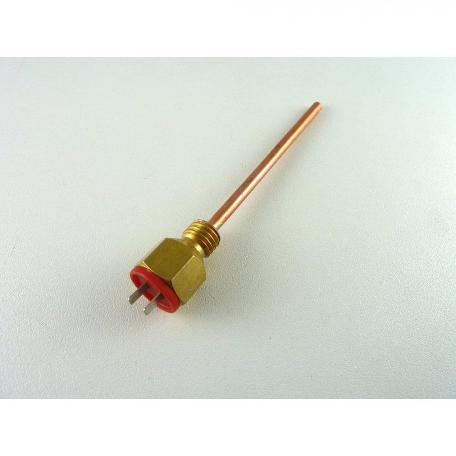

one midas thermostat,they dont make them like that now days.
Several years since I had to repair a Midas.
But I thought that two pumps was quite an interesting solution to a boiler design problem.
Does not seem to have greatly caught on though.
