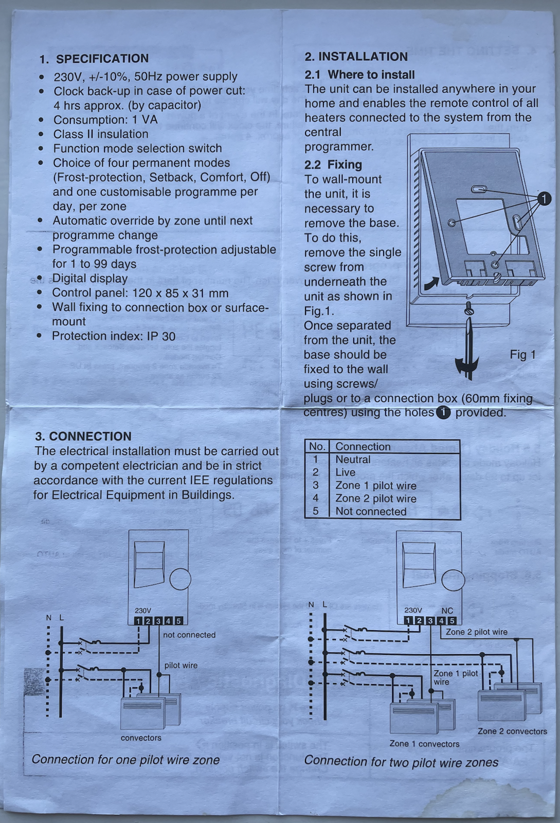

Hello everyone,
I am trying to figure out, with no success, what would be a possible replacement for a Dimplex RX010006 Dual Zone with Pilot Wire programmer (which seems impossible to find as a replacement) and I was hoping someone here could point me in the right direction.
I was looking at a CentaurPlus C17 or C27 but I'm not really sure if any of those would work, plus I'm terrible at this things so an in-place replacement that would require any re-wiring would be the ideal solution.
I've uploaded the schema of my current connections.
Any help would be really appreciated :) Thank you all!

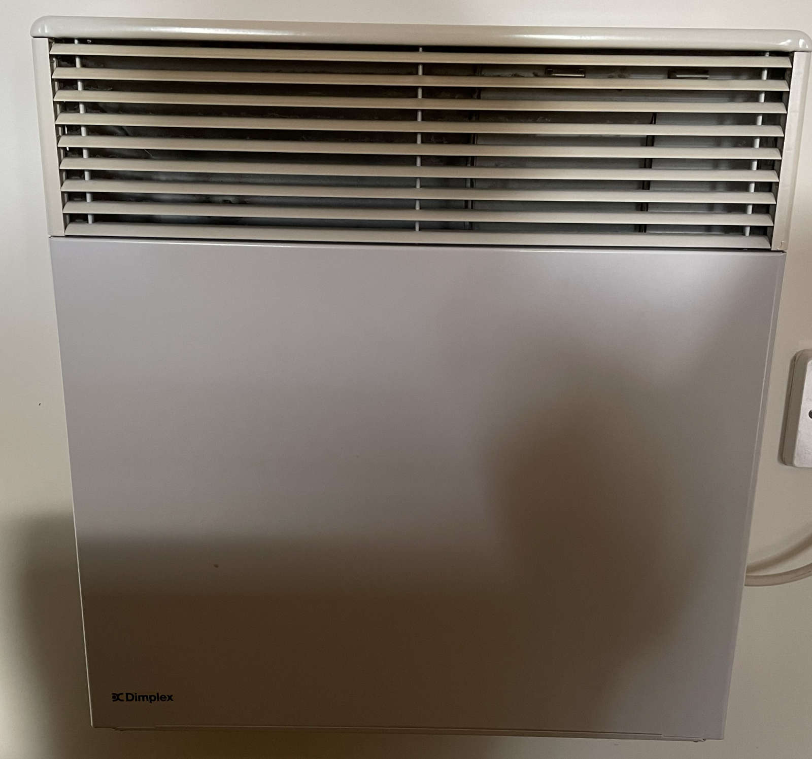

These are the panels:

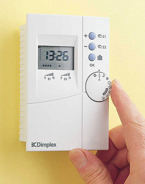

And this is the RX010006 that was on the wall and I'm trying to replace:
Chris I think that's the pilot wire interface what I'm trying to replace is the programmer that switches on and off the heaters on timer depending on the day.

OK with the C17 couldnt be easier
L&N from existing to L&N on the C17
Make a link between L & 2 (com) on the C17
Put both pilot wires into 4 (on) on the C 17 job done as simple as that

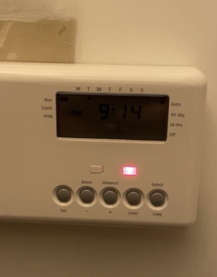

Hi Ian, the C17 arrived and it's all up and running thanks to you :)
The only difference was the 2 pilot wires for some reason had to go on the 3rd channel instead of the 4th.
When they were on the 4th the on/off would be inverted, so when the heaters were supposed to be off program-wise they would be on and vice versa.
Also, and this could be me wrongly remembering how the old Dimplex programmer used to work, when I set them to off from the programmer the heaters will go in night mode instead of turning off, as I said this is probably how they worked with the old programmer as well.
Just wanted to say a MASSIVE thank you for all the help and support you have given me, I wouldn't have a brand new programmer installed without you :)
