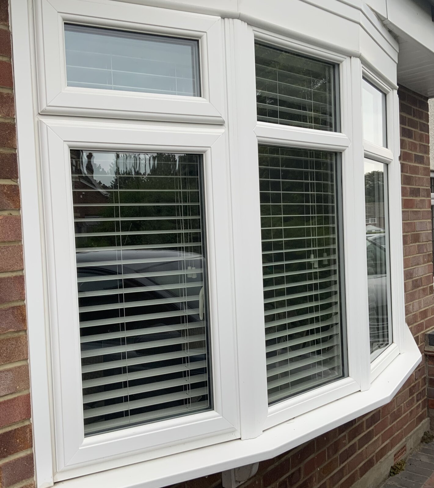

I think ours are still in good Nick for something 20 years old.
We do have one at the back of the house - one of the two small upper opening windows on the kitchen window that is slightly older that gets condensation in it and because of that she thinks the whole lot should be changed……
they look much more modern then mine!

@Mottie they look in pretty good condition to me , just get the unit changed out the back lol
