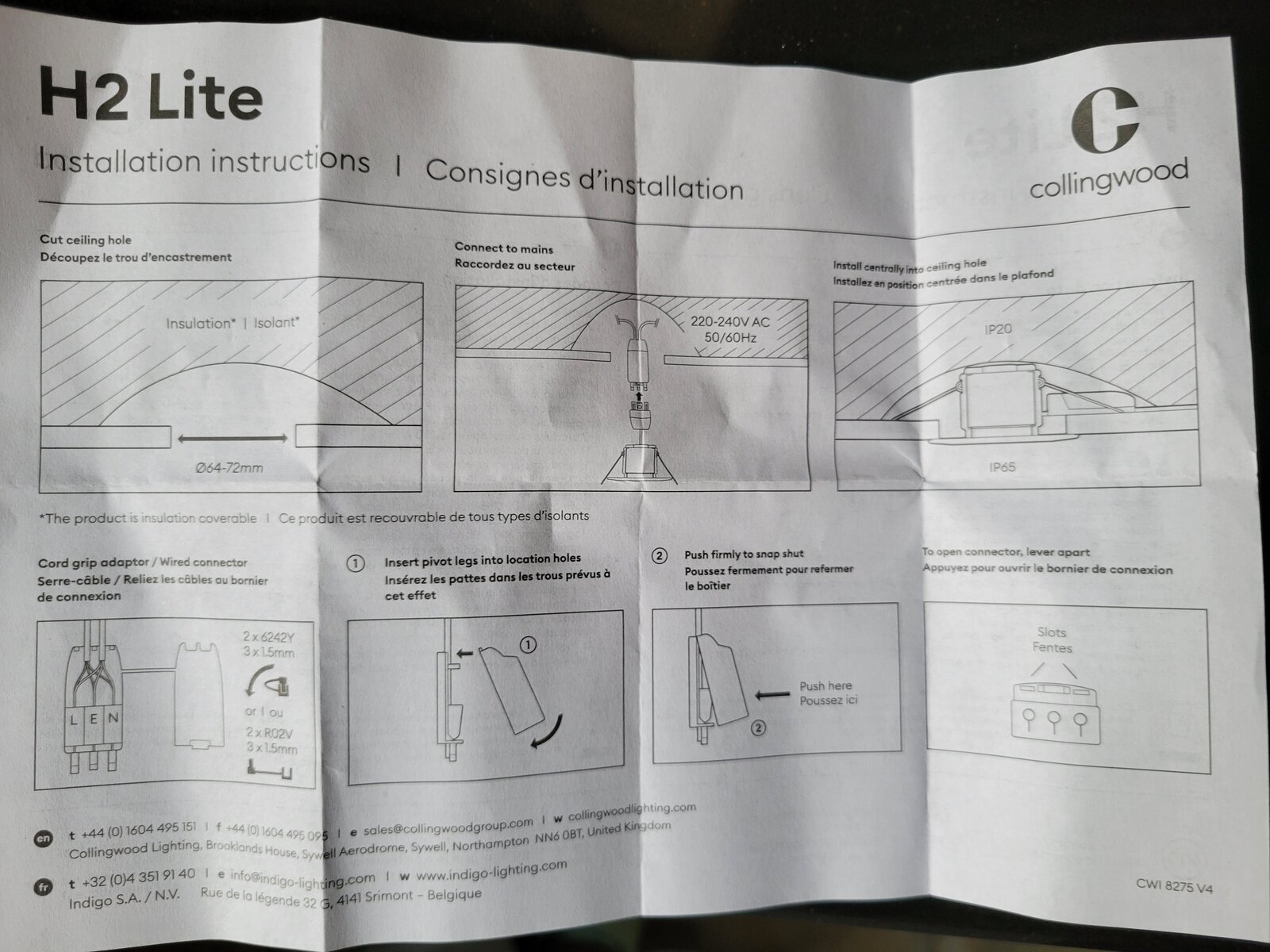

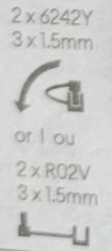

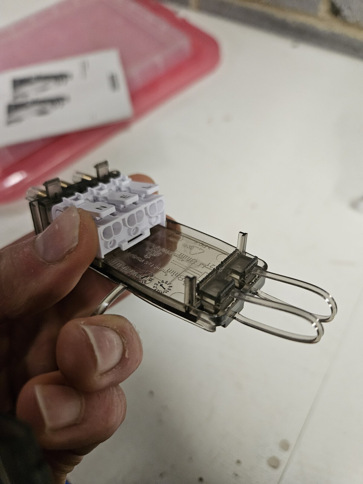

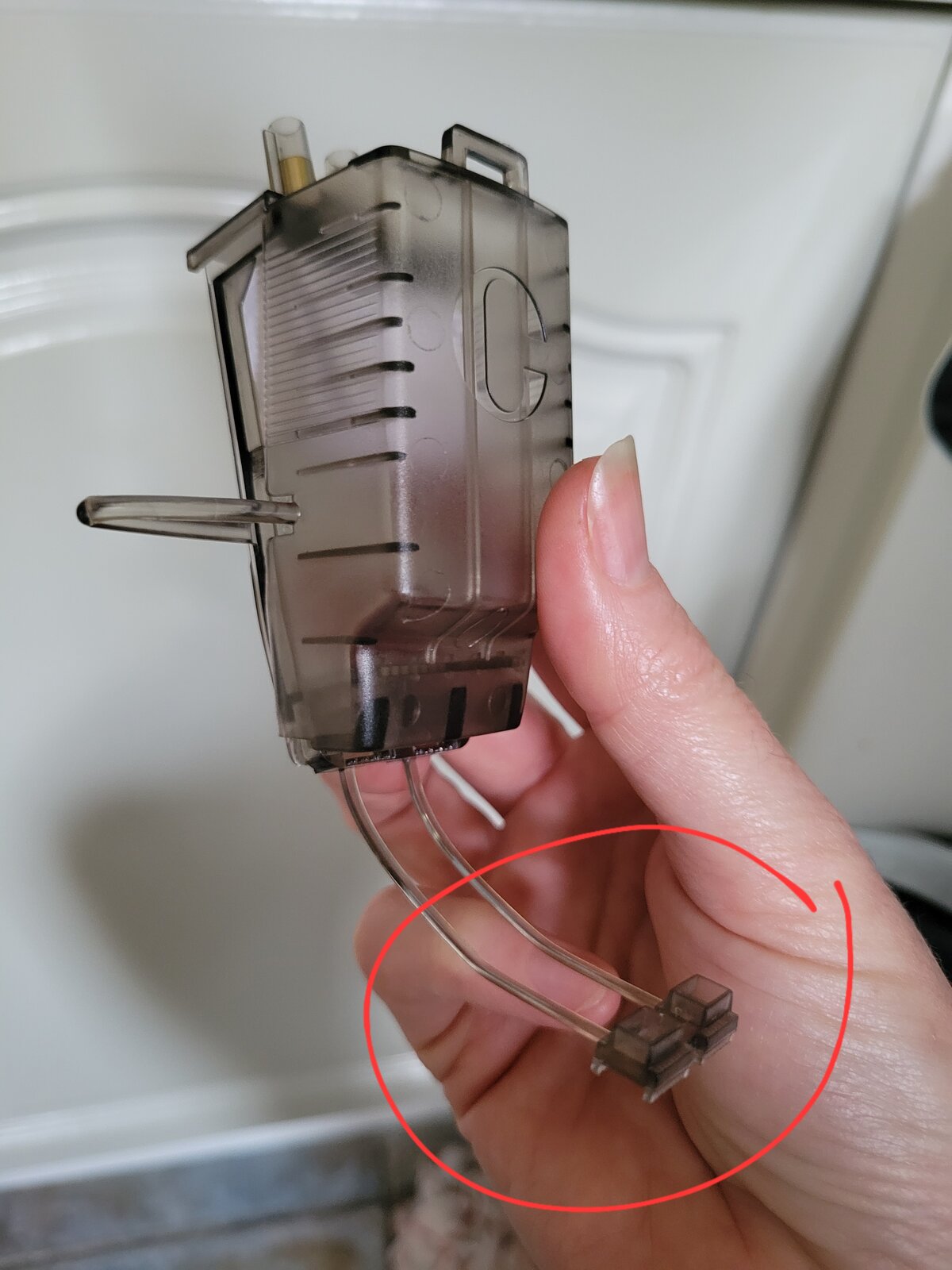

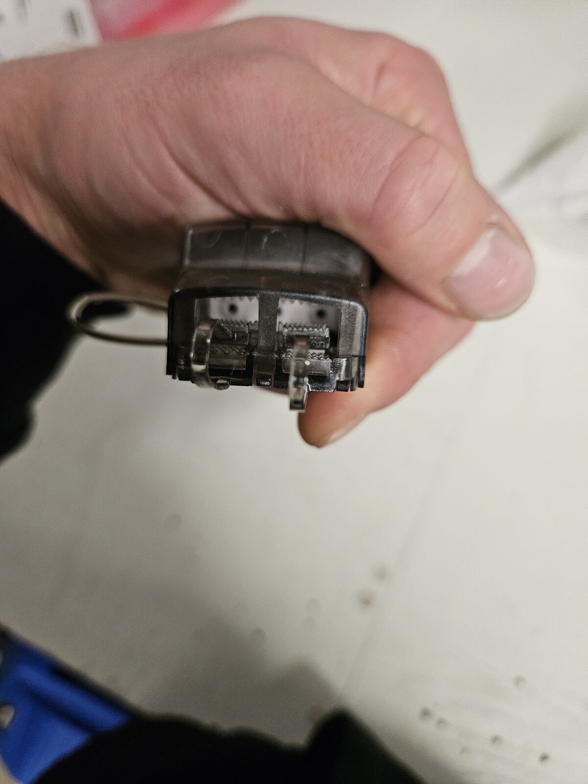

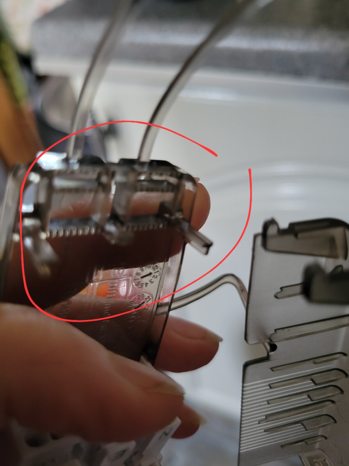

I'm replacing the bathroom downlights with Collingwood H2 Lite leds. It's a pretty straightforward swap, but can anyone tell me what these bits are for?

They're part of the cable grip assembly you do need to put them in for t&e so it's gripped properly
This is how it should look, in the second pic you can see the gap with the cover on is about right to grip a bit of t&e, without those extra bits in place it won't grip properly
