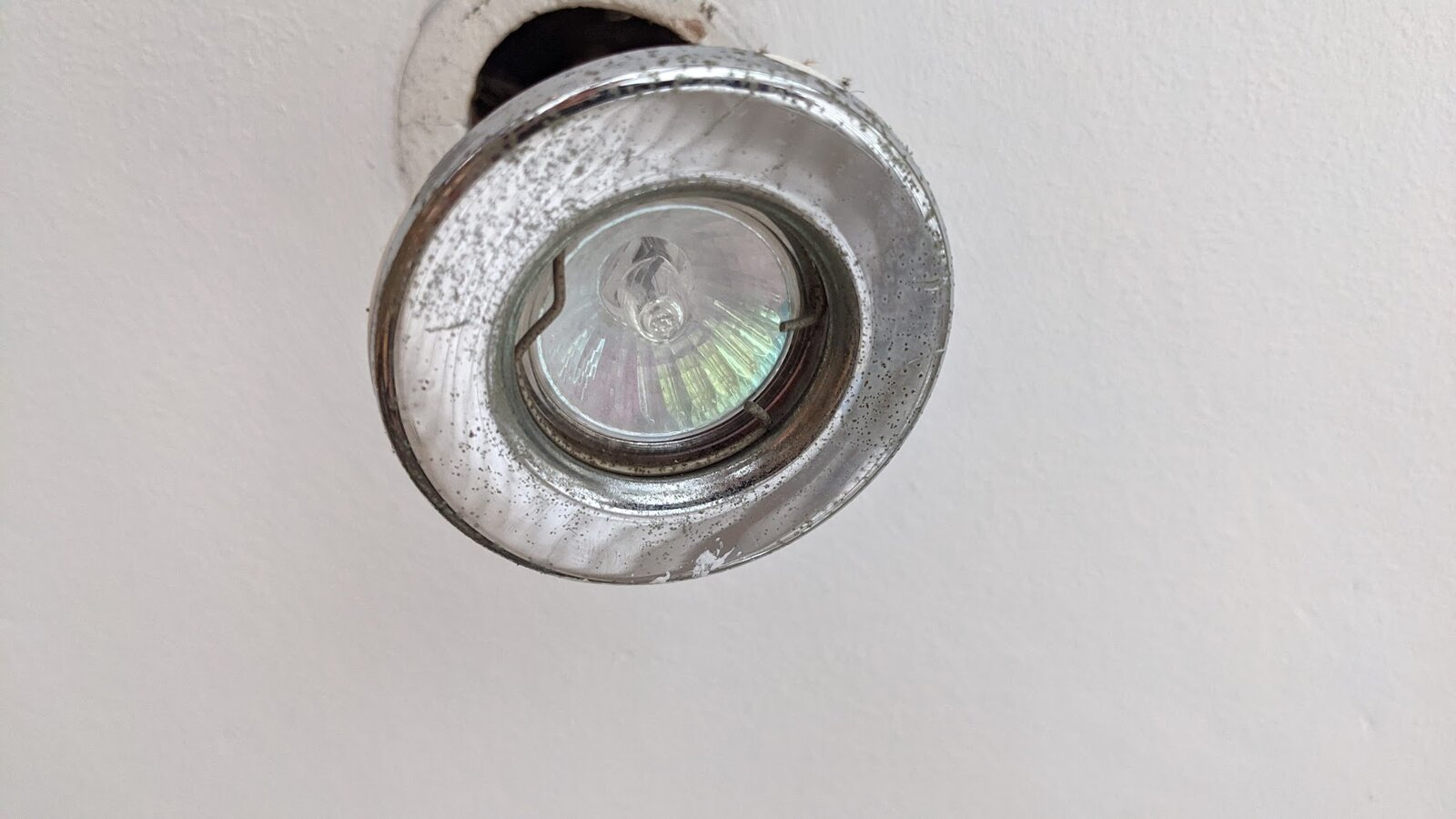

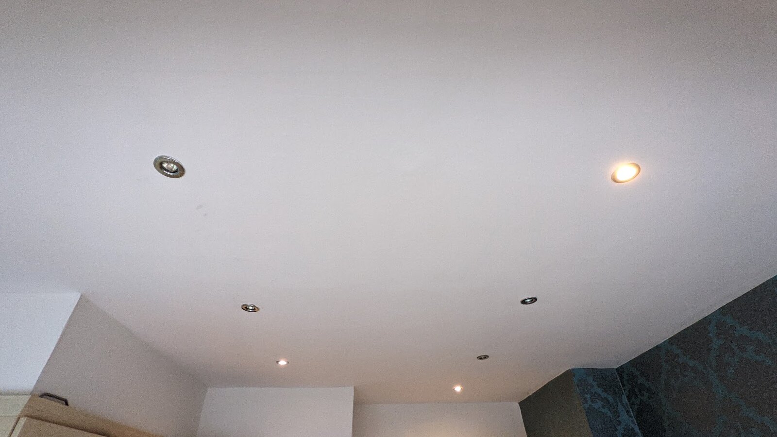

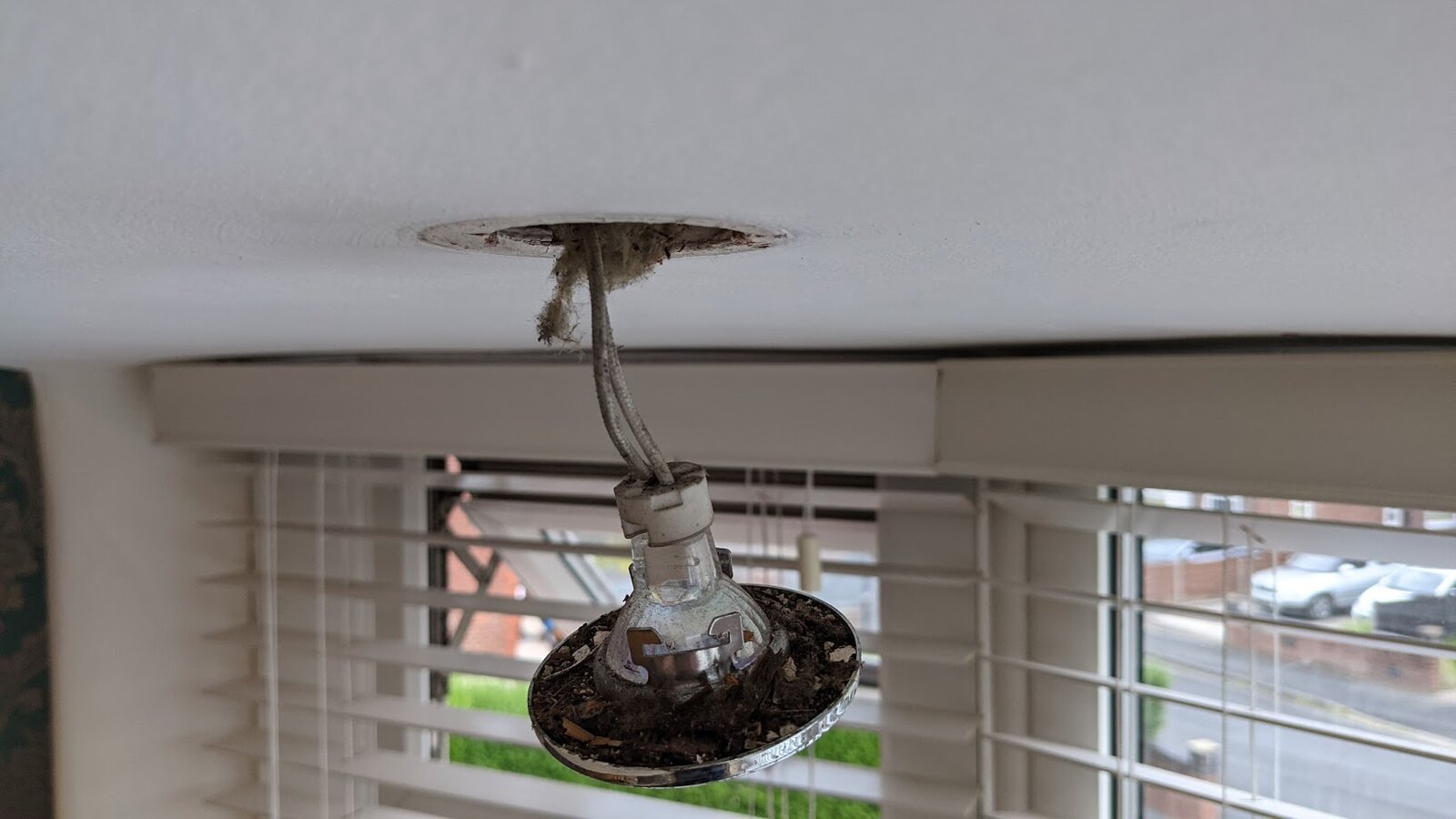

Just moved in to a house where a previous occupier has gone a bit mad with spotlights. There's lots of them in every room. Room by room they are all different types colours and sizes and they all look dated, paint splattered and have halogen bulbs.
I'm looking to start with replacing the lights in the master bedroom. These ones are quite small and there's 10 of them altogether, all on one switch and only about 4 of them working. The hole diameter for these is about 45mm.
Is it a DIY job to replace these? Is there anything that will fit in the existing holes or will I need to make it bigger?
The centre picture shows an extra low voltage unit, likely 12 volt, the problem is these can be supplied from a toroidal lighting transformer in which case you can simply plug in a LED bulb, or an electronic transformer which often have a minimum output.
Typical 20 - 60 VA is marked on the electronic transformer so LED lamps will not work.
The rules changed in 1966 and now even where the lamp is class II you need an earth wire taking to the lamp with 230 volt lamps, but the extra low voltage lamp rarely had an earth wire, so it may involve more than simply changing the lamps for 230 volt versions.
In the main the change can be a DIY job, but it is down to finding the transformer and re-wiring as low voltage (230 volt) and also deciding what you want to replace them with, filling in loads of 2" holes is not a quick job, so often even if a large centre lamp is fitted using GU10 fittings to fill the holes is easier than filling them all.

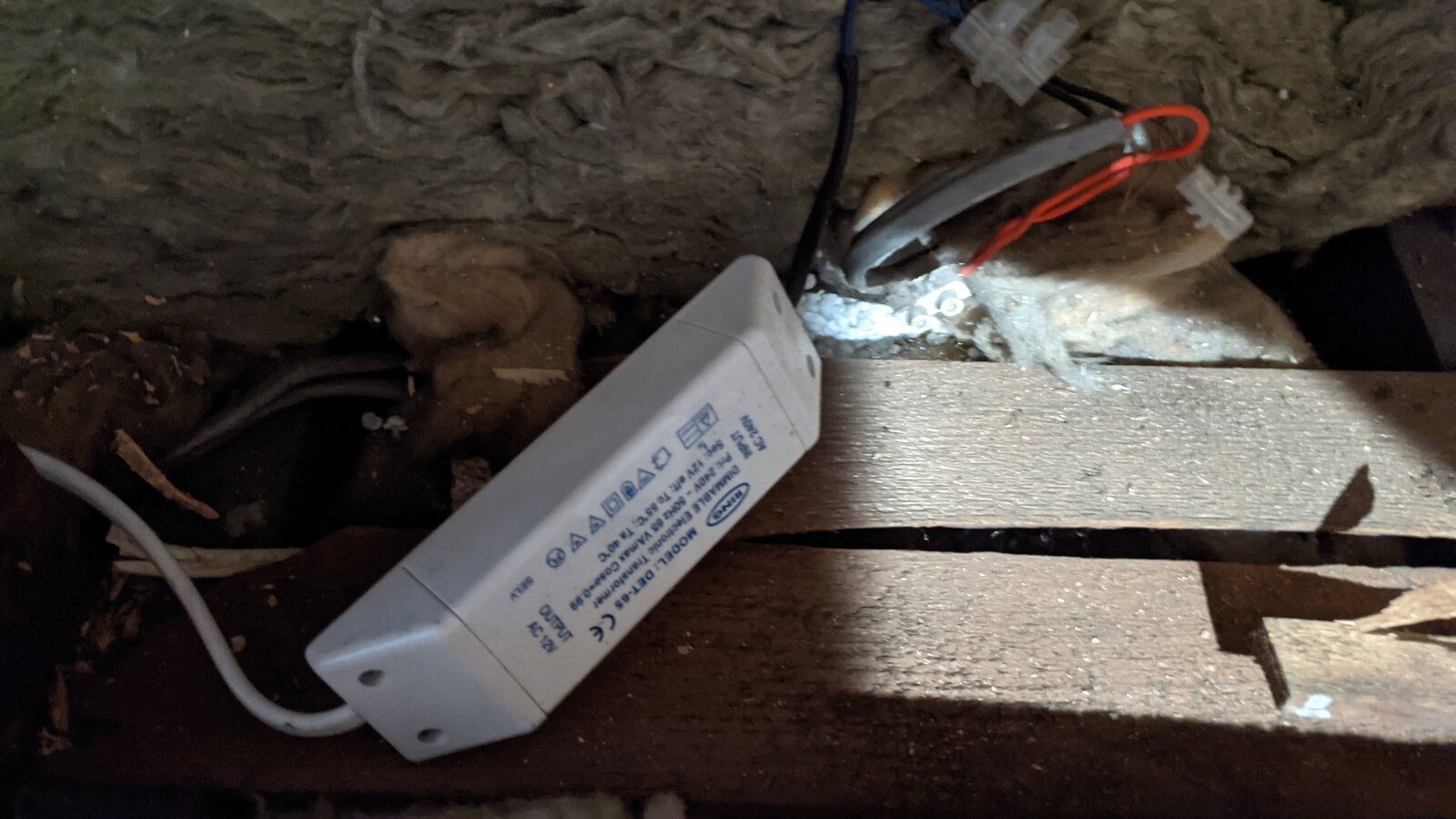

Thanks for the reply. I've just been up to the loft and I can see at least 3 transformers before lifting any insulation. I'm not sure if this helps at all but I've attached a pic. Not sure where to go from here.PXL_20210611_150113977.jpg
That is a switch mode power supply for halogen lights, will not work with LEDs. Remove it (them) and use 240v LED fittings.
Thanks very much. There's 3 rooms with spotlights on this floor so does that explain the 3 transformers?
Aside from picking new LED fittings and making the holes bigger to suit how would I go about installing? Can I do 10 lights from 1 single switch and is the insulation on top of them going to cause issues?

Switch mode halogen supplies, not transformers. There may be one for each room but most likely one per light. You need to search for others.
Yes.
Switch Mode Power Supplies (SMPS), which are transforming (changing) 240 V (50 Hz) into 12 V - at who knows how many Hertz.
(No halogen [gas] is supplied by any such devices!)
into 12 V - at who know how many Hertz.
and with a wave form that could be anything. 12 V DC (eff) means a supply that has the same effect as smooth 12 V when fed to an incandescent lamp.
Worst 12 V DC supply unit I have come across had a waveform with 30 V peaks at several kHz but it averaged out to be 12 V
Incandescent lamps would be OK with the 30 V peaks but the LED elements in an LED lamp with resistors as current control would be over currented and their life would be shortened.
