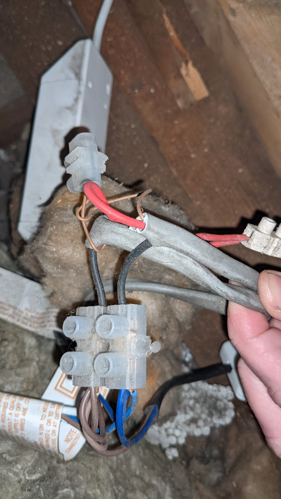

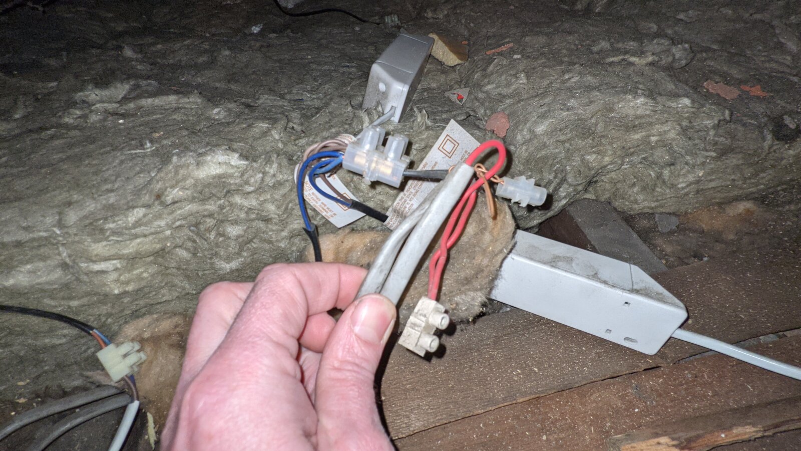

Down to two lights working now so planning to get this sorted pretty soon.
I've been up to the loft again and there's 3 transformers each powering 3 downlights.
What's confusing me now is that there's 2 twin and earth feeding a choc block which outputs PXL_20210625_181217017.jpg PXL_20210625_181217017.jpg live and neutral to the 3 transformers. The two live cables coming in go off to a separate choc block and end there, as do the earths. Then the two black neutral cables feed the choc block for the transformers.
Can anyone explain what's going on here? Has the electrician just used whatever colours he felt like? The light switch has a blue sleeve over the earth as well.

The 2 black cables are not both neutrals. Cables don’t know what colour they are. (For the pendants I know black is not a colour). One of them is a switched live.
I'm just confused as to why the switched live would end up being black. Isn't that bad practice?
Do I just leave it as it is?
Final question - are the choc blocks OK or should I replace with a modern connector?
Cheers
Normal twin and earth cable has one core in the live color (red on older cable, brown on newer cable) and one core in the neutral color (black on older cable, blue on newer cable).
When normal twin and earth cable is used for a switch drop (which has a permanent live and a switched live but no neutral), sleeving (red on older installs, brown on newer) should be used to mark the switched live conductor as such, but this is often omitted by lazy installers.
Terminal block is ok if it's inside a suitable enclosure and is accessible for inspection. It is not fine to have it just floating free like that.

I personally think that using black or blue for switched live is silly, but that is the way it is. In some countries, France is one, switched lives are orange, and violet if there is a second one as in two way switching. But they always use singles in conduit rather than twin and earth.

Can I just ask what is the best way to take earth from this set up to the first light?
