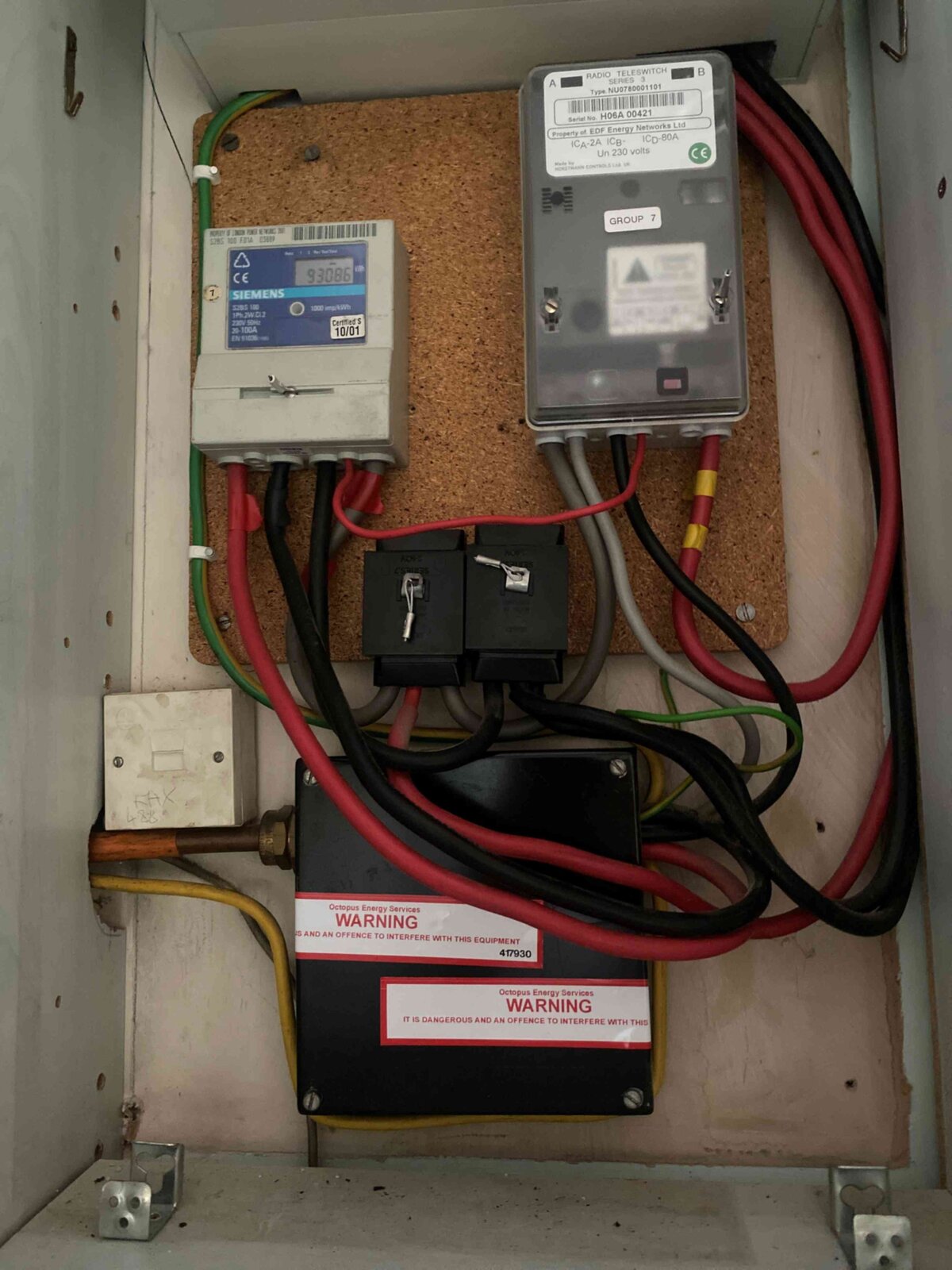

Hi
In a small block of flats our tenants need the teleswitch and meter replacing as they're on storage heaters and the teleswitch service will be discontinued soon, so their only option would seem to be a smart meter to replace both items. I would have preferred them to get a dual tariff non-smart digital meter but I guess that'll be a hard thing for them to argue out with their electrical supplier.

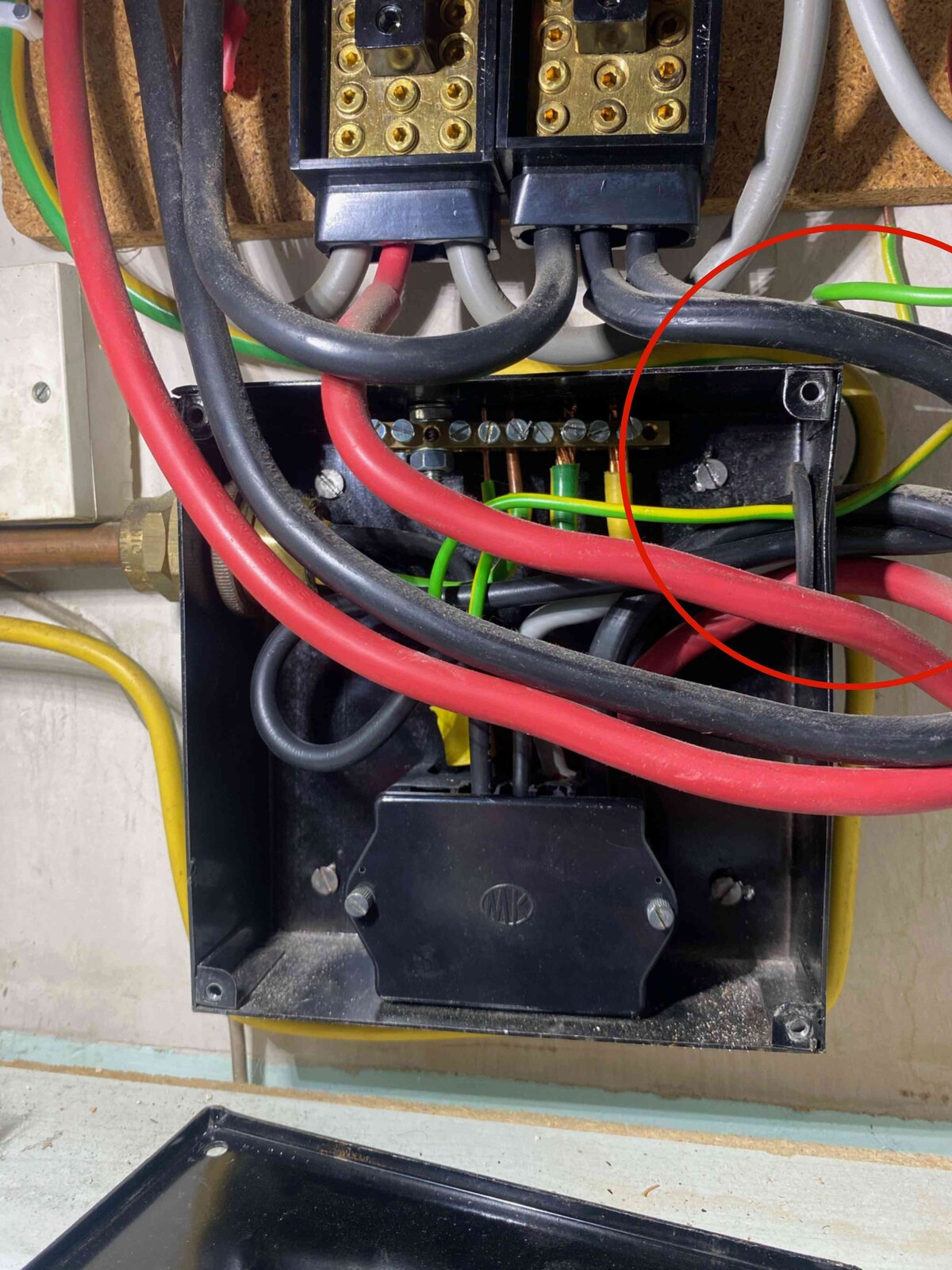

When arriving to install the smart meter, Octopus have said there's damage to the large cast box at the bottom where the supply comes in (top right corner is cracked - shown in picture). So I asked UK Power to come and replace it but they say it's not their responsibility. (Octopus have put warning tape on the box but are also not claiming responsibility of the item). The building management company are passing the buck too and suggesting I need a regular electrician to replace that box. (I would just tap the corner back in with a hammer, but I can't expect the tenants to do that!).
The cut-out fuse is in a cabinet outside, which also has the fuses for several other flats. I read that it's the "BNO" - Building Network Operator who should be the one to replace the box. Does that sound right? and who on earth are the BNO and who should be the one that makes contact with them?
Also, why the copper pipe coming in? has someone used 10/15mm copper pipe as conduit?

In such cases IIRC the DNO is responsible up to the incoming head in the block. The supplier is responsible for the meter
So it’s a cost to be taken by the free holder IMHO - I would confirm with the management company that they will pay if you arrange
It’s not copper pipe - it’s MICC cable

It seems odd, there is no seal on the box before the meter, an electrician can't change it, not allowed to touch stuff before the meter.
Seem to remember @flameport explaining who does this, maybe he can help you.
Thanks guys. I was slightly wrong about the box being cast, I believe it's folded steel and the issue is where the tails exit that the side is bent in slightly causing the corner joint to separate. I honestly don't know why Octopus smart meter people think that's a problem - unless there's a gaping hole that I cannot see in the photo greater than 12.5mm for the test finger? (I might be completely wrong on that assumption as 12.5mm seems way too big and I thought the enclosure protection regs were intended to safeguard against kids poking paperclips etc inside electrical items - and in which case entry by the grommet would be easier).
Technically that's correct, however they probably don't exist.
When it was installed decades ago it would have all been the electricity board for the area, but today it's all been separated out, and the mythical BNO for the parts between the incoming supply and the meter simply doesn't exist in many cases.
It will ultimately end up with the building owner, but they may have no knowledge or info about it, and are probably unaware it's anything to do with them.
Some DNOs will still help with replacement of such equipment, but that is evidently not the case here.
Octopus or any other metering company certainly will be of no help at all, as none of it is their responsibility and never was.
The real problem is that there is no local cutout to isolate the supply while they replace the meter. The slightly damaged box is an easy excuse to use.
Mineral insulated cable as already stated in reply #2, and it's very fortunate that it's been done like that - cable is probably good for 100 years or more and almost certainly will not need to be replaced now or ever.
Remedial work there would be to remove the painted steel box and the phenolic connector block inside it, and replace with a new steel enclosure or trunking with connectors inside, existing MICC cable gland retained and fixed into the new enclosure, then add a red link cutout to the right side, leaving the space above for whatever metering equipment is required.
Appears to be a separate earth conductor with it, or that may be bonding, either way all would need to be checked and replaced/repaired if necessary.
If there are other flats with the same arrangement they should all be done at the same time.
Paid via the building owner/management co, and recharged to the individual apartments as part of the annual service/maintenance charges.
The plastic phone socket also needs to go, and should never have been put in there at all.

AFAIC this is just a miserable excuse by an incompetent meter installer.
