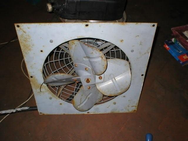

taking the blades off and reversing them does absolutely nothing, they still slope the same way whichever way you put them on....

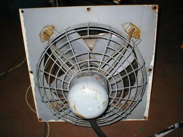

as it's a plate fan, it's flat on one side so mounting it the other way means the fan part has to go into the hole..

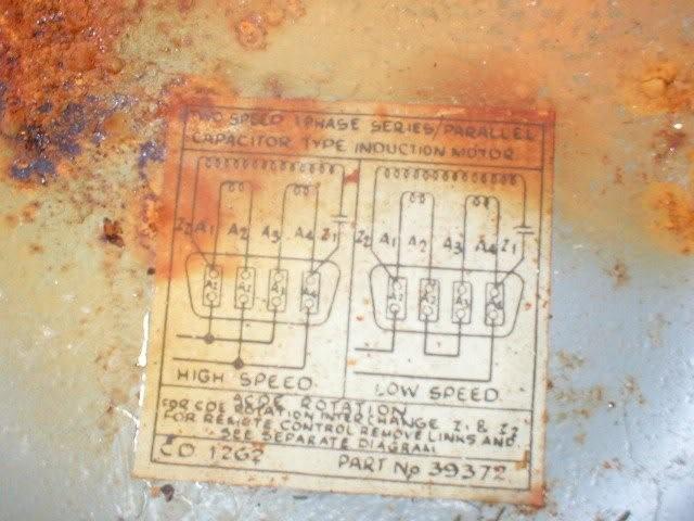

in general you have 2 coils, one U1 - U2, the other Z1 - Z2.
for clockwise rotation it's usually wired with U1 and Z2 together ( sometimes labled as U/Z ) with U2 and Z1 linked through a capacitor.
to reverse you change it so that U1 and Z1 are linked with the capacitor, and U2 and Z2 are together in U/Z..
or at least that should be it.. you may have to swap Z1 and Z2 round in the second one to get it to work right..

depending on the type of woods fan you can change the pitch of the blades if they are metal.. alen key time..
obviously you can't do that if they are a one piece plastic moulded blade..
Thanks guys, I have managed to get some pics and a diagram. Any help and info on this fan appreciated. I need it as an extractor for 2k paint.

As ColJack said, swap round Z1 and Z2, just like it says on the note on the label in the picture you posted.
