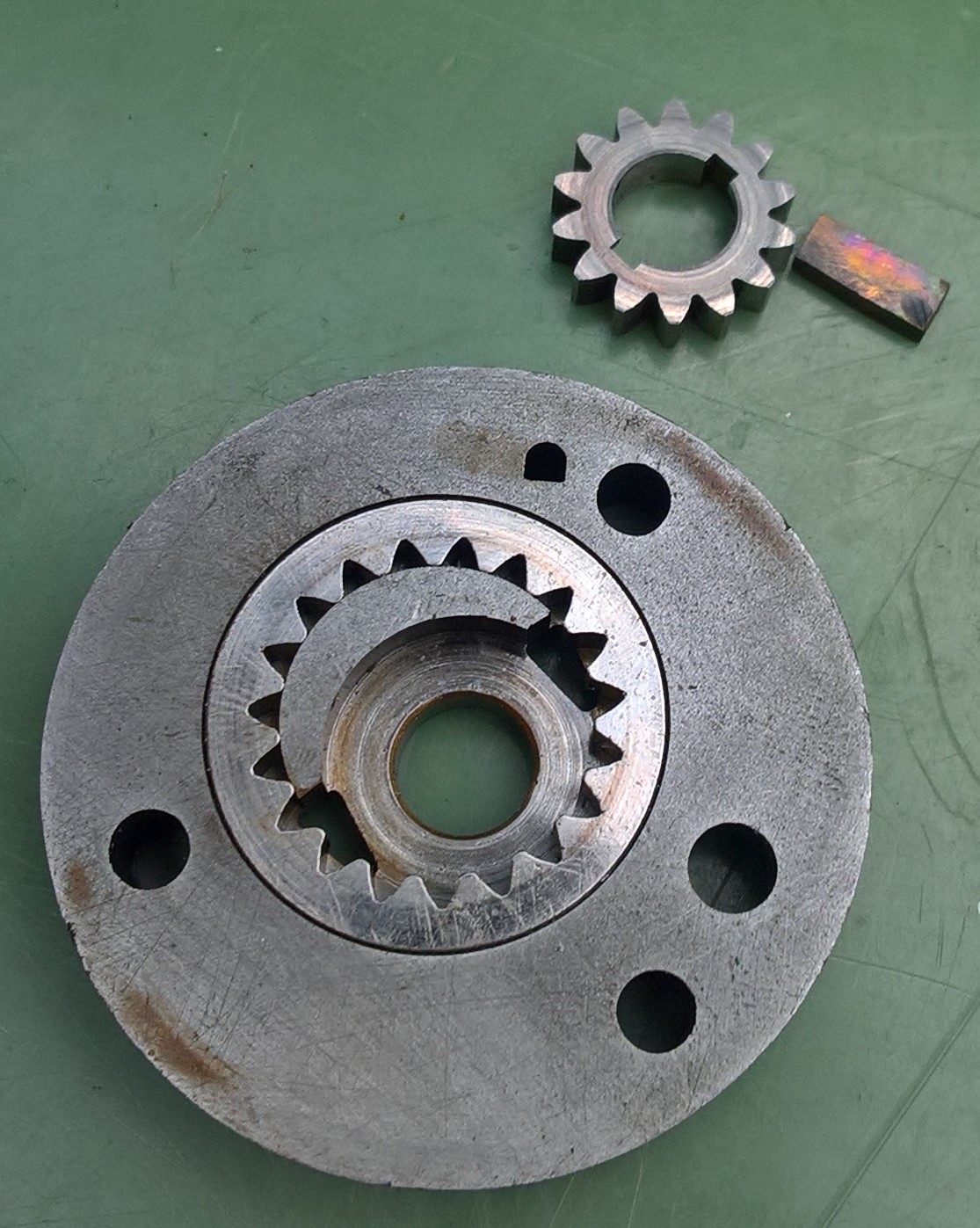

Riello F40 G7Q regularly maintained, flamed out in use, subsequently locking out. Extracted burner from boiler and switched ON. At ignition point (t+12s), sparking well but no fuel spray. LP fuel feed confirmed good. Diagnosed HP fuel pump to replace but this is Sunday, no parts available. Stripped pump down. Found drive gear key compromised resulting in shaft spinning freely. Signs of fair wear and tear but otherwise serviceable in the short term. Filed and hardened a new key (pictured), reassembled everything. Worked first time.
However.... after a normal thermo-shutdown, motor refused to restart with evident current noise (as reported many times above). Turning the fan by hand it seemed there was some kind of "stiff spot" and if the motor happened to stop in the wrong place, it simply lacked the torque to restart. This pump and coupling will be replaced tomorrow so I was going to let it rest, then I found this thread and followed the instructions. Hey presto! What I learned from this:
Always change the nylon coupling whenever you've had the pump off.
When tightening the pump fixing screws make sure that everything is aligned and runs freely.
Do the final tightening with the motor running, one flat at a time. Don't overtighten.
