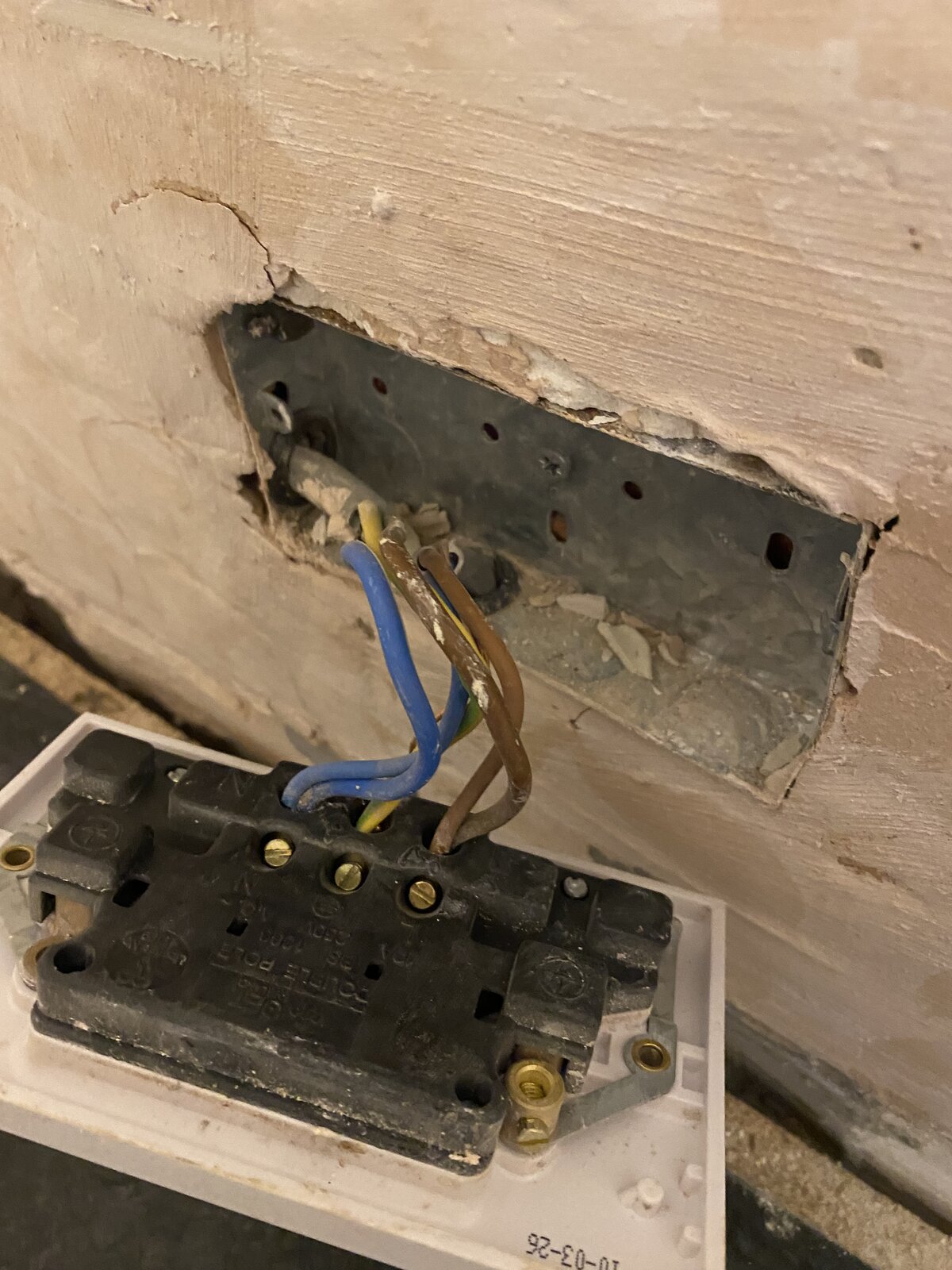

1737285160146.jpeg With power off, removing the two brown wires, there should be continuity between them. The same applies to the blue wires. And the two earth wires, if no continuity, likely it is a radial. It could also be a donor socket for a spur, but unlikely.

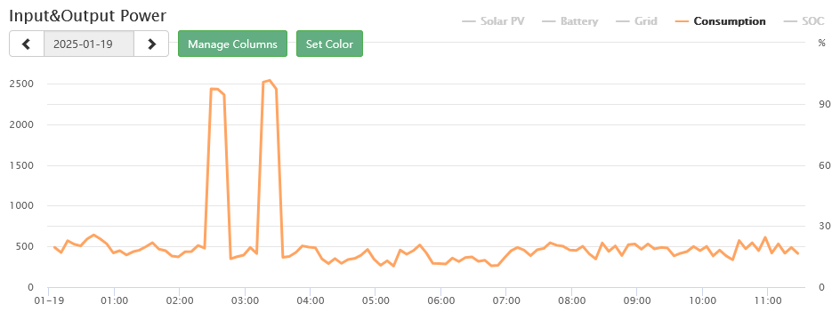

My house generates a display of the power used, 1737286325304.png and other than when having a shower, or recharging batteries the power used rarely exceeds 4 kW, so if all my B32 RCBO's were changed to B20 RCBO's it is unlikely they would ever trip. That would seem to be the easy way forward.

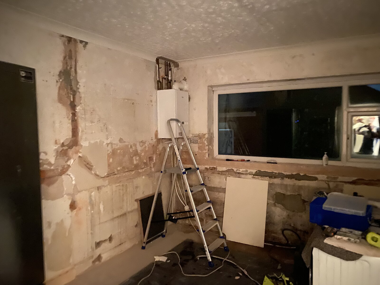

Not doing a photo of that now. I’ve removed all of the wiring in the kitchen and will get a fresh ring installed. It seems to have been a radial with some sort of ring tied into it. There’s definitely only a single cable going into all of the socket circuits. Three socket circuits and multi core cable going into them so I’m guessing they are 4mm2 radial circuits as opposed to my assumption that I had three ring circuits. What period do radial circuits come from? How is a householder supposed to know what he has got?

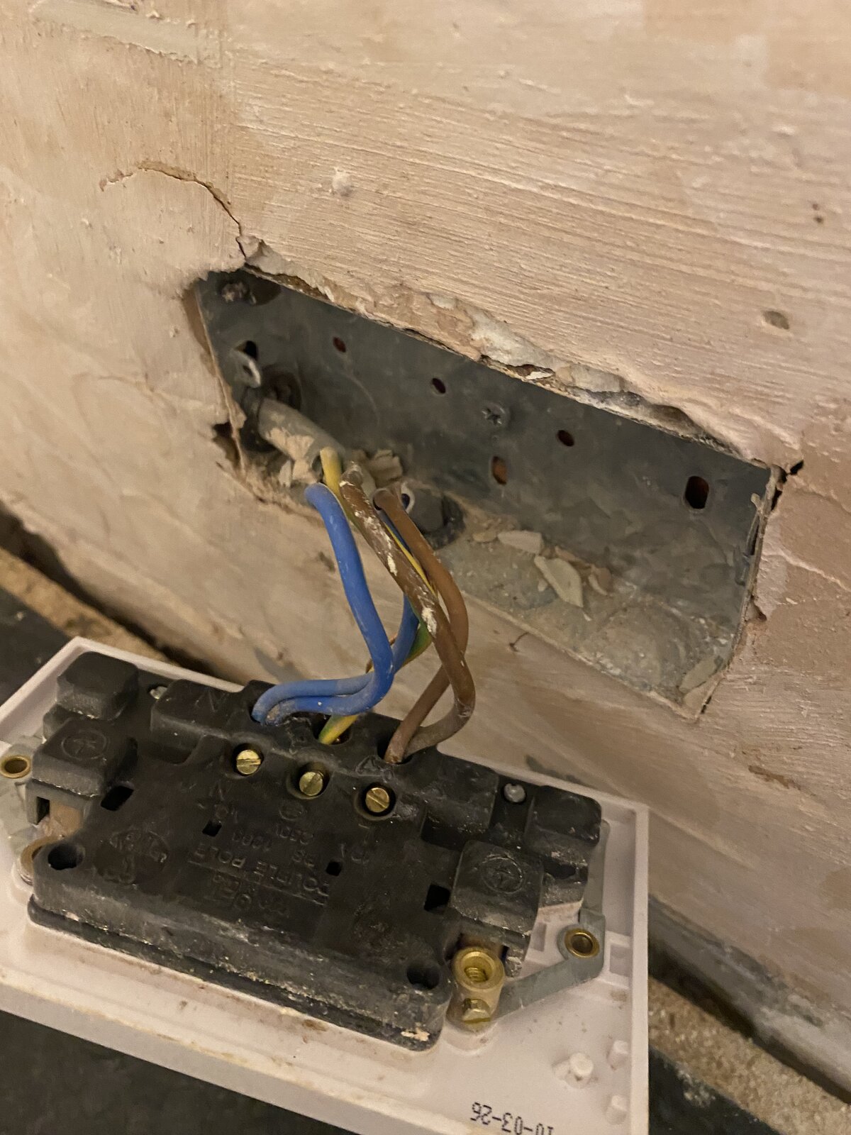

View attachment 369810 With power off, removing the two brown wires, there should be continuity between them. The same applies to the blue wires. And the two earth wires, if no continuity, likely it is a radial. It could also be a donor socket for a spur, but unlikely.

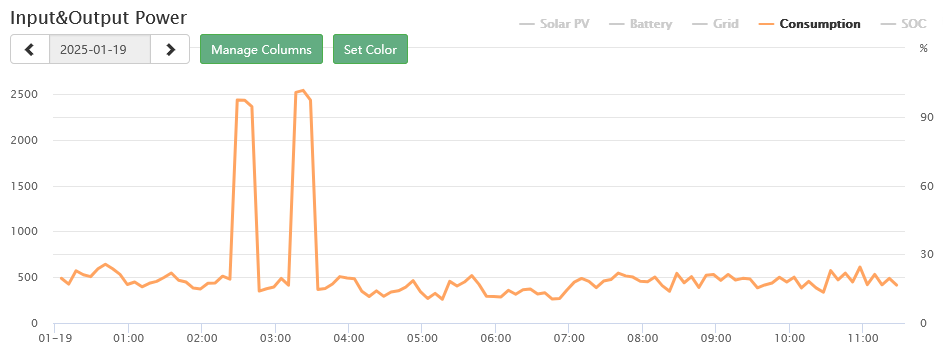

My house generates a display of the power used, View attachment 369820 and other than when having a shower, or recharging batteries the power used rarely exceeds 4 kW, so if all my B32 RCBO's were changed to B20 RCBO's it is unlikely they would ever trip. That would seem to be the easy way forward.

Nothing wrong with a 4mm radial. Ideal for a kitchen.
2.5mm cable for ring could be cheaper
Really 4mm radial? What would the average electrician install? I know the rational behind our UK ring circuits but I believed that was the required standard. So I can leave my other circuits which I believe are radial? That makes things a bit simpler. As my feed to the kitchen is a 4mm I could just have it wired as a radial. In 4mm obviously.
Some sparks are stuck in their habitual ways,quite a lot in my experience actually, and still fit ring final circuits. The younger ones not so much and fit radials .
They will install what is sensible hopefully.
We are keen to see a pic of the CU and neutral wires to see if it’s safe.
