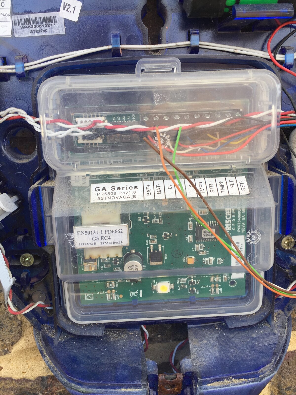

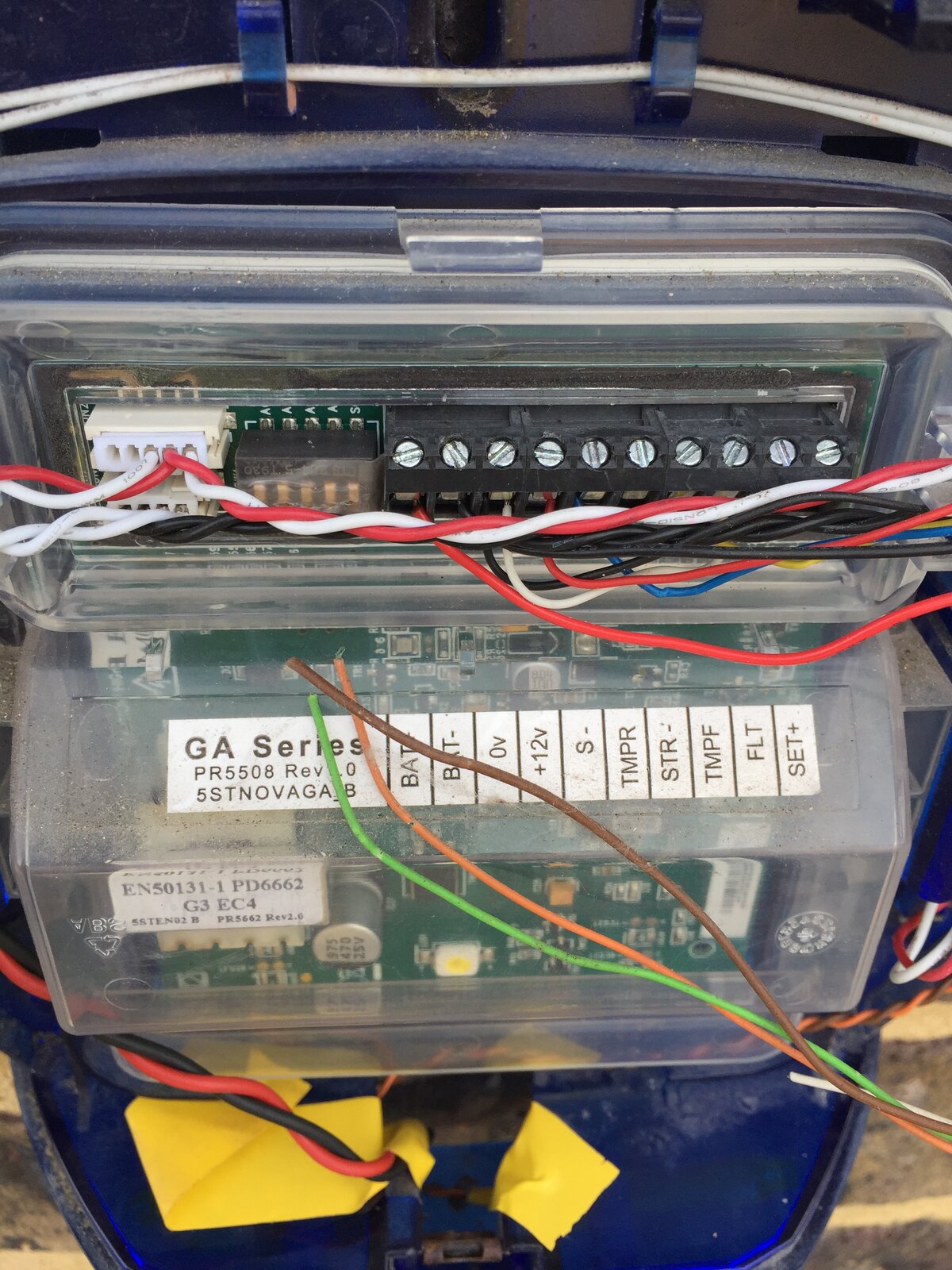

Thanks all. To clarify there are no issues with the system currently. I just know after 10 years of hot and cold external temps, something will one day go on the PCB (and i am fully aware, yes, at this age i ahould just premptively replace the bell box). Might be hard to see from the photos but I think the tamper to the panel is not even wired. However, when I open the lid to the bell box even in engineer mode, it does still sound.
Can I just remove the battery in the bell box or would I need to put a wire or resistor across the battery terminals? I assume without the tamper to the panel connected, the latter might not be needed as there is no tamper circuit resistance to be maintained?

Think I have in my archives found the bell box manual that marries up to the images.
Engineer Maintenance Mode. The Engineer may disable the box tamper (built-in bell tamper ring) by removing the 12V+ for 3 seconds. This mode will be indicated by a single flashing LED. To return the sounder to the normal mode, remove the power for more than 10 seconds. Note: For this feature to be enabled, the DIP Switch S4 (ADD 3) must be ON. With S4 OFF application of 12V to the SET+ input will place the sounder in Engineer Maintenace Mode. Whilst in Engineer Mode the sounder tamper signal will be active.
Looking at the manual it isnt a straight forward bell box by any means.
Many thanks for this, just the ticket, I will read through and see if it gives a definitive option to operate without the 12v backup/aux battery. The part you picked out could also be useful, so I don't have to wear ear defenders each time I need to open the bell box (in the past I replaced the bell box battery and the LEDs where the wires had corroded). Normally I get a blasting for a few seconds before I get my finger on the tamper switch and gaffer tape it
lookslike its wired as in fig 7/8
not sure on what the dipswitches are set to specifically but dip switch 1 is closest to screw terminals
S1 off so it draws power from panel and not battery.
S5 off standard mode
STR uses the bells battery, so no battery no strobe.
should be able to remove the battery by unscrewing the wires from battery terminals, I would insulate the ends if doing that mind.
If fault wired back to panel then no battery is likely to cause a problem back at the panel.
