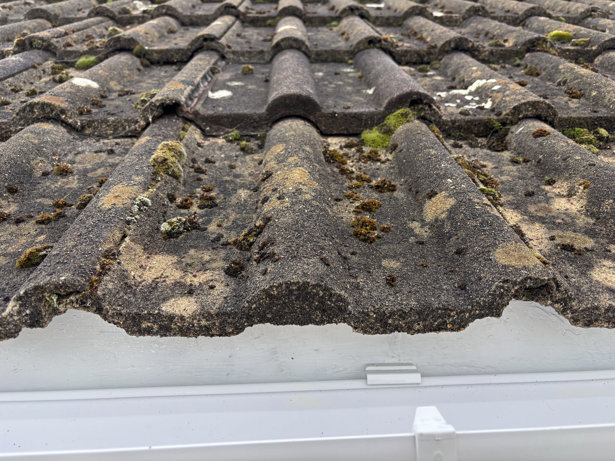

Hi. Looking for some replacements for these. Need to know which I need. Are they “Concrete Interlocking Double Roman”?
They are often nailed every other row so the first row may be nailed and you can either slide the second row upwards away from the bottom and so on up the roof or lift it one and try and get the lower nailed one out but it increases the risk of breaking tiles
