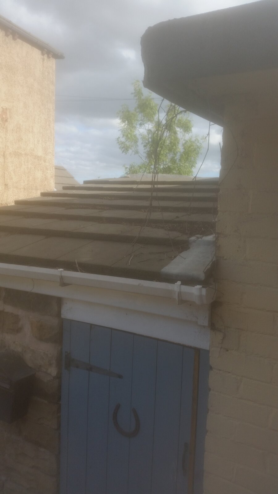

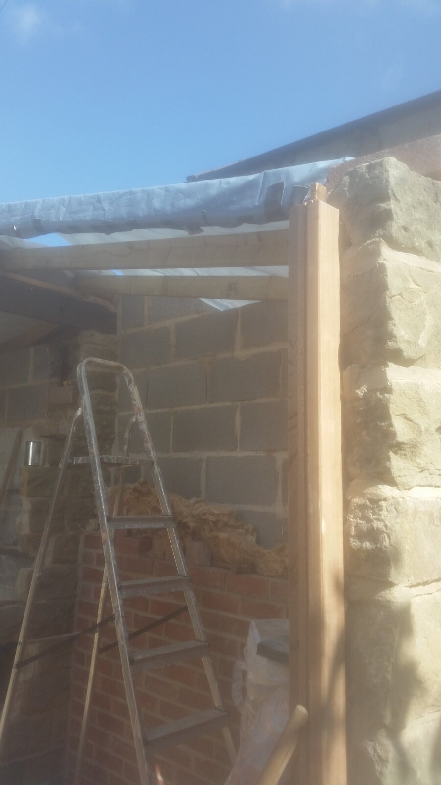

Hi these are on one side of my small build, its either these or slate ones? I took one off and it says sandtoft calderdale.
The builder put these on years ago but now I am doing other side same size so making sure I have right ones to join at ridge. The angle pitch is around 14 degrees bothe sides so I think they should have gone for a different tile as min pitch on these is 16? I have no choice but to stick with them and do same other side but its such a small roof, is it ok? advise appreciated, thanks
