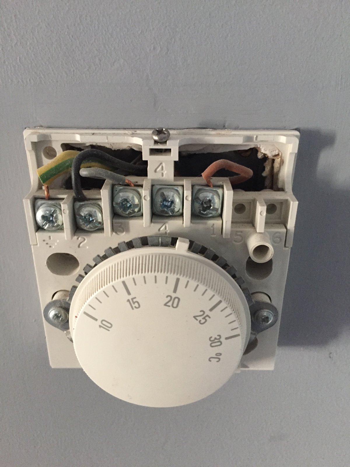

My central heating is operated by a Honeywell T6360 thermostat and I have been experiencing inaccurate control and failure to come on. If I set the temperature to (say 20c) the boiler will fire up and warm the house. However, occasionally, once the room has reached temperature the boiler will flick off, but will not come back on again and the house gets cold. To get the boiler back on I have to turn the thermostat dial way down and then back up again until it clicks. I have replaced the thermostat with a Danfoss RET2000MS (used from eBay) and got the same result. So I tried a brand new Honeywell T6360 and the problem still persists. The hot water comes on/off fine and the system is controlled by a Honeywell ST91000c. Please can anyone help?

How many wires are in the thermostat? (I’m guessing x2, perhaps x3 inc earth). Also where is is situated - Recommended height of approx 1.5 m from floor? Is it directly above or in close proximity of a radiator? Also is it in the same position as a radiator with a thermostatic control (trv)?
Isn't it 3 wires + earth
Live
Neutral
Switched Live ( call for heat }
Earth
t6360b-wiring-jpg.91328
Usually yes, but can work as a simple on off switch with x2 wires,but subject to temperature swings without a neutral connected via anticipator.
The thermostat is located approx shoulder weight within my hall and approx 12ft away from a radiator without a TRV.
I've attached a photo of the wiring/connection.
Ha ha shoulder weight ? it is wired correctly and sounds as if it is located properly, what boiler do you have ?

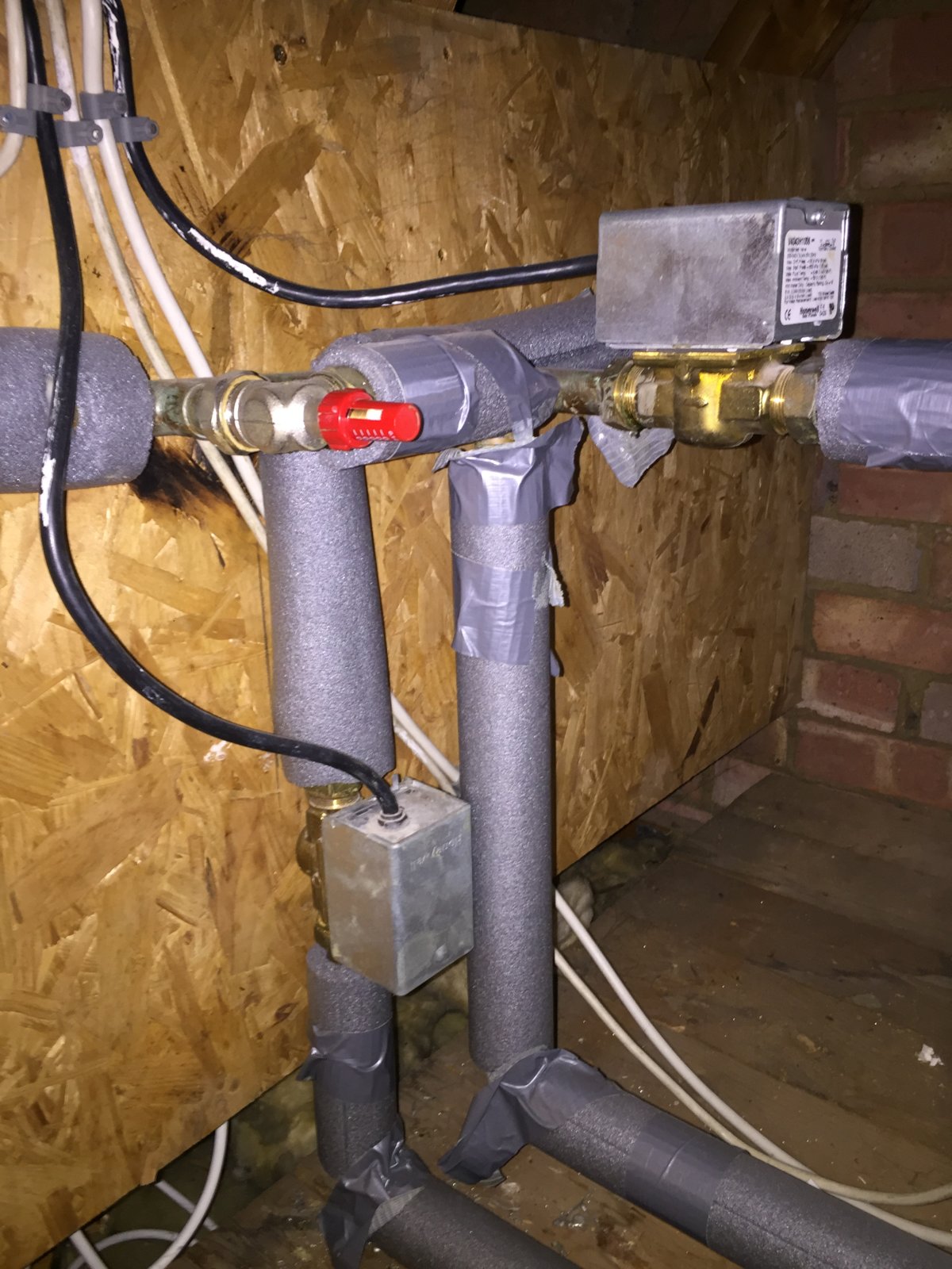

Probably a motorised valve failing, on some cycles it's no opening far enough to activate the microswitch inside.
I tried ianmcd's test above and the boiler fired up as it should. As this is an intermittent fault, so such a test could be inconclusive. Is there any further ways to test?
How can I test the microswitch in the motorised valves? I have an unvented cylinder system.

Do you have 1 x 3 port mid position valve (Y Plan) 0r 2 x 2 port valves (S Plan) if you are not sure post pics usually near the HW cyl but not always
There are 2 x 2 port valves.
