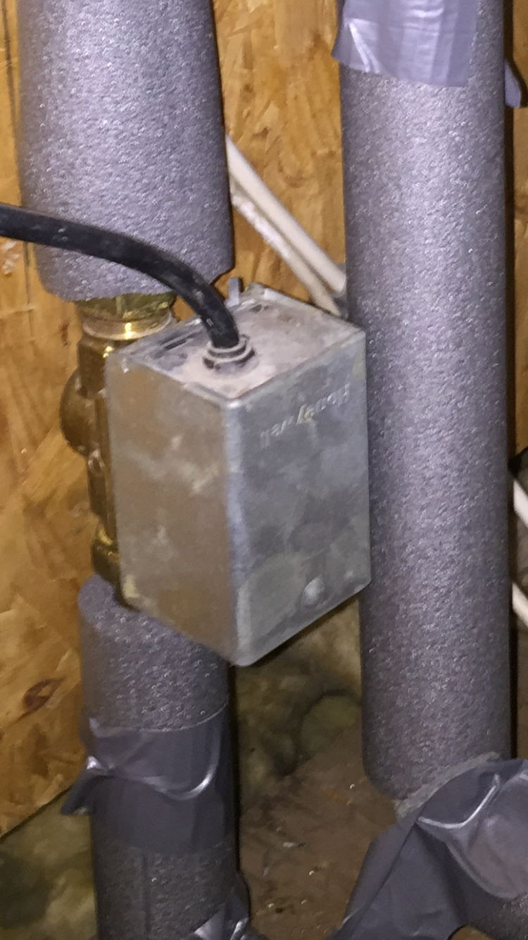

Thanks again ianmcd. I have just managed to check out the motorised valve and there was no resistance in moving the lever across. However, when I turn off the power there is a resistance and the lever moves back when released. When I turned the power back on there's an intermittent electronic buzz from the motor. I'm guessing this isn't good, but want to ask for confirmation before I purchase and replace. Thanks
yes sounds like the valve is working correctly but may have a fault the way it works is when you demand heating the motor opens the valve then once the valve is open, the motor moves a little but further and makes an electric micro switch, sometimes referred to as an End switch, and this switch brings the boiler on, sometimes the motor is weak and doesnt operate the Micro switch and sometimes the switch itself is faulty, Most actuators these days can be replaced without draining the system but not all, if you post a pic of your valve I will tell you if you have a removeable head
I’ve already removed the head to make sure that the valve is turning freely, but it’s a Honeywell 22mm x 2 port (pic attached). I see that you can replace the head or just the sycron motor. Any preference?
Depends on your confidence and competence with electrics. Head is easier, I’ve yet to change a synchron (don’t really get the chance).
yes it is indeed a removable head , and for future reference see the attached pic if anyone is wondering if they have a removable head , if it has the dimple that I have marked it is removable, cant say without seeing the job if a motor would sort it or if the micro switch has gone
So changing out the head sounds like the best route and that way I can be confident that everything is working as it should.
Thanks for that. I'll pick up a new head unit from Screwfix tomorrow and get the job done. I'll probably go with wiring direct to junction box as I don't want to wait for an eBay delivery and until next weekend.
