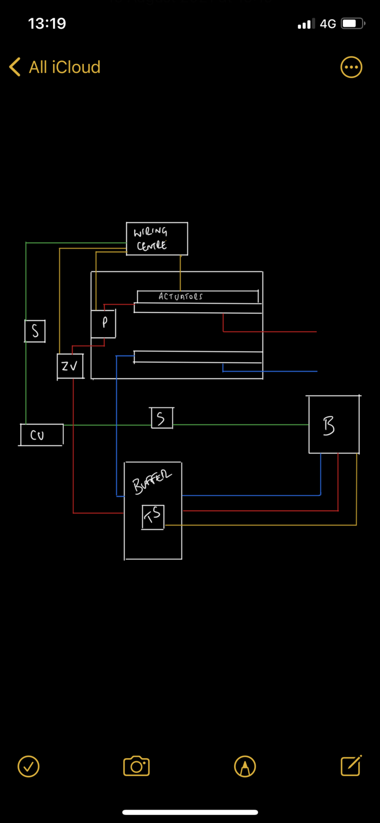

My rough drawing of the UFH system for the first floor is here

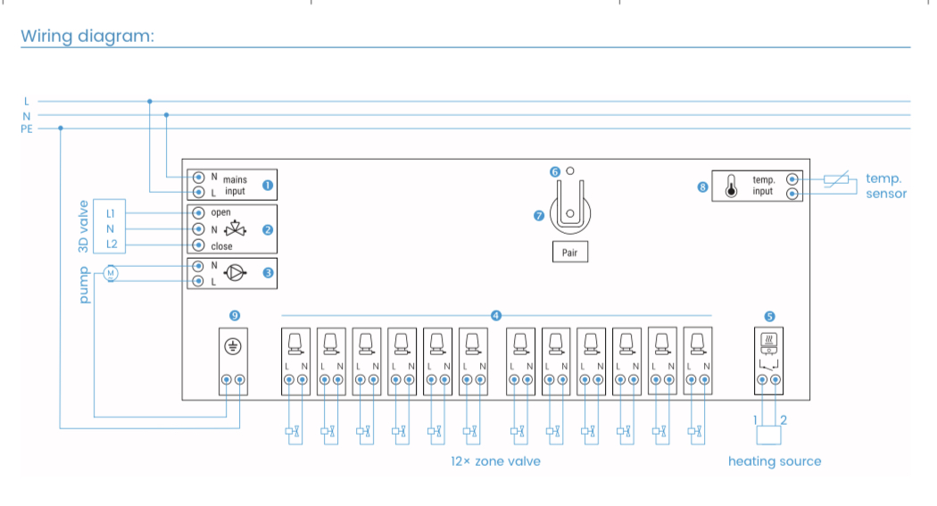

and the wiring diagram for the Wunda wiring centre I'll be using is
So where I'm still struggling to make sense is this wiring centre will be upstairs above the manifold.
Do I put just the upstairs zone valve into the S plan wiring centre before going into the Wunda wiring centre?
Next year when the ground floor gets refurbished with UFH I'll add a second zone valve but that will be just before the manifold flow.
Or do all the connections go into the S plan wiring centre before going into the Wunda???
This is where I'm getting confused as to me it just makes more sense to go from the component into the Wunda wiring centre.

So I've sorted my plumbing out. A little bit different from before in that I've now removed the zone valve before the manifold and have introduced one to be between the buffer and boiler only. I'm thinking of having 2 sets of heating flow and return tapped into the buffer so I have a seperate feed for the upstairs and downstairs (when this is finally installed) UFH manifolds. Saves me having to install a tee later on and means I can put this part to bed soon as its down.
I've drawn up this schematic for my S Plan wiring centre and I hope most of it is correct. I'm lost as to where the brown cable from the zone valve (which is to go between the buffer and the boiler) goes so hoping someones can advise. I'm thinking 4, but can't work out what else should be there. Looking over this again I believe this should be the 'call for heat' from the buffer stat which I've indicated in brown going to 1. I say this as the COM from the stat is going to 10, switched live. So some help here is greatly appreciated.
I've looked through the MI for the boiler and all I can make out is a T&E for power, but unsure what else is going from it to the wiring centre. I've put in a SL in my diagram as I can make that out, but unsure if there should be another. I'm starting the rip out for the bathroom and floorboards on the first floor tomorrow so I'll be sure to see what other cables there are going to it at present.

Why a motorised valve between boiler and buffer? If the boiler is only heating the buffer (dhw presumably all handled by the combi bit) and there's no other heat source into the buffer then you don't need it & it'll be a potential pain sorting out a delay off relay (assuming the boiler pump runs to cool the hex after call for heat is satisfied).
Your dual feed & return sketch is fine but means you'll need 3 pumps- one between boiler and buffer and one in each of the 2 feeds (or returns).
Your wiring diagram is a bit of a fail. You've got the zone valve permanently energised and the boiler stat (BS?) doing nowt. Normal setup is;
Live into controller (time clock, programmer). Switched live out of controller to thermostat Common. Normally Open contact of stat goes to live of motorised valve. Switch on MV controls signal to boiler and pump (either connects live or can make an ELV circuit if your boiler uses that signalling system- of course you'd need a relay for that trick cos the valve microswitch is SPST.
Hi, tbh the zone valve was advised to me hence it being in place.
With regards to the pumps, I assume the combi already has one (there isn't an external one fitted at present and the system runs fine albeit with radiators), and the manifold now, and in the future when the ground floor gets UFH, has a Wilo pump already fitted.
Boiler is an external oil fed combi from Worcester Bosch and from reading through that manual it notes a pump.
On to my wiring diagram am I right now in that the brown from the boiler stat goes to 10, and the blue will go to 4?
And the blue (COM) of the boiler stat goes to 4 along with the brown from the zone valve?
Still curious about the zone valve between boiler and buffer but probably won't do any harm (do check the MI for the boiler, see what it says about pump run-on).
Do you currently have a buffer- if not then that explains why system currently works just on the combi pump. You will need another pump on the circuit out of the buffer as well as the pump running the UFH.
You're confusing me with your wiring centre- all that is doing is giving you a tidy way to terminate the cables from various bits of the system. As far as I can tell, the Wunda thing generates a Call for Heat by making a circuit at block 5 (between pins 1 and 2). I'm assuming the rest of it is doing UFH specific things. That heat will be delivered by the buffer so all that pair does is power the OUTPUT pump from the buffer (currently not fitted), it doesn't connect to the S plan at all.
Back to your S plan wiring it should work as I described earlier.
You'll help yourself by redrawing that schematic and leave out device neutrals and earths- that'll make your switching much easier to see

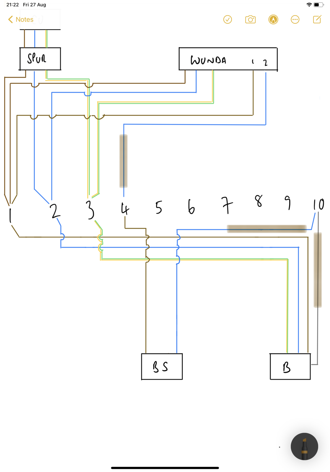

Thanks for you reply. I've attached an updated version of the wiring which I believe now to be correct and have omitted the zone valve. Still has the earths and neutrals but I have also shaded brown over any cables that will be live to indicate sleeving to be used. It now makes more sense to me for the switching sequence with how this will work. Seeing it all drawn out has definitely helped me understand it and what is happening.
I've spoken to Wunda and Wilo with regards to the pump function and both confirmed the circulating pump on the manifold will be able to draw from the buffer and supply out to the zone/s calling for heat.
