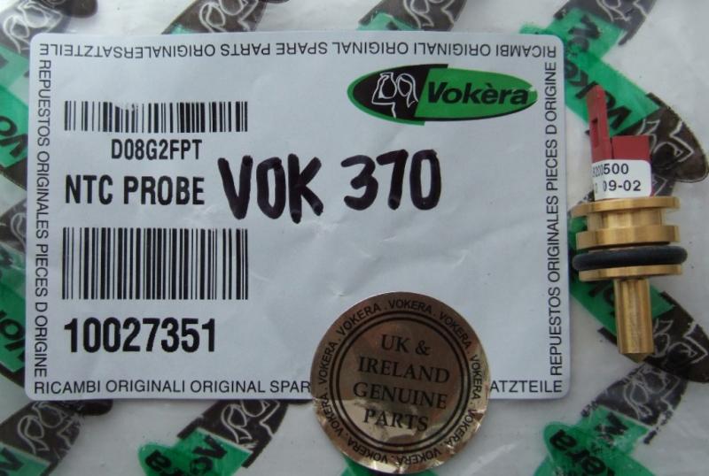

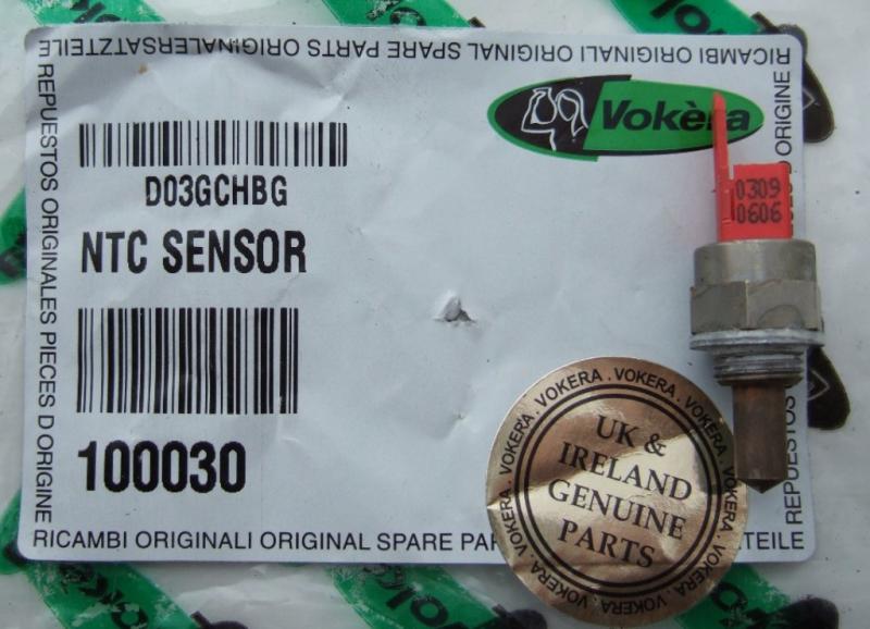

I am getting confused now. According to user manual, Solid Red Light fault indicates to NTC Primary Sensor and it is supposed to be fixed (screwed) on the right hand side of the main heat exchanger.
I bought pair of sensors pictured below.
I have changed above sensor and it seems that it can only be fixed to right hand side of the main heat exchanger.
It seems that above sensor NTC Probe can only be fixed on the top of a component which is almost in front of DHW heat exchanger. I have not changed this sensor yet. Is this secondary sensor that I should best change?
However, none of my sensors has no 8484 as you mentioned in your early posts. I am concerned that I might have bought sensors not correct for my model of Vokera/Sabre as they did not came in sealed plastic packets.
According to your knowledge, are these the right sensors?

according to your manual
page 34 pos no 521 part number 10027351 DHW NTC
page 35 pos no 520 part number 10027352 CH NTC
when i was quoting you the part no 8484 these are the ntc`s in most older compacts ( mine included ) our local merchant knows what we are asking for even if vokera/sabre change part numbers about!
not sure about top pic showing a part number 100030
maybe if you pm DP he might shed some light on it

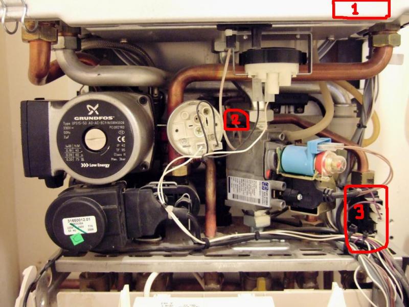

Here is the bottom half picture of Sabre (Vokera) 25 HE.
QUESTIONS:
1- I have already changed NTC sensor attached to, right hand side of main heat exchanger. (High above where I marked "1" in my picture)
Is this the primary sensor?
2- Even though I can not clearly picture it, where I marked "2" in the picture is looking like the only place is my second sensor can go.
Is this the secondary sensor I was advised to change?
3- Where I marked "3" in the picture: Is this the DHW Flow Regulator you want me to remove and put it in dustbin?
ok you have a 35 compact which is really a linea
the 24/28 compact are a bit different
1 is the main
2 is the h/w
3 is the flow switch not the flow regulator
i dont think the sensor u have will work for the hw you need a threaded 1 like the main 1 you have changed.

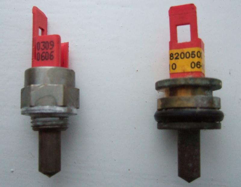

Here are the sensors I have changed.
As we agree, the one on the left is Primary NTC sensor, and the other one is DHW sensor (secondary sensor?) which I have just changed.
If you look at the DHW sensor closely, you will notice the greenish deposits of rust/water contact at the side and top of it.
As it sits directly under where I have found the water leak (when it was v heavily raining the other day), perhaps this sensor was damaged/shorted by water contact?
Since I changed the DHW sensor, combi fired up easily as it should, CH heating works too (pump setting is on number III :oops: ).
So, I am keeping my fingers crossed! I will give it a day or two and will post the result.

don`t worry about the flow regulator, i meant that you could/should remove it when the combi was drained.
if your hot water flow rate ever diminishes, giving intermittent lock outs or
hot water goes hot/cold/hot/cold this would be the first thing to remove as it is doesn`t cost ya anything and its a quick fix.

Are you sure that it only worked after you had changed the DHW sensor?
According to your interpretation of the fault code it was the primary sensor at fault.
A boiler engineer would have measured the resistances of the sensors before changing anything.
Still its working now.
I would have expected genuine manufacturer's parts to have been in sealed packets !

- No, it was working (on and off with the fault) before I change the DWH sensor. I guess, the only other thing happened to made it work short while could be to do with emtying and refilling the system? or not? I do not know.
- Even though the plastic packets were finger seal type, I have no doubt they are Genuine Vokera parts. The numbers on the old one matches the numbers of the new ones exept what I gather the date code. There might be a very little possibility that they may belong to different model.
I have a electrical multifunctional test machine, while I got the old NTC primary sensor, could any of you tell me how to test it please?
