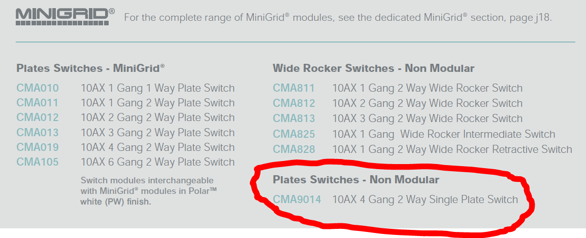

I've also just noticed they do a four gang switch on a 1 gang faceplate, though it's not clear how that fits in with the modular stuff.
It makes you wonder why they are not all like that.
