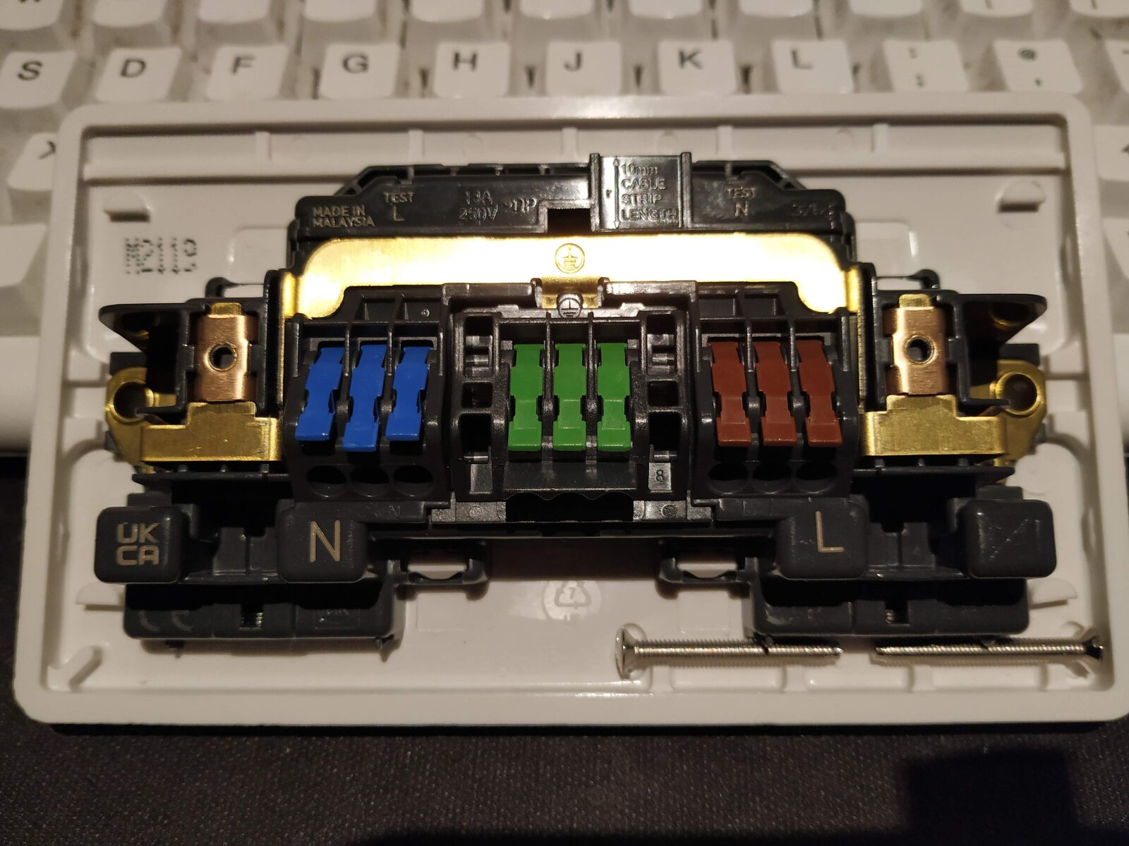

We'e had screwless switches for years.I am surprised they only released a socket and not other stuff at the same time.
Those screwless Ceeforms are aweful, terrible reliability.Agreed that it is probably a very cheap action MK switch but the screwless terminals that already exist in other markets (US, EU, ceeform) make lots of sense.
Apparently there are additional screwed earth terminals at the side of the connectors.I'd like to see a 4 or 5 way block on the earth terminal, to allow for 3 circuit cables plus a box flylead, or for extra CPCs in high leakage current situations.
No.additional screwed earth terminals
