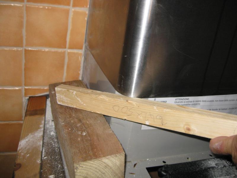

The question I have asked is :- " How do I take the false chimney off the electric extractor unit to get at the exhaust pipe . This may also entail taking the complete unit off the wall and disconnecting the electrics .
I was asking for advice from guys who may have done such a thing."

Your pretty much *ucked by tiler & guy who did coving probably under someone else`s instructions.
The sides of chimney have to come out sideways(chimney internal return edge) to get away from internal bracket and hood.
Looks like you will have to remove small tiles at sides of hood.
Thanks Swampy ,
That's what I was afraid of , I managed to take out the whole 3 mm wide run of grouting adjacent to the chimney on either side from top to bottom but couldn't ease the rear side out away from the unit .

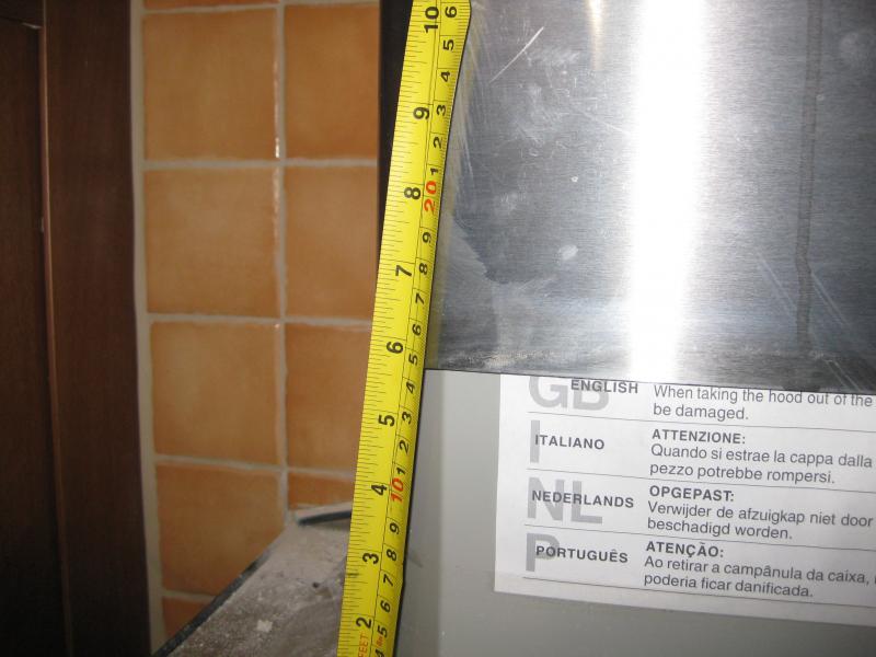

The internal lip is between 5-10mm wide.
Other option is to unscrew cooker hood from wall( are fixings accessible?), you would be able to clear grout around its edges, then work it forward away from the wall(set up something to support it below, supply cable will stop you dropping to worktop).
Once its away from chimney, the chimney should the be free to remove.
Long winded but less cosmetic damage.

Thank you very much Swampy,
That's what I was after ....... that 5 - 10 mm figure.
It looks like I'll have to cut a few long thin wedges and ease the sides away from the chimney frame once I've taken a row of tiles from each side , as there are no visible or accessible fixing screws or nuts /bolts.

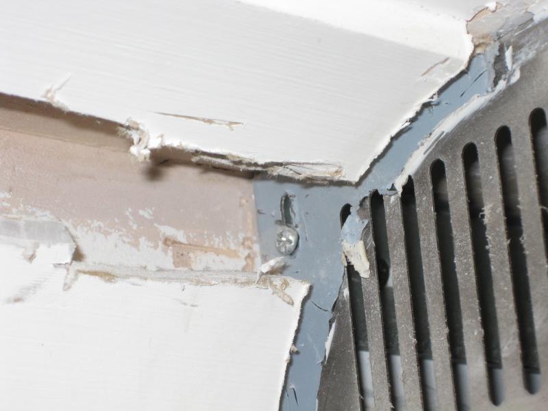

Am I mistaken, but I can see fixing screw at the top of the stack, it looks like the stack was not tall enough that is why you have a gap at the bottom. I guess that bottom of the stack hooks around the body of the main hood.

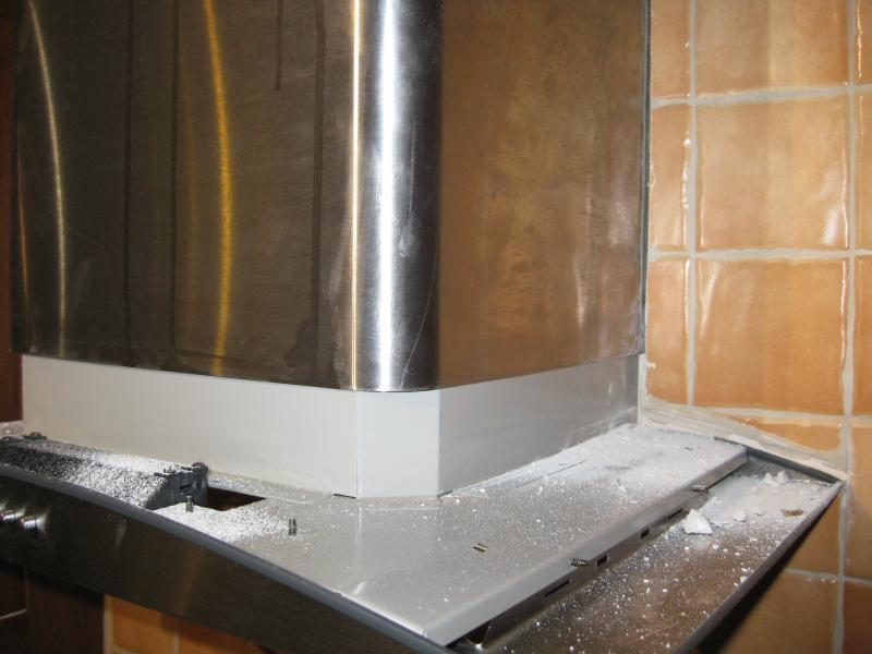

Here`s a link to a different cooker hood make(could not find howdens Instructions).
The main hood bracket may be different, ones ive fitted had 2 screws securing just above motor housing(no bracket,hood housing had holes)you could lift hood up & off away from screws.

Swampy,
Those pictures speak a thousand words and some .
I think it is identical but just branded different to the one we have.
As every thing is almost free I'll set up a platform and try gently easing the whole unit up & on to it once my lass has crawled in the roof void on some boards & freed off the excess spare electric supply cable and vent pipe at the outside flange .
The gap at the bottom is my doing ...... where I managed to lever /slide the cover up ... it does/did reach down to the canopy .
Well it does not seem that other tradesmen/ have been that thoughtful with regards to accessing the rear of the extractor. it maybe that you may have to remove a column of tiles at both sides to gain access.
Beggars believe that they did not tile behind the unit before fixing!
