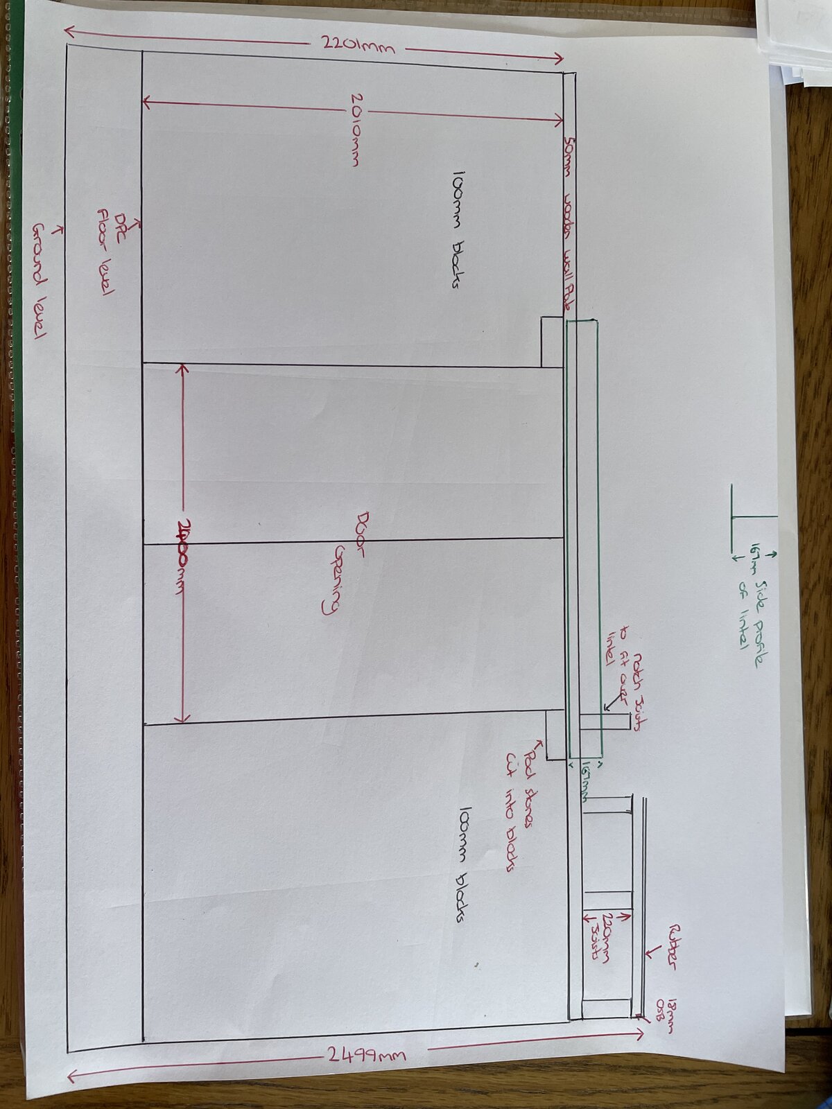

I have started building a block built garden room. 6m x 3.8. I am struggling to find the correct lintel which needs to be a low profile. I have the door opening of 2.4m. I need to keep my build under 2.5m and to top of door from floor level will be 2201mm. I am having a step up to room to keep it above ground level and the door measurement is 2030mm. Can anyone point me in right directions for lintels? Also beam sizes, i was going to put 220mm beams in but might need to try smaller if pos to keep roof down.

I will be needing to put a wooden wall plate round which will be 50mm to attach the beams to will i not? So in theory that would have to sit on the lintel then the joists on that. But am really tight on space. My roof won’t have that much load, as doing 18mm osb then rubber roof
That is the lintel, so the wall plate sits inside the lintel. The lintel sits directly on to top of the the blocks. If you only have a single skin wall, just build a double width pier to support the lintel.
167mm height though?? So i would just sit the wall plate then the joists on the back half of the lintel. What happens to the front part? I will get a drawing of my build up.
You could notch out the joists over the lintel so your joists run over the block work to create an overhang for a soffit. You would need a timber plate in the lintel to support the joists.

I will be framing the internal with wood with an air gap between the block and wood, will have insulation and vapour barrier and have weep vents in block work so air can circulate round and will be a cold roof.
Something like that?
