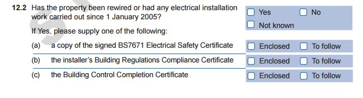

I'm not sure of the actual wording or law but if they can only ask about work since 2005, I don't see how non-notifiable work can be in their remit. Or conversely, if they ask about work since 2005, surely that does not include non-notifiable work.
They can ask what they like, but cannot force anyone to answer, let alone to give them the answer they would like to hear! I don't think one can expect the average member of the public to know the difference between notifiable and non-notifiable work, and this is reflected in the Law Society's standard conveyancing form ("TA6"), which (by omission/implication) asks about any work since 1st Jan 2005. The relevant section is:
Response (a) (which refers to a non-existent certificate!) is clearly the only one relevant to non-notifiable work, so one would have no option but to leave (b) and (c) blank in such a case. However, one could also leave them blank even in the case of notifiable work and, indeed, for either notifiable or non-notifiable work, one could also leave both boxes under (a) blank - thereby indicating that no certificate(s) was/were either 'enclosed' or was 'to follow' (i.e. one did not have such a certificate(s)!). It would then be up to the buyer and/or their solicitor to 'put that in their pipe and smoke it'!!
Kind Regards, John
As you say, (b) and (c) do not apply (to non-notifiable work) and
there is no such thing as a "the BS7671 Electrical Safety Certificate".
Is that not what they call the Landlords Safety Check? - again, no such (official BS7671) thing.
As you say, (b) and (c) do not apply (to non-notifiable work) and there is no such thing as a "the BS7671 Electrical Safety Certificate". Is that not what they call the Landlords Safety Check? - again, no such (official BS7671) thing.
I assumed that they were referring to an EIC and/or EICR, but it's very poor that the Law Society cannot get the names of the certs right!
Kind Regards, John
If the installer is a CPS member completing notifiable work then the completion certificate comes neither from LABC or the electrician. It comes from the CPS scheme itself.
LABC will only issue a cert of completion if the electrical work is part of a larger project that is subject of a building notice. An extension to a house, for example.
