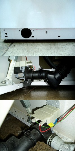

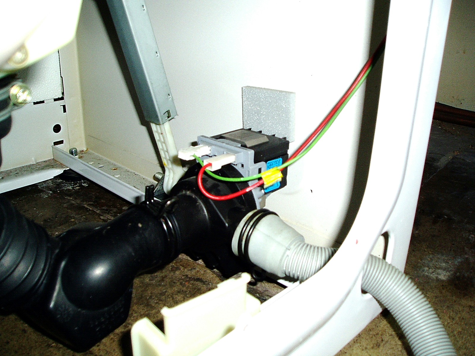

Bilabong007, this is what the pump looks like w/o its plastic cover. No screws in sight, unfortunately. The outlet hose (grey) is attached to the pump by a spring clip that faces the floor, with a clearance an inch or so. No way anyone can get that off unless the pump can be detached from the machine.
How to get the pump off? Here's a composite picture showing 1) machine with front panel removed, and hand-hole; 2) view through hole; 3) back of machine. the pump is at attached to side of machine, right at back, at right angles to the front hole.

That definitely sounds like the pump motor has failed or there is something in the impeller, you should not need to completely turn the machine on it's back to access the screws that secure the pump housing to the frame, just tip it up & rest it on a small stool or strong bow or anything similar. Once you have the pump assembly off there are just 2 screws securing the motor to it.

Update: Another friend appeared unexpectedly at crack of dawn this morning. Between us we were able to tip the machine over to about 20deg and (with his 'screwdriver' micro-socket set) take the pump out, tra la. (y) We were unable to get it to come apart it but we checked it and found nothing loose and no foreign objects. Ditto the grey outlet hose.
So afterwards I put everything back together and washed those dirty towels on a short cycle. The pump made only its 'graunching' noise - not the frightening 'broken bearings' noise it made during the tests post my other friend's visit on Sunday.
So I find myself in Silver50's uncomfortable position of not having found any 'evidence'. As soon as I have a new load I will do a full cycle and report back.
