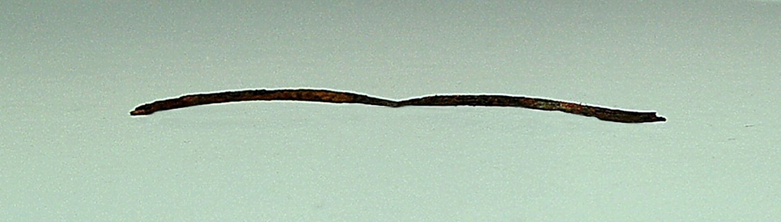

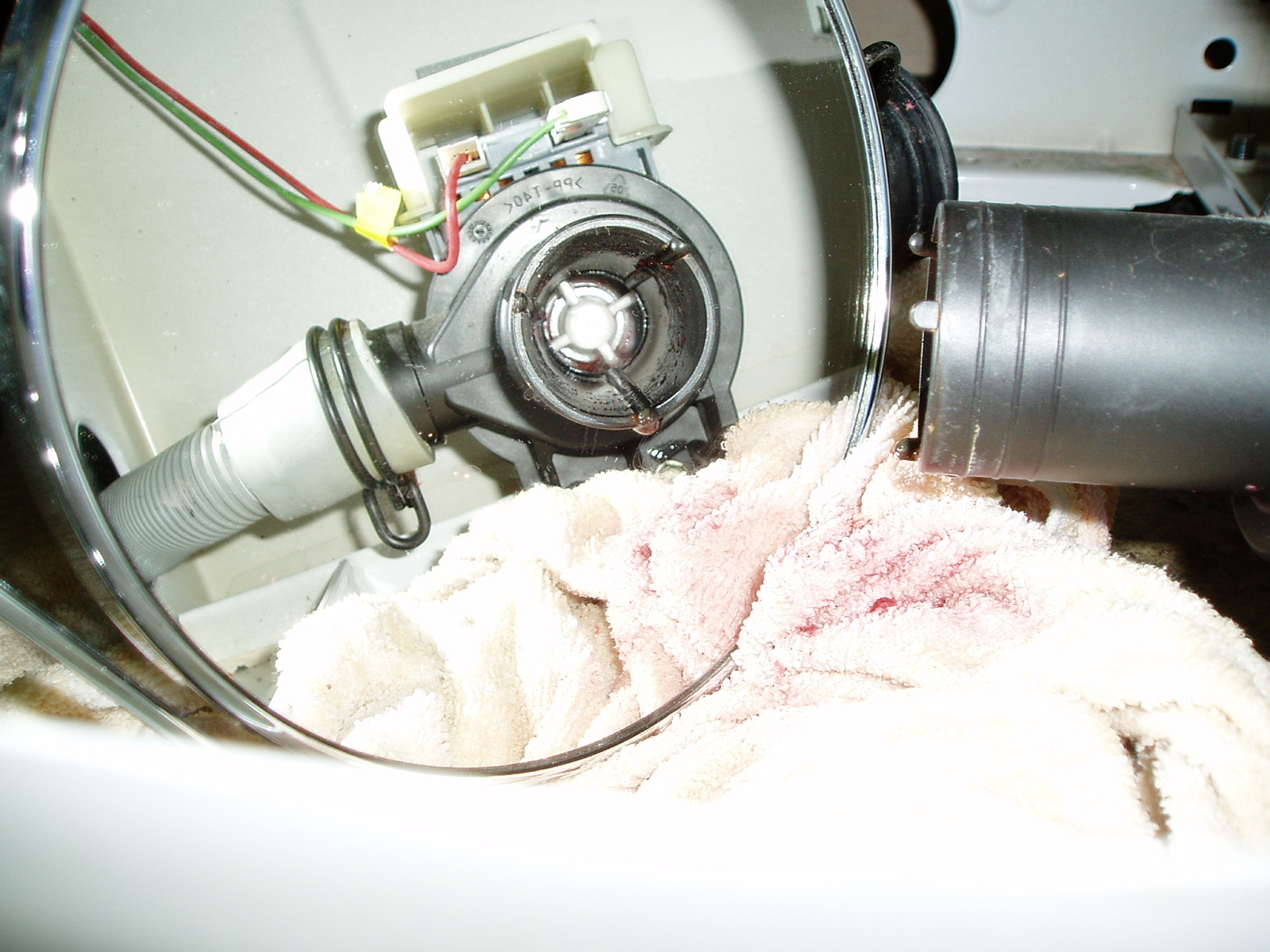

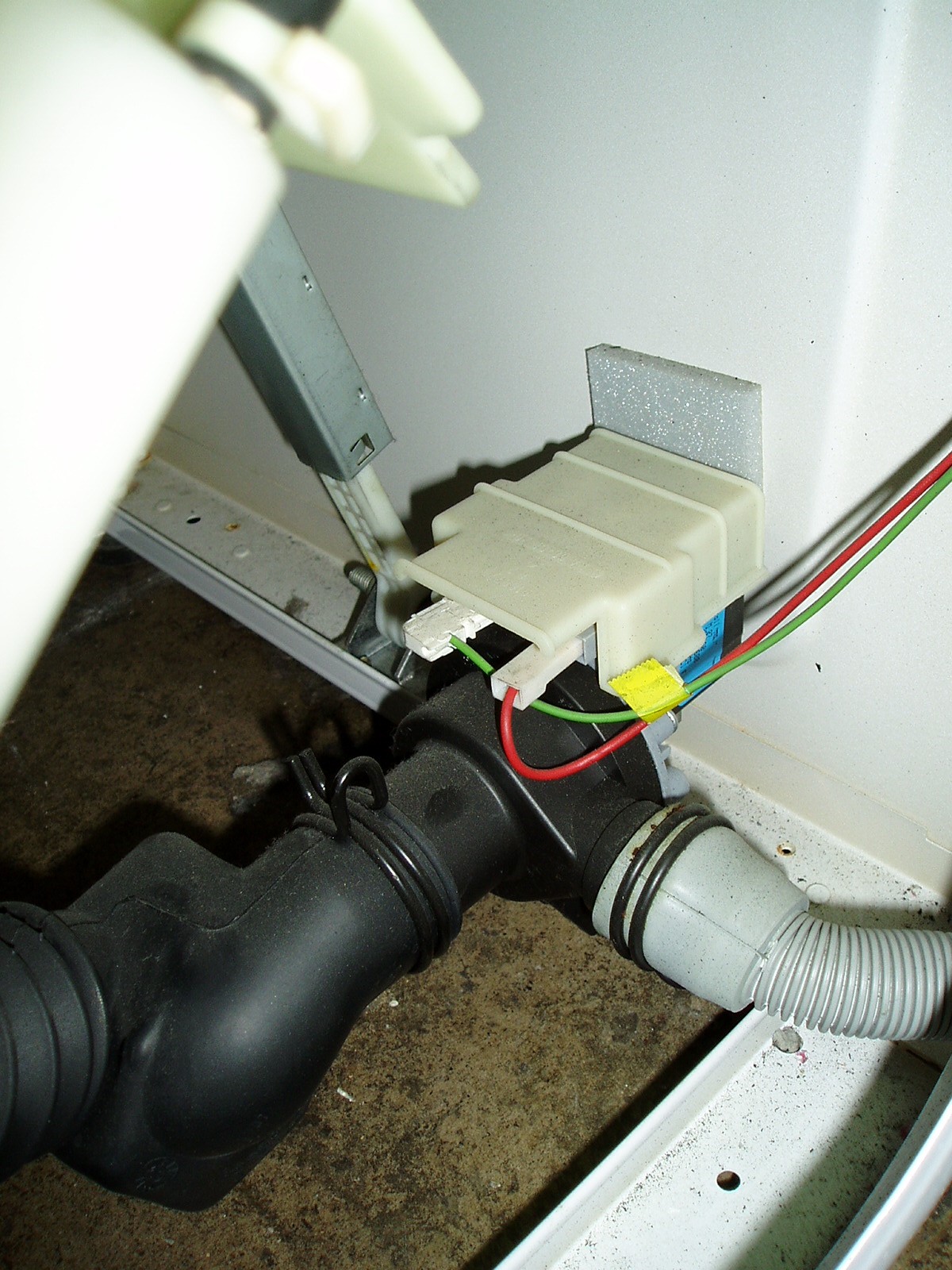

Good idea to check the full path from drum to pump. The pump itself was clear. Actually inside the rubber 'gravity trap', post-drum, pre-pump, I found a small length (60mm x 2mm, not round in section; more a sliver) of slightly corroded metal. I have absolutely no idea where this came from but could it be significant? Part of something that's failed? Some photos attached. (180007 is the pump blades, seen in my makeup mirror.)

I had a similar problem with my hotpoint machine. Looking at 18007 it was virtually identical to my pump assembly.
When I dismantled it and pulled off the impeller I found a bit of an elastic band jamming it. It looked ok until I had the impeller off though.

Bilabong007, I feel I have gone as far as I can. I'm OK with hoses but am not confident I can dismantle and then reassemble the pump watertightly.
Can anyone comment on the sliver of metal? Where did it come from, what does its presence in the gravity trap mean? Is there anything in the drum (sensors, switches etc) that can have failed?

The piece of metal is obviously mild steel rather than the stainless steel that the washer is made from. You'd be surprised what can pass between the washer drums - paper clips / hair grips / bra wires et al. I really wouldn't worry about it!

The mild steel fragment may be from some work/hiking trousers/jacket - though Magicmushroom666 seems to think it might be part of a decrepit heating element... I have no idea how the drum is constructed or where the element is - are they in the same space (cf a kettle) or not.

Machines have an inner and outer drum - the outer stays still whilst the inner obviously is able to turn. The heating element is in the bottom of the outer drum. Its amazing what can pass through the holes in the drum or maybe the door seal.....I've even found the odd coin in the pump - theoretically impossible!
