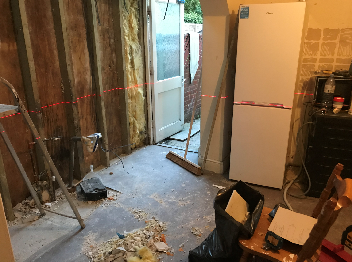

UPDATE: I wanted to provide you with an update ion where I am at and would welcome your input please.
the base units are 73.5cm tall, the plinth is 14cm. This gives me a combined height of 87.5cm. When I measured around the room, the surface was pretty flat. I have added a few mm for a vinyl floor that will be laid.
A quick thanks for the recommendations for a laser level. Remarkably helpful. The advice came from this forum!
This line is 87.8cm at the lowest point and 87.5 at the highest point. I can also see that the feet are 12cm when at their minimum height. This gives me 2cm for adjustments.
I may need to shave something off the plinth once everything is in place if I have followed your advice correctly.
My worktop is 4cm thick.
I have then laid my subway tiles on the floor and measured 5 rows worth. This comes to 50cm. I have added the 0.2cm spacers x 6. Added a bit more and set the height above the worktop as 56.5cm.
This is where the base of the wall units will sit.
I would welcome your thoughts.

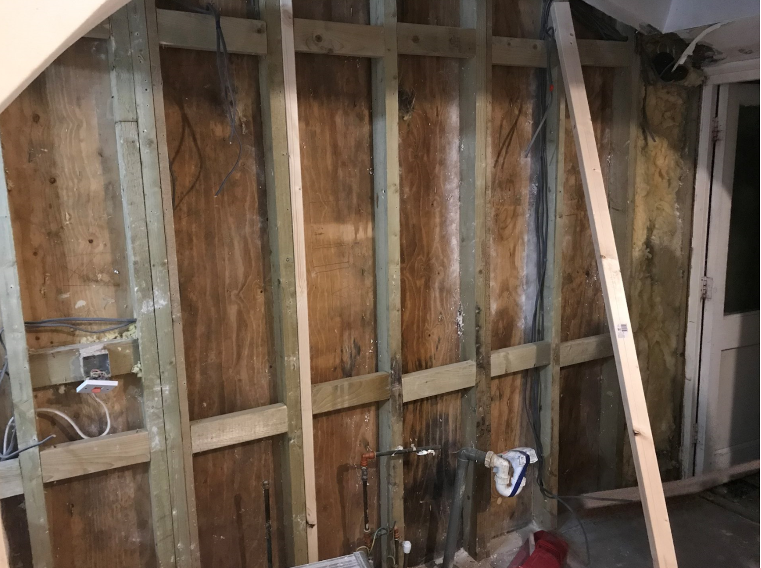

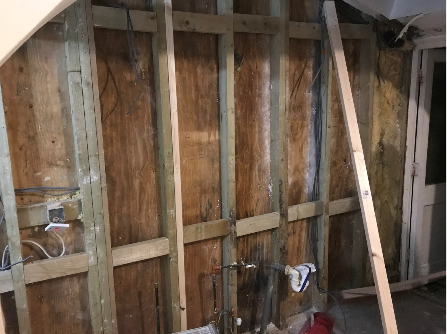

I wanted to fit fixing battens at the correct height before boarding up.
This is now done but would welcome your validation/comments on the proposed heights.

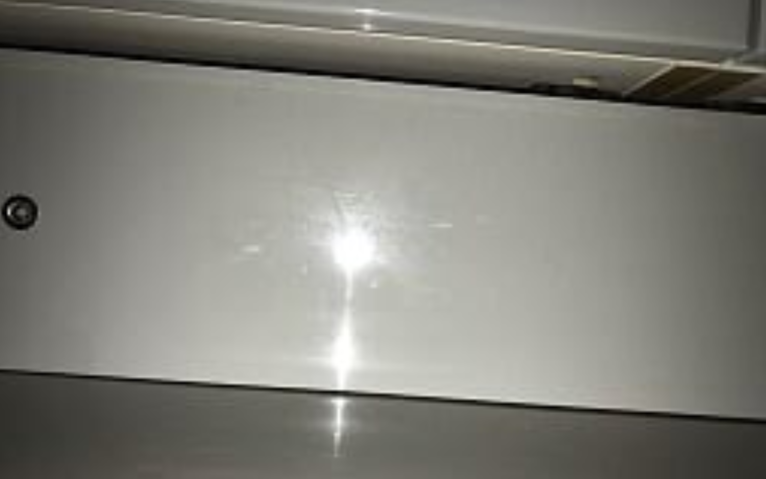

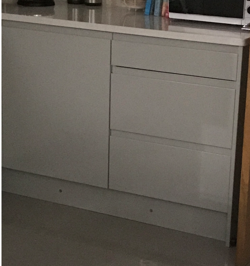

To help settle this debate on plinths, I just checked the plinths at my friends house. I did get some quizzical looks!
This picture was taken with me laying on the floor
I would estimate that we have a gap just over 1 cm.
Here is a view of this from 4 metres away:
Are we overly concerned and perhaps we can get away with a gap of around 1cm? Especially when this means that the plinth slides in easily and wont need any trimming?
I would welcome your thoughts on this.
