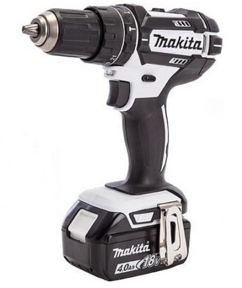

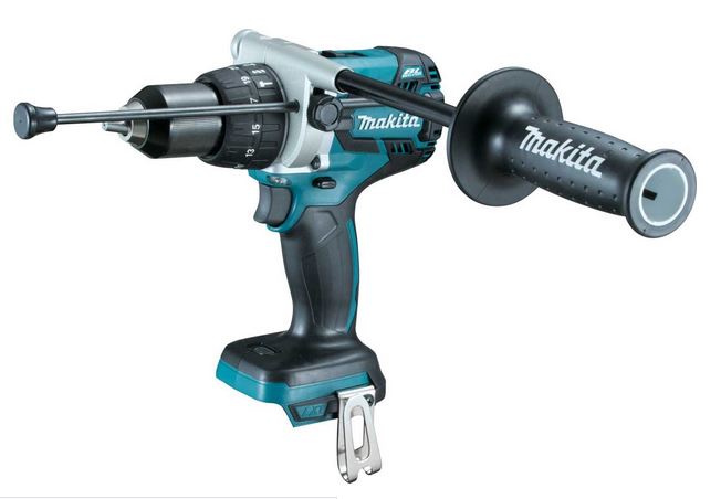

I have one of these:
and when I was screwing in (eventually try speed 2 on full torque), it didn't manage to screw in a coach bolt (75mm) into a rawl plug. I got it 3 quarters of the way home but it wouldn't go any further. I suspect my impact driver would have done it if I had it to hand...
Question: is this drill/driver designed for such a purpose? Should it have managed this?

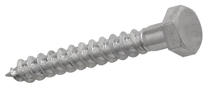

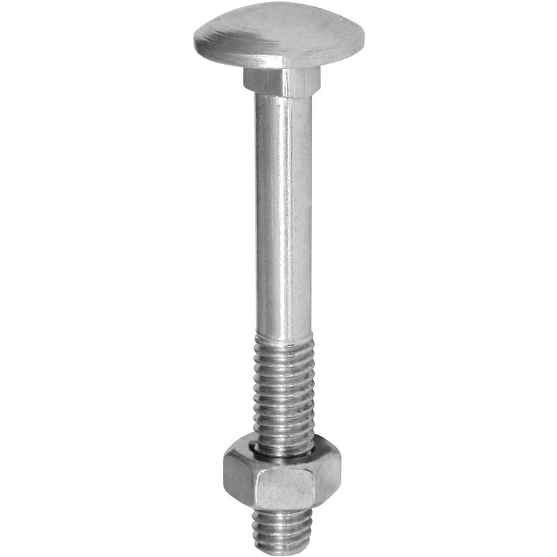

I suspect that you are referring to a coach screw:
as opposed to a coach bolt:

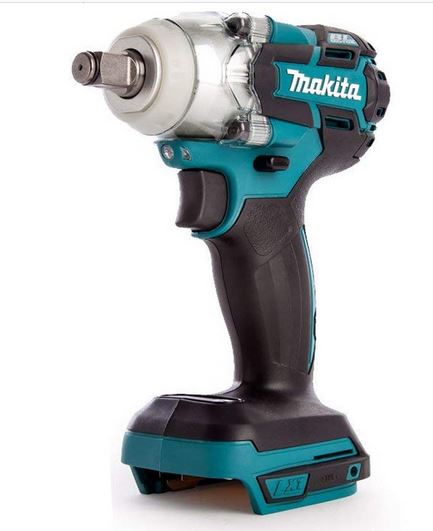

For nuts on the latter (when sistering joist ends, for example) I often use one of these:
which will generate 280Nm of fastening torque. It doesn't struggle, even when tightening M16 nuts on oak beams. I used to use one of these:

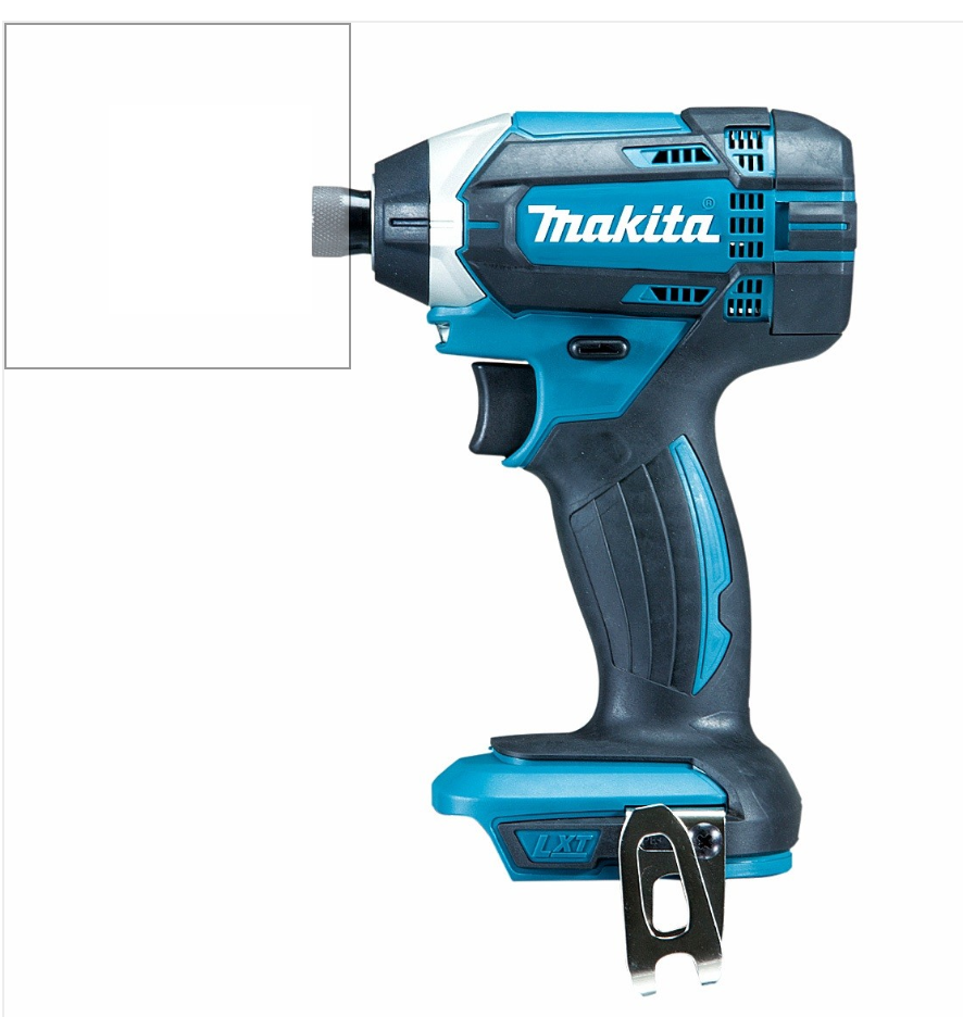

Thanks for the responses. Yes, I am referring to a coach screw. A couple of follow-up's please:
Is this the same as my impact driver but with a different end slipped on to it?
makita-dtw285-18-volt-impact-wrench-001_01-jpg.163479
I have something like this:
Secondly, should my Makita drill/driver have handled this situation? It's still under warranty and I could return if this is an issue.
Thanks again.
They work just the same, yes. But look how meaty the metal housing is at the top/front. They are designed for a lot more torque than the 1/4 inch hex drive ones are capable of. The have a larger hammer and anvil inside, which is what does the impacting.
Not really, no. When a drill driver has enough torque for a large coach screw, it would need the side handle (look at @JobAndKnock's picture) or it would be potentially dangerous to use.
Your 1/4 inch impact driver it the correct tool for coach screws, up to M10 screws, maybe M12. If it struggles toward the end, finish with a ratchet and socket.
The DTW280/285 1/2 impact wrench is a bit more industrial. I use them for sinking M12 X 150 tap con bolts into 40N concrete and fastening up bolts in structural steel. For plugs and screws, they are not.
The impact driver should be more than adequate for most jobs around the house and fixings commonly found with masonry.

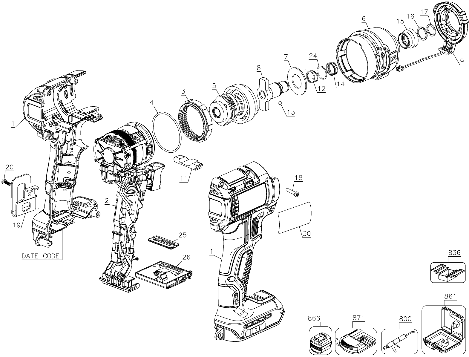

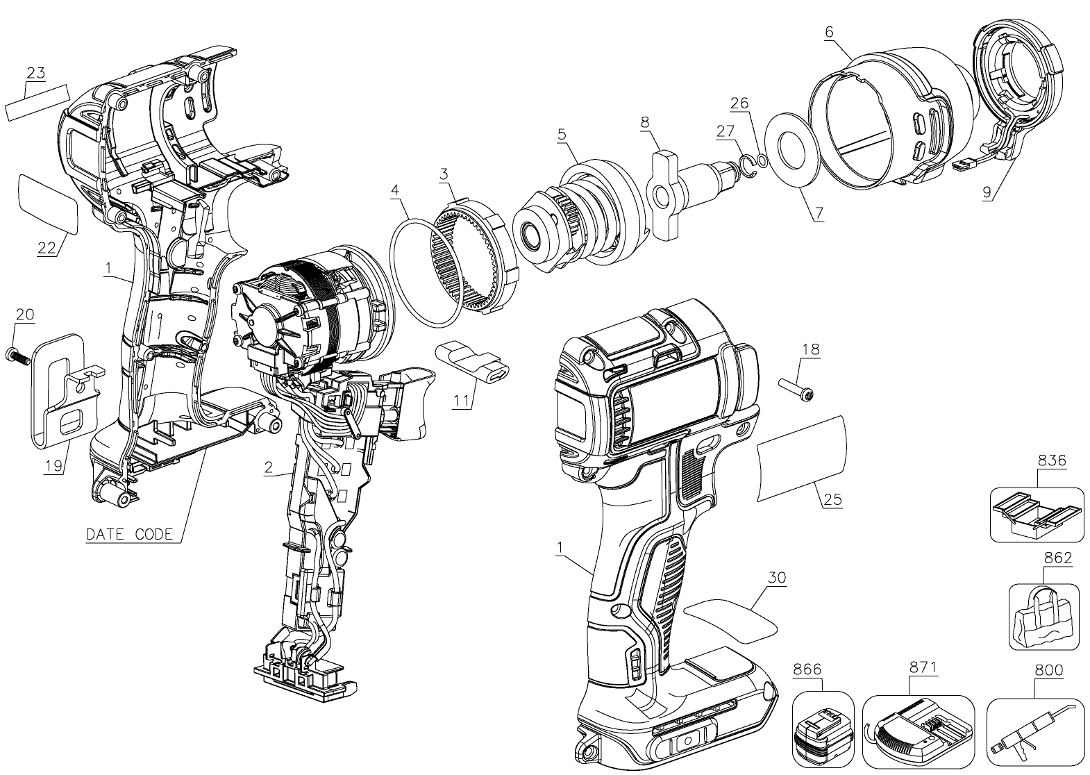

impact drivers and impact wrenches do not work the same way
Did you get that from...?
https://www.diynot.com/diy/threads/bosch-impact-driver.501301/#post-4133083
Here's an impact driver...
Here's an impact wrench...
They do work the same, the parts are pretty much identical. Both use the motor, to turn the planetary gearbox, which turns the spring mounted hammer, which turns the anvil. They work in the exact same way. The only reason there's lots more parts near the chuck in the Driver diagram is because that is the hex bit holder springs/washer/clips/etc.

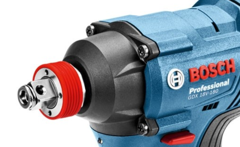

Seeing as Bosch now do a chuck that takes either 1/4 hex or 1/2 square, then it can't be any different!
