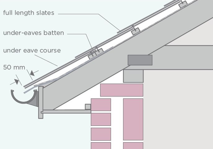

1) the slate and a half tile at bottom was not done instead they used two whole slates

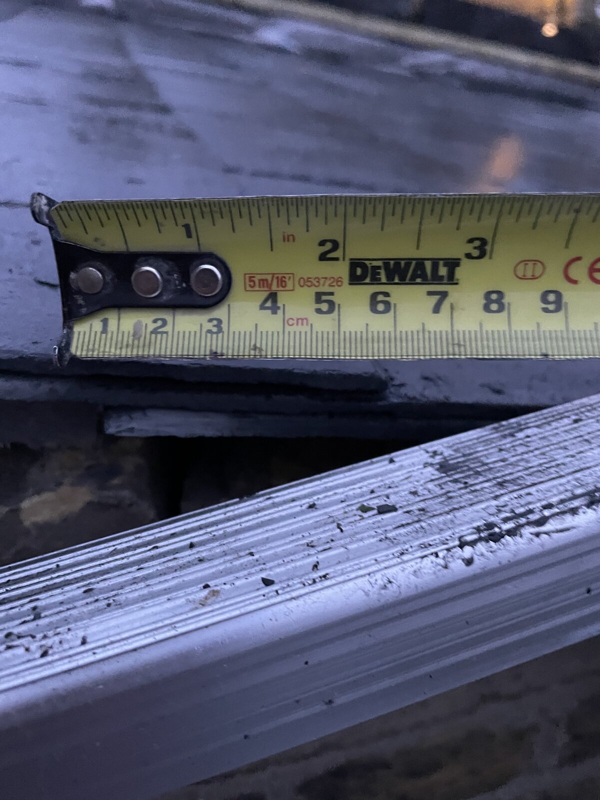

2) the eaves drip tray sits on top of the membrane
3) the verge overhang is 20mm and should have been 50mm
4) the slate headlamp is 50mm and should be 75plus
