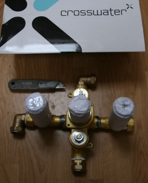

I've bought this manifold recently and has 3/4" BSP female outlets on each connection.
It will be installed horizontally.

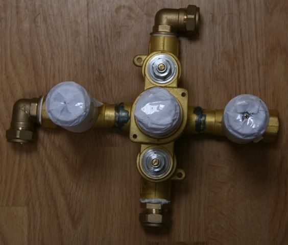

I purchased 3 off 3/4" x 22mm Elbows to fit into the side outlets and the inlet at the top (the HOT connection). I also fitted a straight connector on the bottom connection (COLD).
Now, here's the issue I have. I want the elbows to point downwards.

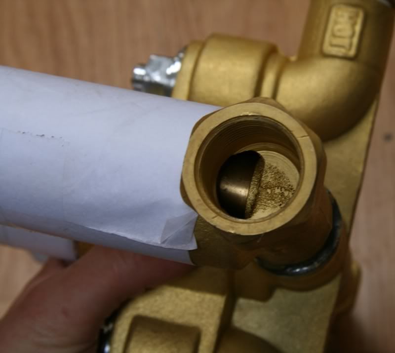

Also, obviously I want the thread to seal, being only BSPP threads and not BSPT.
I tried to wrap enough PTFE tape around the threads so that it became tight when I got to the position I wanted. It's not really working, as I want the threads to be tighter than it as, however, the tape just gets stripped off of the male connector (due to the thickness of the tape).
As you will also see, there is no seal face to install a fibre seal inside. I did however think about using a 0-ring between the face of the connector and the outlet edge, but knowing that o-rings can crack over time.
How would you suggest this?

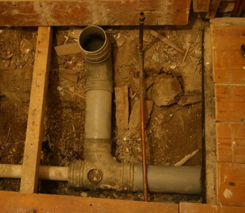

Oh and whilst I've wrote a thread, how would you block off this Soil pipe, as I'm going to be moving the toilet to the right of that 15mm water pipe. The soil pipe manufacturer is Terrian. I can't see any solvent cement, but guess it will be that rather than a push fit, as it's stuck tight! :cry: :cry:
Wind the PTFE on the thread to form a taper.
Cut out the old section of 110mm and redo.

The tape tended to bind up as I wound it in anyway. It's just that I've never used a BSP for sealing - it's either been a taper thread or compression fitting. As this will be behind the tiles, I'll always have it on the back of my mind of it leaking. :confused:
Any recommendation to use a joining compound, or even Loctite 55 (or equivelant) as I was suggested to use before. Would that not react with the tape??
As for the soil pipe, I have a new branch to connect the new toilet to, but didn't want to touch the waste pipe from the bath. But as you suggested, it's possibily more easier to cut the waste pipe and add a length of pipe into the new Branch. I've got an adapter to fit into the end anyway.
Just plain PTFE tape on its own. Wind as a taper on the male thread and it will work fine - just a case of judging the correct amount of tape. Since the whole lot will be tiled over I would suggest you test for water leaks before tiling.
Much simpler to use straight male iron to copper compression connectors and then a male x female soldered copper bend. You can then fully tighten the compression connectors and then orientate the MxF bends as you please.

Chris, thanks for your input. That was the way I was thinking about doing it initially, but by the time the straight connector is fitted, then an elbow, it exceeded the width between the plasterboard joists. :cry: :cry:
Thats when I thought I'd be smarter using the compression elbows..........! :mad: :mad:

Even with male/female elbows? They take up significantly less space than the usual female/female elbows. It's even worth cutting notches into the studs to avoid compression elbows.

I'd be very careful of using male/female copper elbows (street elbows). Often the male part of the elbow is poorly stamped out and even with plenty of sealing compound they will leak on a compression fitting. Often only noticable after several weeks.
