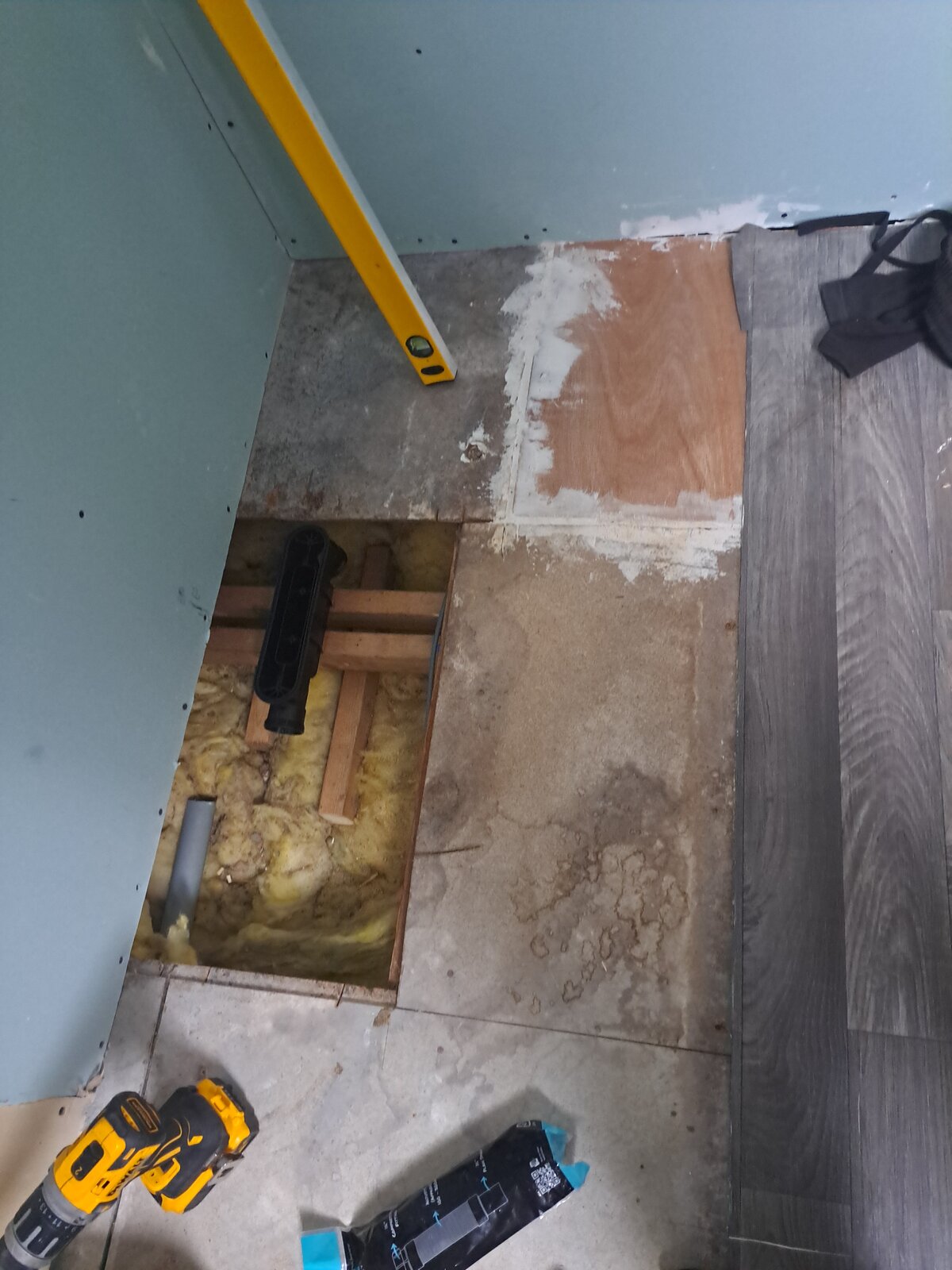

sorry asked this I think but a check on the shower tray lay, bathroom floor is heavy thick 25mm T&T boards, solid stuff, going to add some PVA bond then CT1 the tray down, part of the area is ply now as I had to get to the waste, I am going to lay like this, will this be ok?.
also tricky to get to waste will use a flexi pipe to make easier McAlpine.

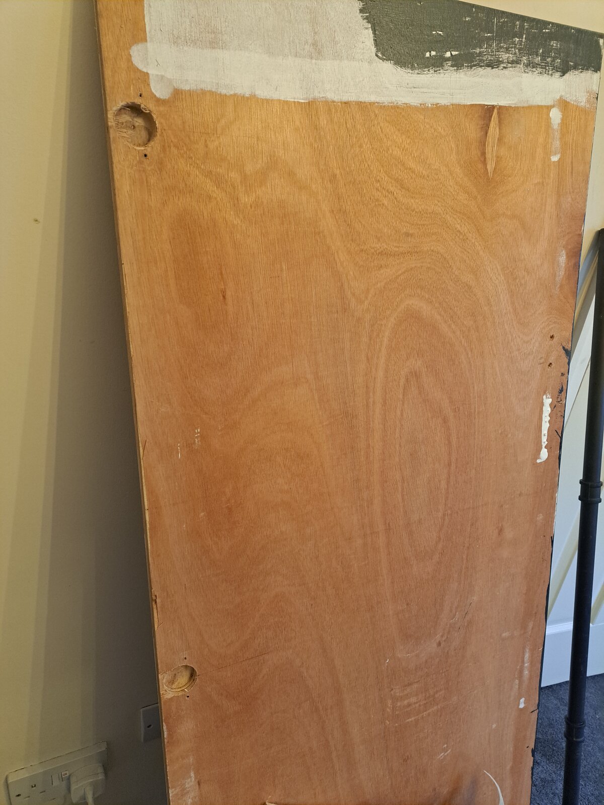

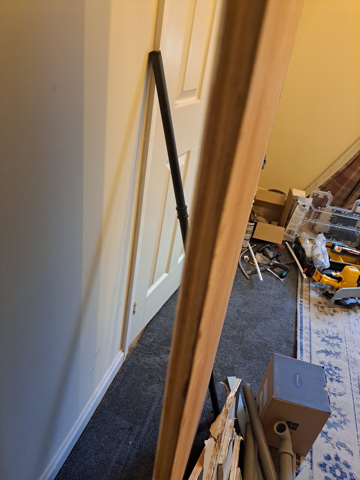

Hi Rob, thanks for advice. Here are the pics, chipboards is 22mm, ply is 18mm not sure what type attached pic. Happy to remove chipboard and replace with the ply got loads if thats best option and use battens to support then tank all, added new plasterboards to which are moisture resistant as old stuff was normal and rotten. I await your guidance, thanks

Hard to tell which ply it is from a pic though the colour does suggest it's hardwood, softwood tends to be lighter. No matter, as long as it's tanked well and properly supported.
Looking at that space, I presume the shower will be sitting against the left and top walls therefore best to fit the dwangs along where all the outside edges of the tray will sit, then lay the 18mm screw tight to the joists/batons then use some silicone to 'glue' the 3.6mm on top and screw that down onto the board @ 150mm spacing with 25mm screws and that will increase the whole board thickness to 21.6mm. Then tape all the corners/joins (primer the space, then a coating of membrane in the corners/joins and stick the edging tape to that then paint over it to seal) and at least 2 coats of the membrane - let one dry properly first.
Again, as far as the plasterboard is concerned it doesn't really matter if it's moisture resistant, TBH there isn't really such a thing but again just tank it well.

Thanks Rob, sounds like a plan. I can cut the 600mm width ply I have as the tray is 800mm into 2 pieces 600mm x 800mm for the 800mm x 1200mm tray and tape that up then add the thinner layer of ply and repeat...all a bit more work but want to do it right, the pipe waste not easy to get to going to use a Macalpine flexi pipe from the shower waste to the pipe underneath...thanks again mate.
