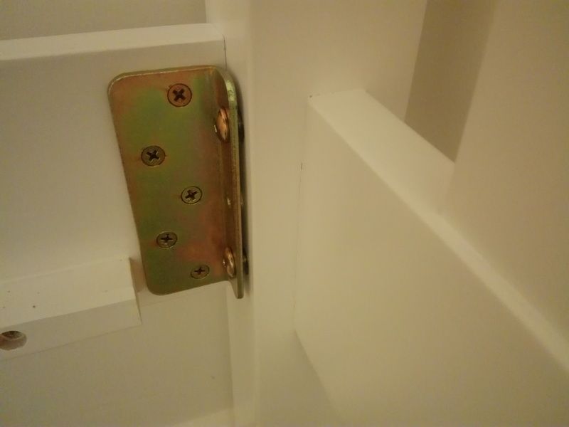

It is normally dead easy. I have assembled many beds in my time. This one had no instructions.
It has a headboard, a footboard (easy to tell them apart as the footboard is lower) two side rails and a string of battens attached together with ribbon.
The side rails have substantial metal "L" brackets pre-attached to each end.
The only problem is that one bracket on each end of the side rail does not meet the wood of the head or footboard, even when the hex screws are fully tightened and the woods are touching each other (if you know what I mean).
The whole bed creaks like heck, just putting light pressure on the side rails.
I first thought I had mixed up the rails, that they were meant to go a certain way round, but quickly realised that if I transposed them, I would still have the same issue.
Then I thought there may be a reason it was like that, but couldn't think of one.

Unfortunately, no. So the bracket is okay on the side rail, but doesn't fit properly when fixed to one of the boards. Why not, what's holding it away. Is there a central post down the bed supporting the slats that's too long.

It looks to me like the bracket is screwed into the side rail too far from the end of the rail.
Or am I missing something?
Sorry, the pictures have just popped up. The brackets aren't fixed in the right position on the side rails; they've been set back by the depth of the gap, and I don't think they can be repositioned. Can you fit some plastic spacers behind the bracket and the headboard. Is the bed new, if so, reject it as not fit for purpose.

Unless you sent the pictures, the manufacturer will assume that the products okay, and just send you the assembly instructions. If you've got a good sliding saw, you could remove the bracket, and take a couple of mill off the side piece.

Bodge it with plastic packers as Doggit says. It won't show. None of this self assembly furniture is much good. It's only as good as the assembler's skills at improvising.
