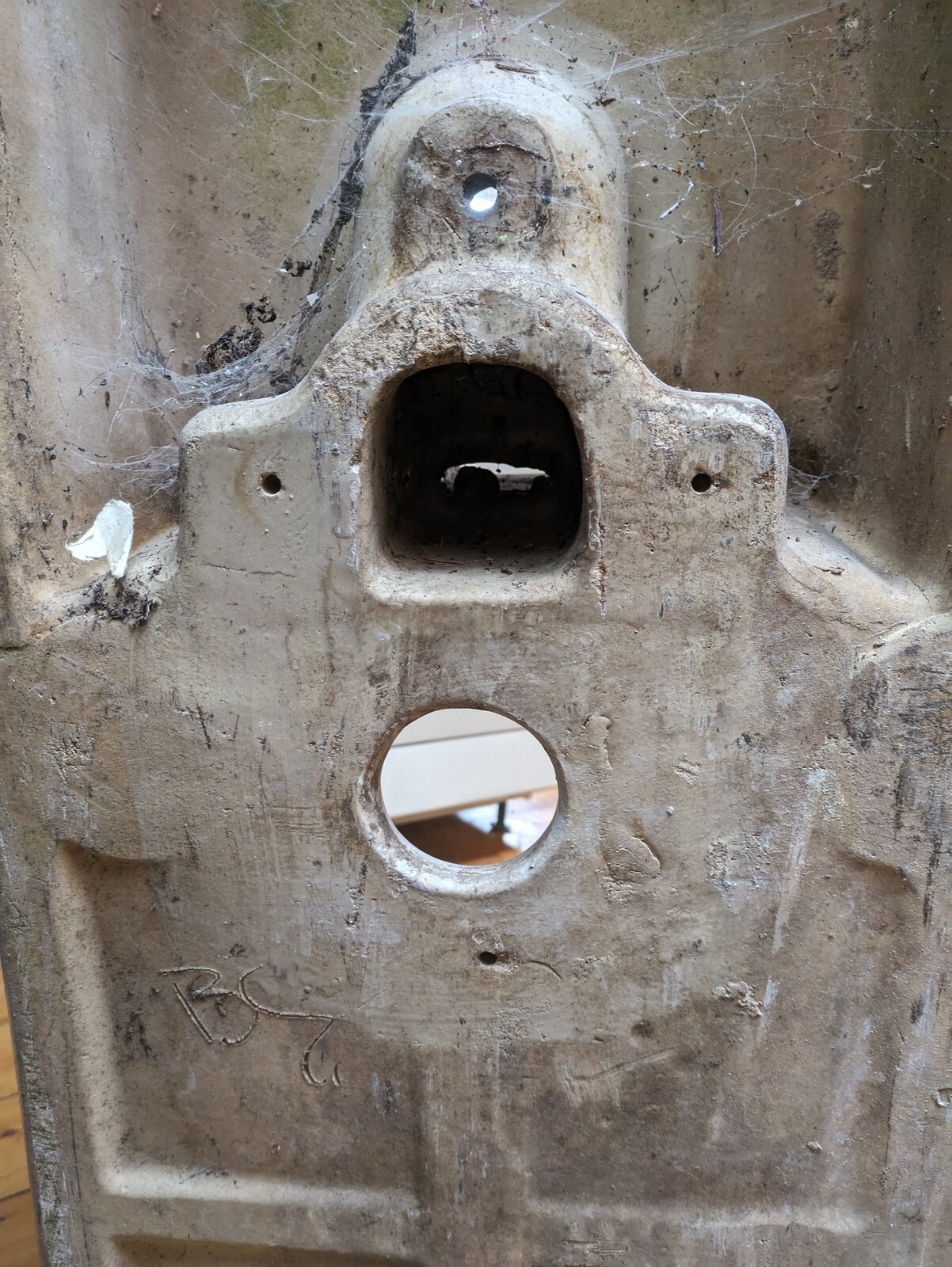

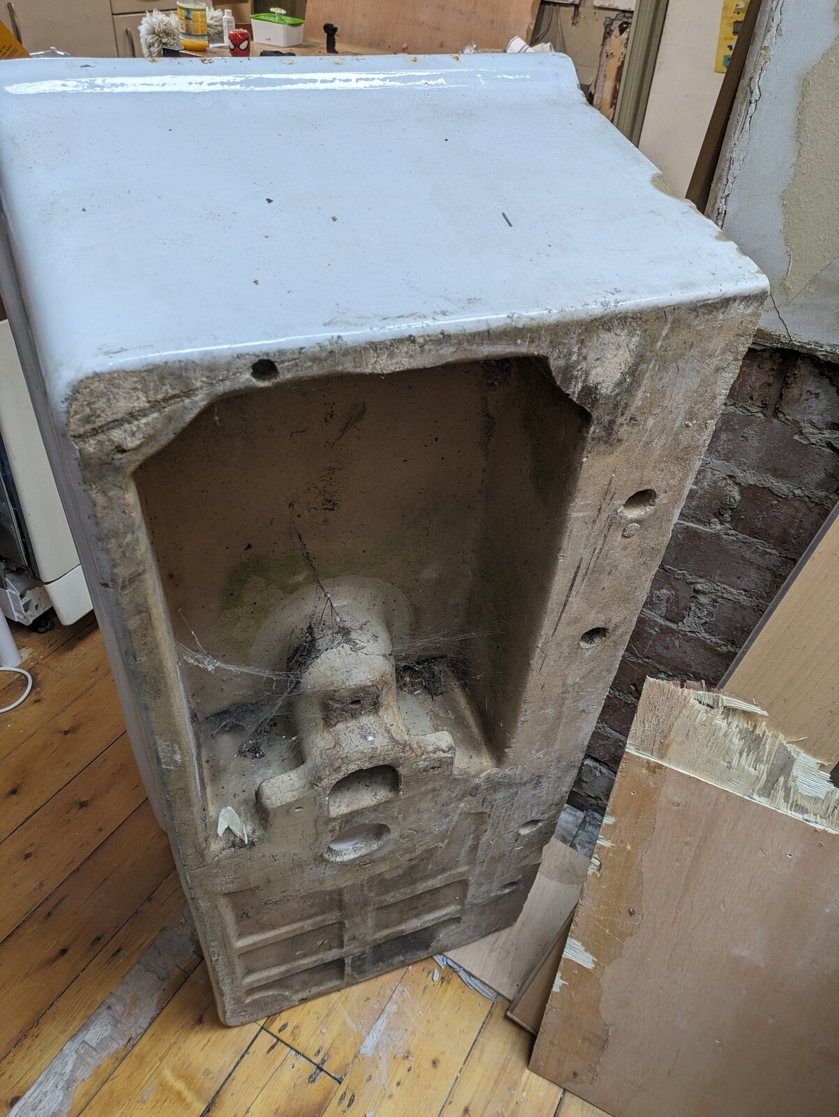

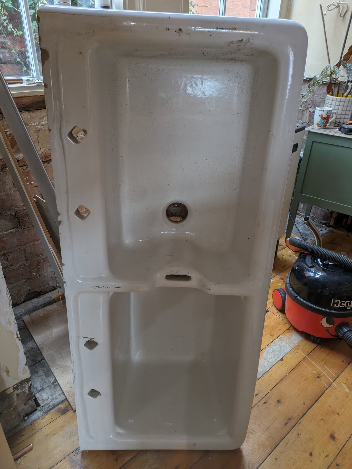

We're currently in the process of renovating our kitchen and my wife found a big old sink on Facebook marketplace that she wants installing but I am having a difficult time finding a waste and trap that will fit it.

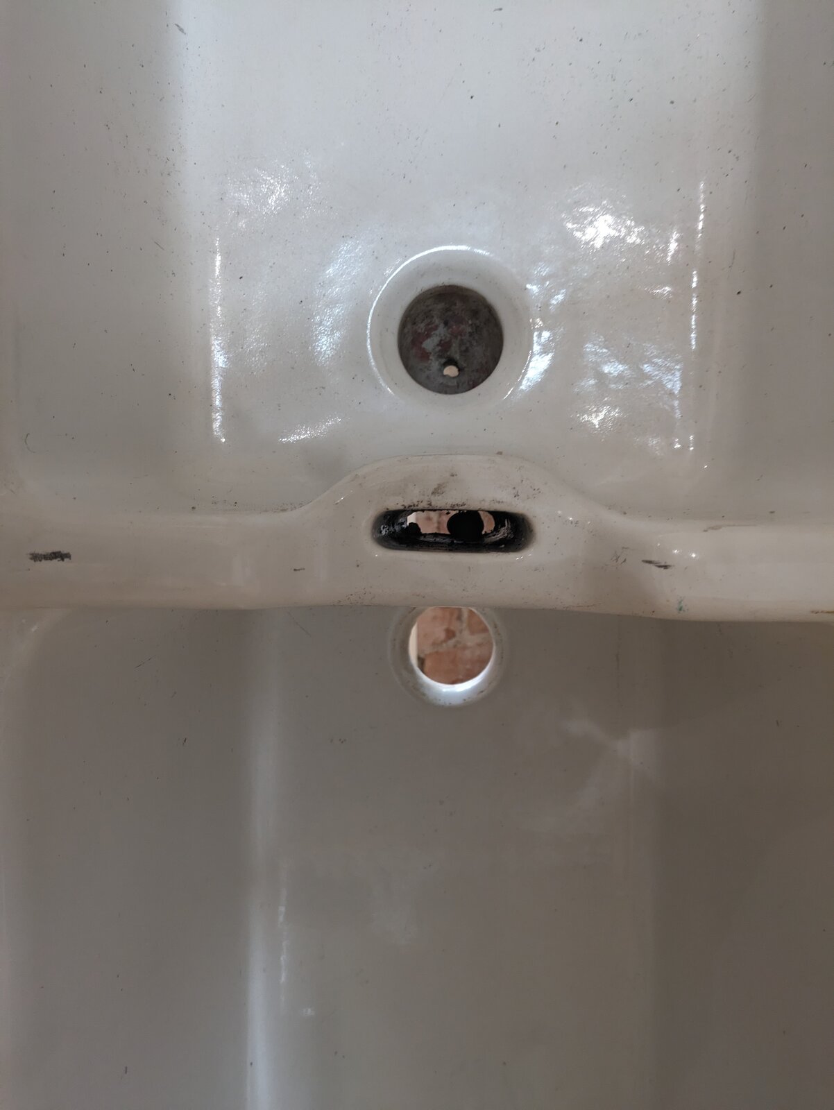

All the wastes I have seen are designed to go straight down through a vertical plug hole but one side of this drains toward the center then goes down so that the overflow can drain from the same place.
I can find a plug to fit it as there's still a hole available to put a bolt down but there are holes on the bottom to attach a waste to front the looks of it and I have seen nothing anywhere in my searches yet that would fit on the bottom of this sink.
Any pointers in what to search for or products that would work would be amazing.

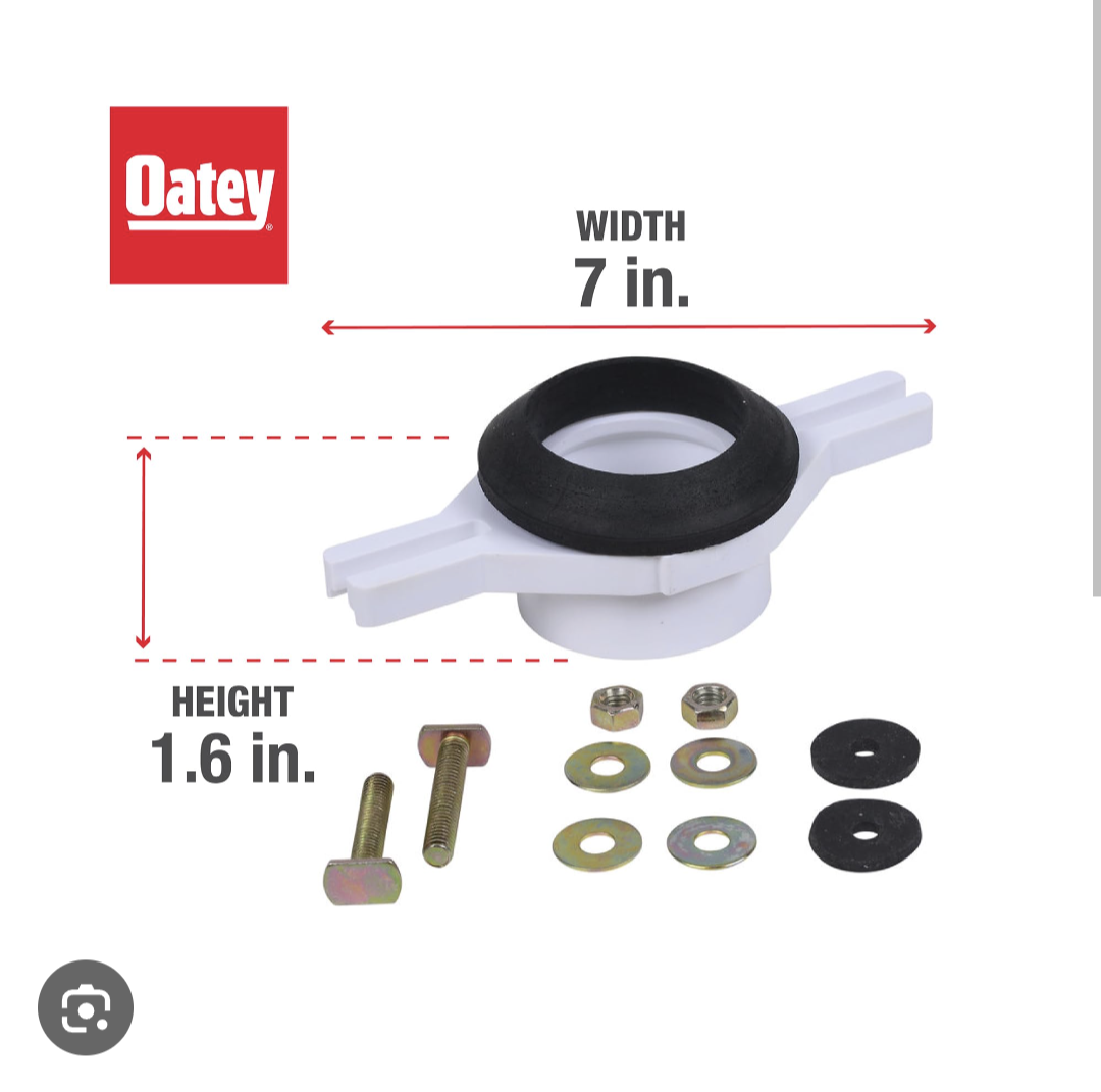

For anyone else coming here we had a recommendation from an old plumber friend that weight be able to use an adjustable urinal flange plate like this.
It might not quite suit our needs but I'll follow up with results once/if we try it.
