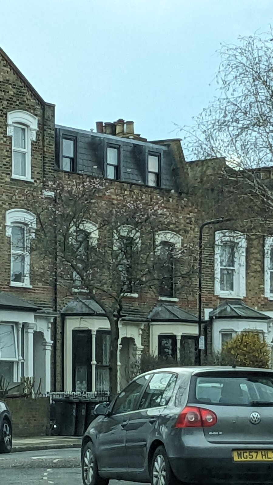

Interesting to see if I get any builders willing to take on such a design....Anyway these are the plans with example photo of what the extension should look like. Can anyone explain why there needs to be 4x timber joined for 2T14 instead of say 2x? would be interested on your thoughts of the structural design. thanks
