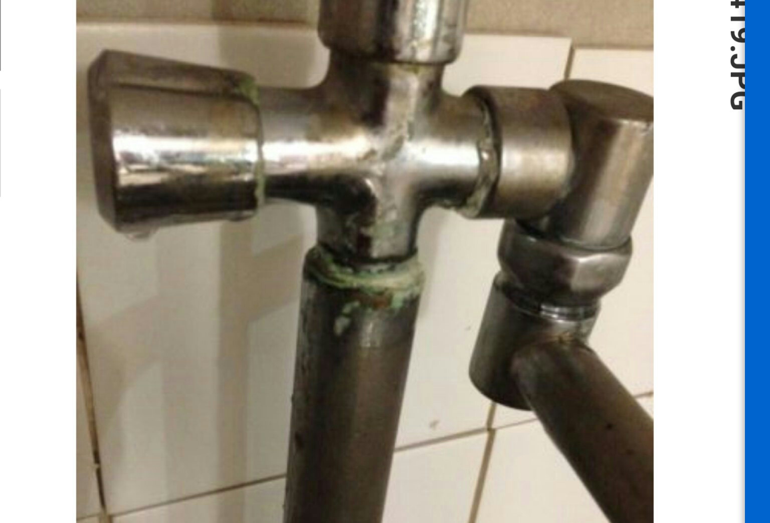

I have just sold a commercial spray attachment on a commercial sink and the buyer is complaining about a slight drip on the button (see photo)
He is saying that his plumber is telling him that it is not cost effective to repair
Can anyone confirm the likely reason for the drip and is it a quick fix, ie just a washer ?
Also, are they easy to replace ?

It looks to be in very poor condition!
They are usually a shaft with a groove and rubber "O" ring seal. A keen plumber MIGHT be able to match up the seal against one in a kit of "O" rings but that is not a job that I would offer to take on.
The shaft might well be badly worn and need replacement!
