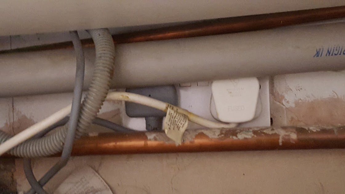

    Washing machine & dishwasher plugged in behind kitchen units.
    Removed a section of the back panel to show: electrician and plumber/gasfitter were not singing from the same hymn sheet.
    End result: Not got brilliant access or adequate isolation ... an understatement perhaps? 20151120_134314.jpg

    Well, the socket must have been there first so that makes the plumber/ gas fitter an utter lazy arse!

    But they must have been GasSafe "qualified/certified" to undertake such work :(

    BS 6891: Specification for the installation and maintenance of low pressure gas installation pipework of up to 35 mm (R1¼) on premises
    8.16.2 Separation of installation pipework from other services
    Where installation pipes are not separated by electrical insulating material, they shall be spaced as follows: a) at least 150 mm away from electricity meters and associated excess current controls, electrical switches or sockets, distribution boards or consumer units; b) at least 25mm away from electricity supply and distribution cables.

    I'd have thought that one of the purposes of employing someone who has undergone some form of training and obligatory certification was the expectation of them doing a job to a satisfactory standard and the application of a modicum of common sense.
    Ah well ...... pay peanuts, get monkeys

    From the Gas Safety (Installation and Use) Regulations:
    Safe use of pipes
    18.—(1) No person shall install any installation pipework in any position in which it cannot be used with safety having regard to the position of other pipes, pipe supports, drains, sewers, cables, conduits and electrical apparatus and to any parts of the structure of any premises in which it is installed which might affect its safe use.
