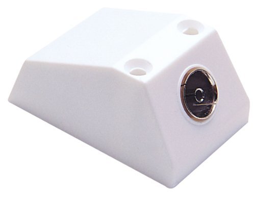

Does anyone know of a miniature flex outlet? It's to fix into a plasterboard wall.
There are these things:
But they don't have a cable clamp, and don't fix very securely to the wall. I'm imagining something a bit like those surface-mount TV aerial sockets:
but a (thin) flex outlet, rather than a socket.
Or something "architrave" size.
Any ideas?
Thanks for the suggestion. Their architrave-size plate only seems to be available in a metal finish, not just plain white plastic, which is not what I was hoping for. Hmmm.
I was wondering if some other country uses something smaller than our normal back box size that I could repurpose.
The wire is a small flex related to the heating system; the wall is plasterboard that will eventually be painted.
How about Architrave blanking plate drilled with 16mm stuffing gland?
