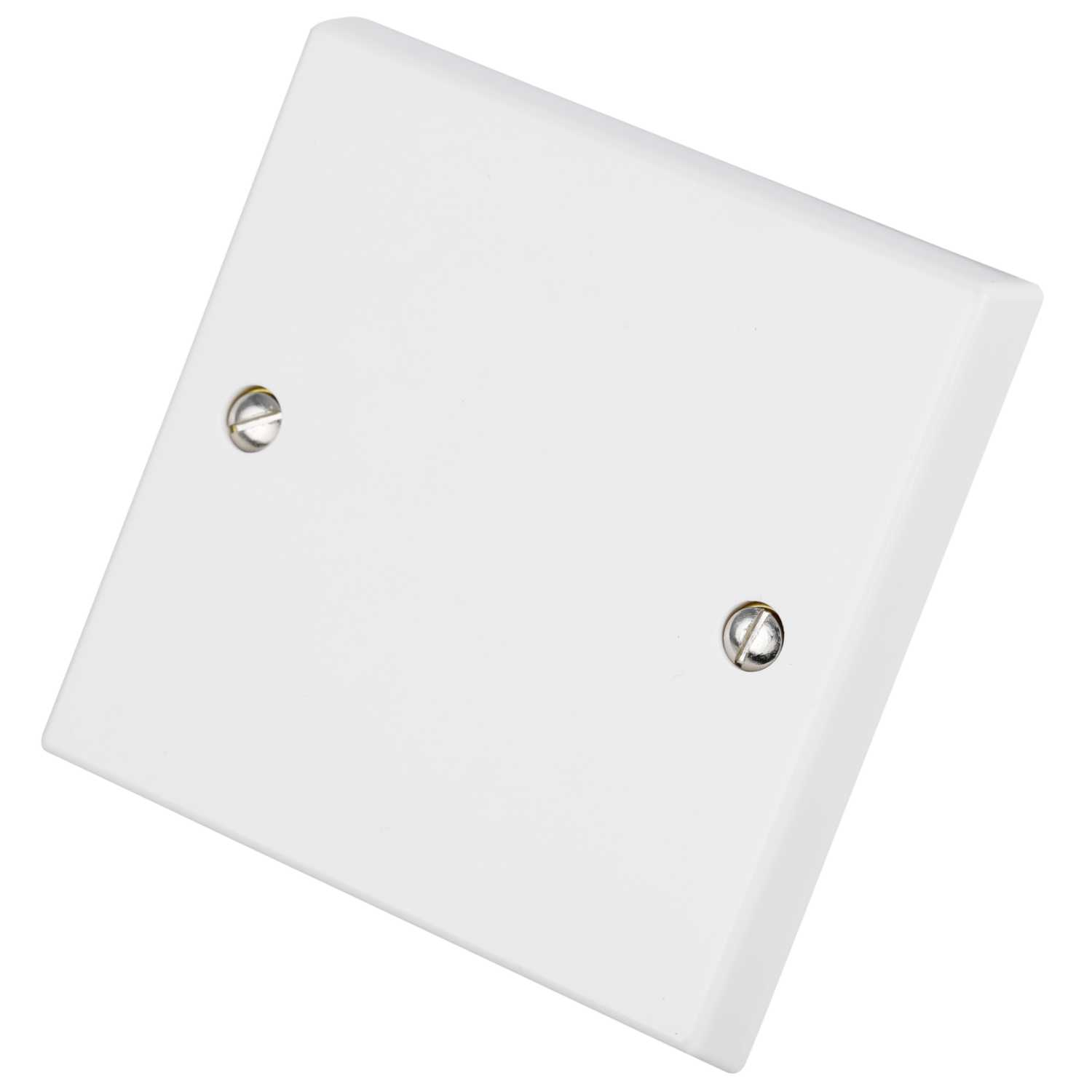

Use a flex outlet plate - it's essentially just a plate with a hole and (I assume) strain relief, so will do the same job but without the superfluous fuse or switch.
That's a possibility but, as I said, I'm not sure that he necessarily needs any accessory (unless for 'aesthetic' reasons) - since the cable coiuld presumably just go through the hole in his wall.
Kind Regards, John
Thank for the replies, yes I realise now that the cable could just go into a hole but that wouldn't look as good as having some kind of accessory.
Oh yes, and another way (the cheapest if you want an accessory) is to use a blank plate and carefully file a slot in one edge to take the cable. They can also be drilled - but that takes some skill not to crack them (the material used is quite brittle).
For an accessory a cooker outlet plate may be the neatest but if you don't need any joint my vote is with Simon and CAREFULLY filing the groove in the edge of a blank.

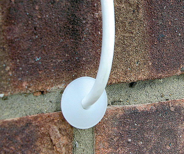

it might well 'look even better' if you simply used an appropriately shaped/decorated piece of wood or plastic
Not quite 'decorative', but what is used on the outside, could be used on the inside! :)
I used brushes, screwfix LAP range of grid devices included the brushes option.
That's certainly an option, but I personally have never found 'brushes' to be very aesthetically pleasing - in fact (as far as I am concerned) less "aesthetically pleasing" than a cable simply disappearing into a (neat!) hole in a wall. However, we're all different!
