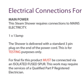

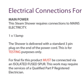

therefore, in my opinion this is notifiable work.
The cheapest/easiest route is for the electrical work to be carried out by a registered electrician who can self notify and certify this work.
Apart from the main power connection which is usually a 13amp plug all the electrical work is ELV.
Obviously you seem to have much more experience in these specific areas. But the installation guide from this maker seems to take a different view to yours.
I wouldn't trust the installation guide from a seller (not maker) who does not even know part P is one sentence in the building regs not a qualification.
I have installed two, both in my prievous house. They come with a big box which contain the steam generator and a big switch mode power supply. It has a heavy lead with an inline 10mA RCD and ends in a 13 amp plug. There are various other weady connectors on the box supplying no more than 24 volts to all the pretty lights, fan, ozone generator, control panel etc.
