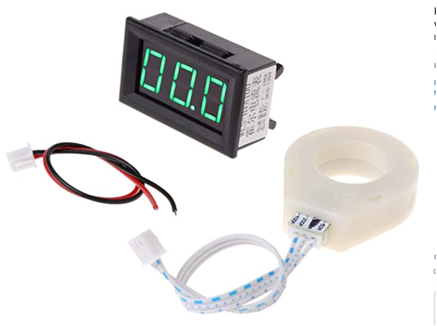

Have an iron partially in the fire with regard to a non-invasive Amp meter, effectively a remote clamp meter device. upload_2020-6-29_15-48-42.png
This would satisfy my interest in the Amp situation during a journey.
