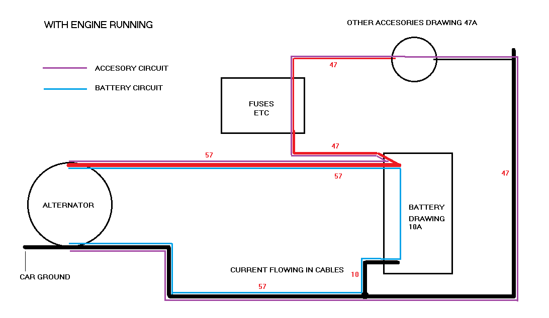

Pretty much got to the nub of it, just unsure about the neg (grnd) lead amp reading - Only found the vid where the author says neg cable (+ve) amps, engine running is the current flowing into battery - So what happens at tick over with headlights on and climate control working - the current is shared twixt loads and the battery charge requirement ?

It's all one system, the alternator is maintaining 14.4v across the whole system.
The alternator doesn't pump a fixed current, the current is a variable depending on accessory load and battery condition AND a 14.4v target voltage
With SMART charging the PCM pushes the system voltage above 14v (much higher in some instances) this creates a current draw at the battery that the alternator supplies.
There are multiple grounds on a car, so you can use the -ve from battery to ground to gauge amps to the battery (thats how the shunt on the -ve terminal works on SMART alternator cars).
Once running you could in theory remove the battery and it would run just off the alternator output alone.
So to sum up the Load (battery plus accessories/ PCM etc) and target Voltage (14.4 in your case) determine the current output from the alternator.
If you want a fixed current you would have to adjust the Voltage for a given Load.
The current required is determined by the battery (and/or electronics), just like any other accessory, and is flowing from the alternator to the battery and back to the alternator.
Well, 'out of' the battery back to the alternator.
It has to have the same current on (the relevant part of) the negative as the positive.
The return current from the other accessories to the alternator flows through the car body; not the battery negative lead.
You can have more than one circuit on the same wiring.
Probably not depending on the draw and how much the alternator can supply at tick-over.
