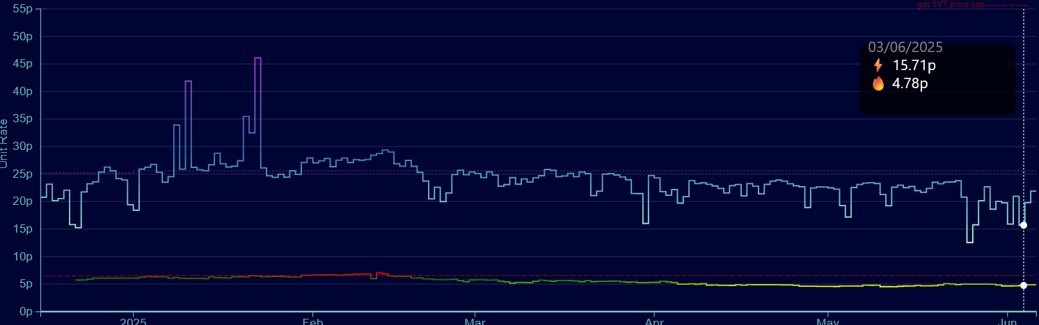

On the other hand, they can open up the opportunity to make some substantial savings, which are simply not available to those with a simple, dumb meter. This is what I have been paying each day, on my smart meter, versus the straight line, on the graph which represents what you would be paying per unit, with a dumb meter.
Yes, in January, it briefly exceeded 45p per unit, days when you simply try to minimise your consumption, but as the graph shows - most of the time, it is well below the CAP, which makes up for it and then some. I'm on the Octopus Tracker tariff, only available with a smart meter - where the cost per unit, can vary each day, with the next day's cost, announced the day before.
With no energy storage, or micro generation, I see little gain having a smart meter. All the split tariffs I have looked at, the standard or peak rate is higher than with a single rate, so the only gain for me was not having to let the meter reader in the house. The IHD (in home display) does alert one to when there is heavy usage, but there were IHD's well before the smart meter, so no real reason for fitting one.
But with energy storage or micro generation then no real option but to have a smart meter.

I looked at BG's free Sunday power, compared it, and it didn't come close to my Tracker on cost, even if I managed to make good use of it. I have cheaper pre unit most of the time, plus times when it is much cheaper. We just try to hold back, what can be held back, until those cheaper times, even when we don't manage it, we are usually paying well below the normal rate.

We don't wait to cook our meal, and we don't inconvenience ourselves due to unit cost. We cook and heat with gas, and only delay until cheaper times, when it suits us, will not especially inconvenience us - don't forget, we are generally saving anyway, by being on the Tracker tariff, even if we do absolutely nothing.
