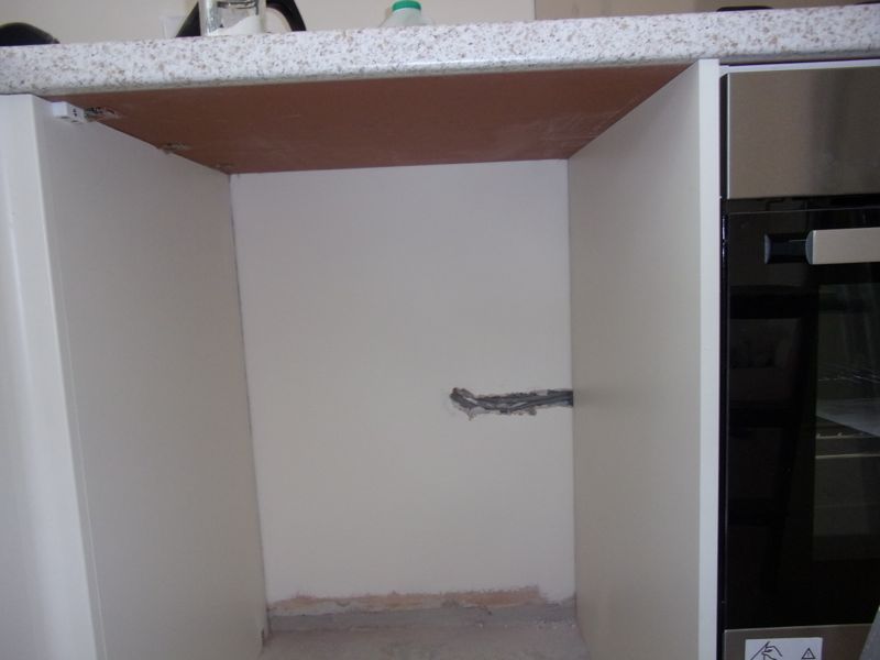

Apart from the vertical cables not being in a safe zone, does this comply with regs ?
It's in Mum's new house, they initially put a double socket behind the oven - for electric oven and ignition on gas hob. They've since added another single socket and cut a hole (about 2" diameter) in the side of the unit for plugging in a tumble drier.
I've had a look, and plugging in without removing the oven ... good luck with that :rolleyes:
The vendor pointed out how you just have to take a couple of screws out to remove the oven. Given that washing machines and driers top the list of fire raising white goods, it doesn't seem a good idea to have a drier where you can't switch off it's supply without getting out a screwdriver and removing the oven.
I'd have put the socket in the cupboard to the left - but of course, this would have meant the electrician doing something other than the minimum of work o_O The whole installation, and indeed house fit-out, is done on a "cut any more corners and you'd have a circle" basis - including not putting in a cooker circuit :evil:
But does it breach any regs ?
It's obviously not very 'clever' at all but, unless you invoke one of the catch-all regs ('poor workmanship etc.), I can't actually think of any specific regulation which is violated.
Don't forget that, desirable though it may be, there is (as far as I am aware) no regulatory requirement for any appliance to have a local switch or isolator - I think it could just be hard-wired into an unswitched FCU, with the only means of 'killing' it being in the CU.
Depends on how you define "accessible". IMO behind a fixed appliance which requires tools (and possibly two people) to remove it is not "accessible". Also I am assuming that the socket does not have MF connectors.
Good point - I was not thinking of it as a 'joint'.
Having said that, a substantial proportion of large appliances are connected via an accessory (with 'joints') behind them - be that a socket, outlet plate or whatever. Are you suggesting that they are all non-complaint?

As to accessible isolation this seems to be limited to where there are motors over a set size and not fitted into equipment which has some other regulation covering it. So most the white goods will not be covered.
I think there is something in the spec for plugs and sockets as to be mounted in free air, same for flex, i.e. should not be covered with a carpet, but in real terms something like a built in oven has a cooling fan so having a socket where it is cooled by that fan is not really a problem, until is comes to doing an EICR.
If one wants to look for loop holes in laws and regulations one can normally find them, when my mothers house was rewired there were many items I did not like, for the blatant ones I called them back, twin and earth overhead to garage for example they returned and corrected, however most I did my self, in the main quicker and easier to DIY than call in some one to do the job.
And this is the big question, even if you can prove they got it wrong, is it worth the effort getting it put right? It is a grey area so ask nice if answer is now get some one else to do it.
If you think about it, just about all sockets (and light switches, and ...) require tools to access the terminals - but I don't think I've heard anyone suggest that they should be considered inaccessible wrt to having maintenance free terminals. Removing the oven isn't a big job - 4 screws (or 2 where "someone" CBA to [re]fit them all) and it just slides & lifts out (small oven, not heavy).
