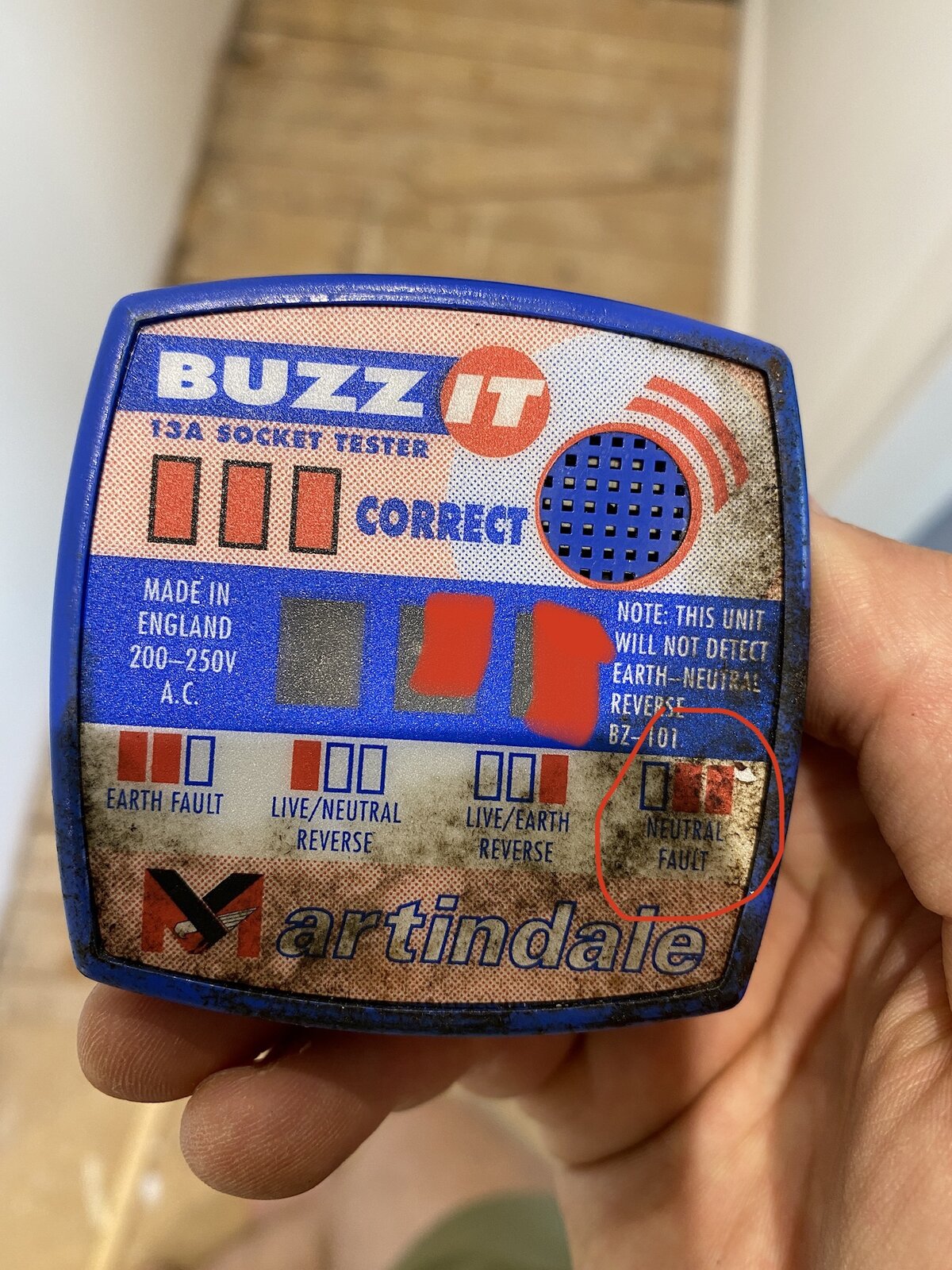

I guess we haven't tried a trapped insulation with marginal connection to neutral. That's if we haven't taken the wires out and put them back in yet. Also wonder exactly what the tester is showing on its display (a photo). It's pretty much narrowed down to 2 sockets if we know what order they are wired in.

OK. The only place the bad connection can be is on the last working socket or the first non working, as you proceed down the cable away from the CU. Or the wire between those two has been very badly eaten (right through one of the wires). That picture may help give more information.
So heres the socket tester, i’ve coloured in the lights as i’ve got a mate having a look at the electrics at the moment.
The middle light was flashing

OK, that's what I assumed, though the data sheet for that device doesn't mention flashing.
If it were a ring then there would be two routes for the conductors to take, so you would need two faults.
I stick by what I said in post #20.
