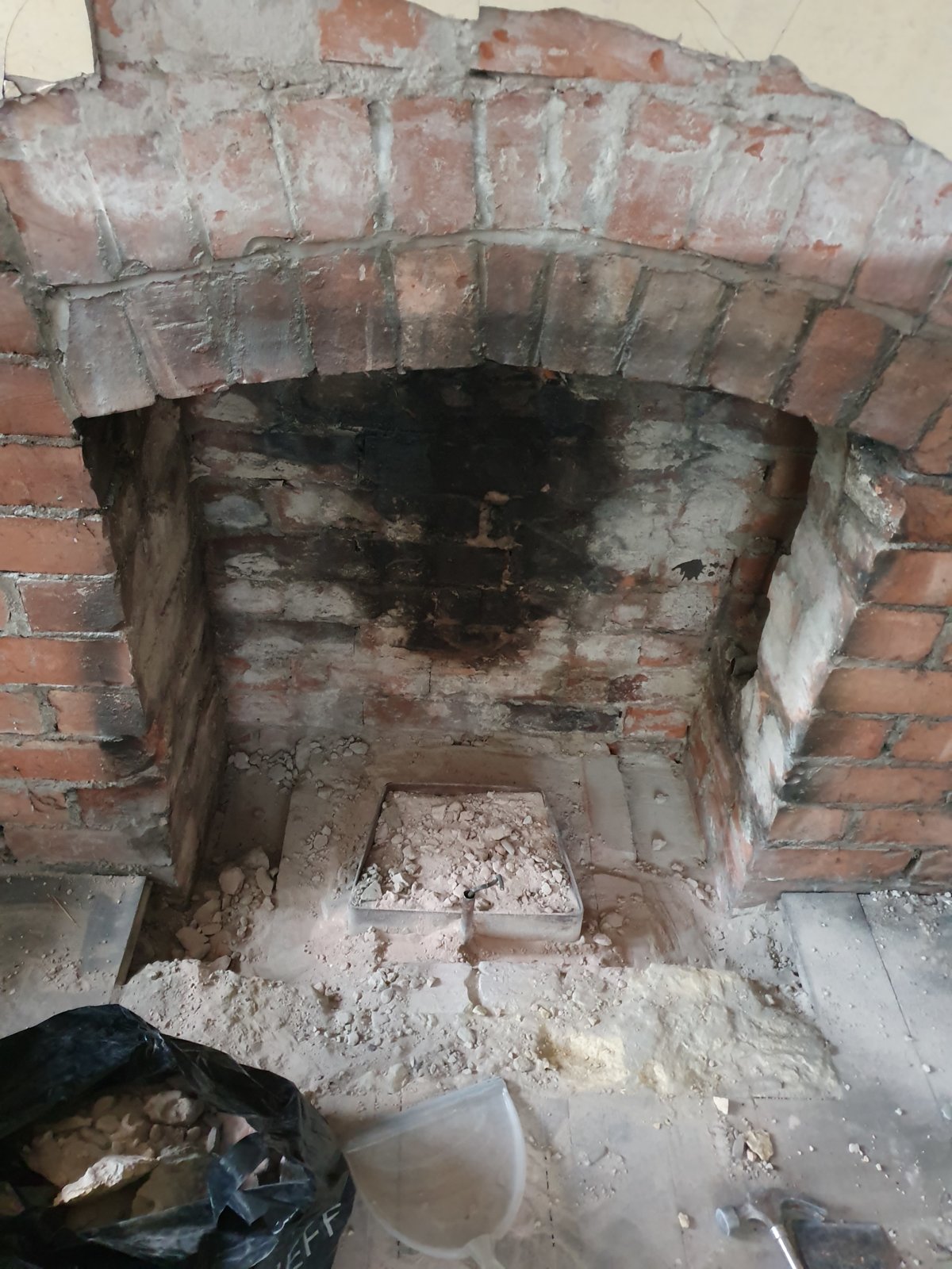

Hi,
I have just removed a 1950s concrete fireplace and found a back boiler & damper behind. Can I remove this myself? It looks easy enough to remove the bricks etc. I dont want to fit a stove or anything. I would just like it to be opened up. Any advice appreciated. Picture attached of the fireplace. Thank you.

Easy enough to do, you will need to drain the back boiler down first and cap the pipes, do you have a hot water cylinder in a cupboard directly above?, pics??.
No cylinder directly above. It is in the bathroom above but quite a way from the chimney. It is not connected to anything now as pipes are sawn off so must have already been drained down I guess. Thanks for the reassurance. I will have a good go at it next weekend.

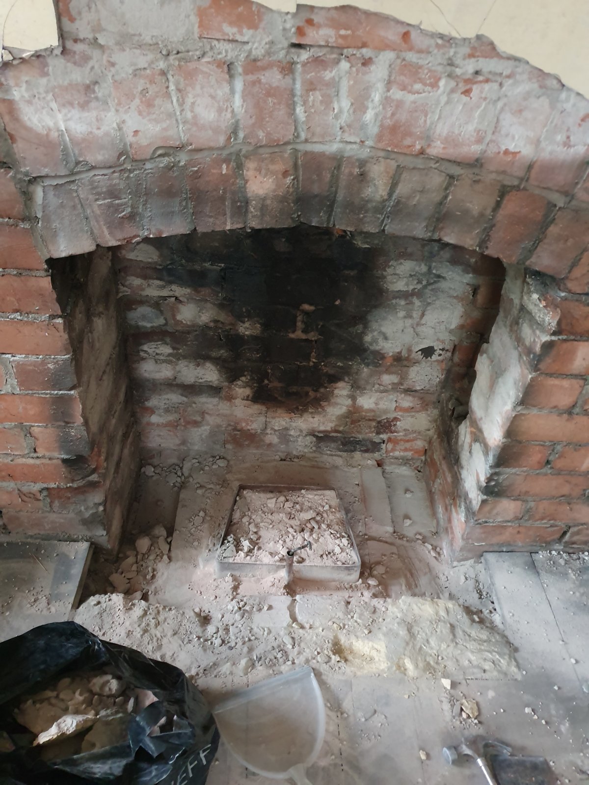

Update: back boiler gone! There was about a bucket full of water still in the pipes. Wasn't a hassle at all. Had a go at it with sds drill and grinder to cut the pipes. Now to get the grate out...
