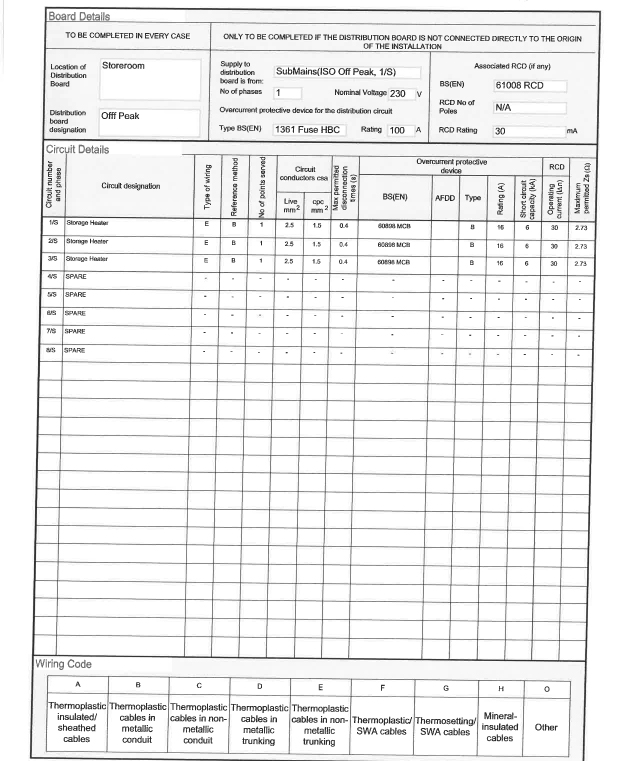

Now, regarding the storage heater. I think had an insulation resistance test on the ECIR which I assume showed no issue. Granted this was a few weeks ago and something can fail any time.
Is there anything I can do with a simple multimeter continuity test? Could this be done without dismantling the thing to get at the heating elements?
Or do I need something more beefy to test it, like another insulation resistance test.

ecir12.jpgThis is the one that relates to the storage heaters.

The insulation tester I got cost me around £35 no calibration certificate, but good enough for home use. There does not seem to be an insulation resistance reading on the sheet you show, seems odd no date either. I moved into a new to me house, and it also seems I have had a lot of faults, as if the owners before me had done no maintenance. But I am sure they had, I am just unlucky.
