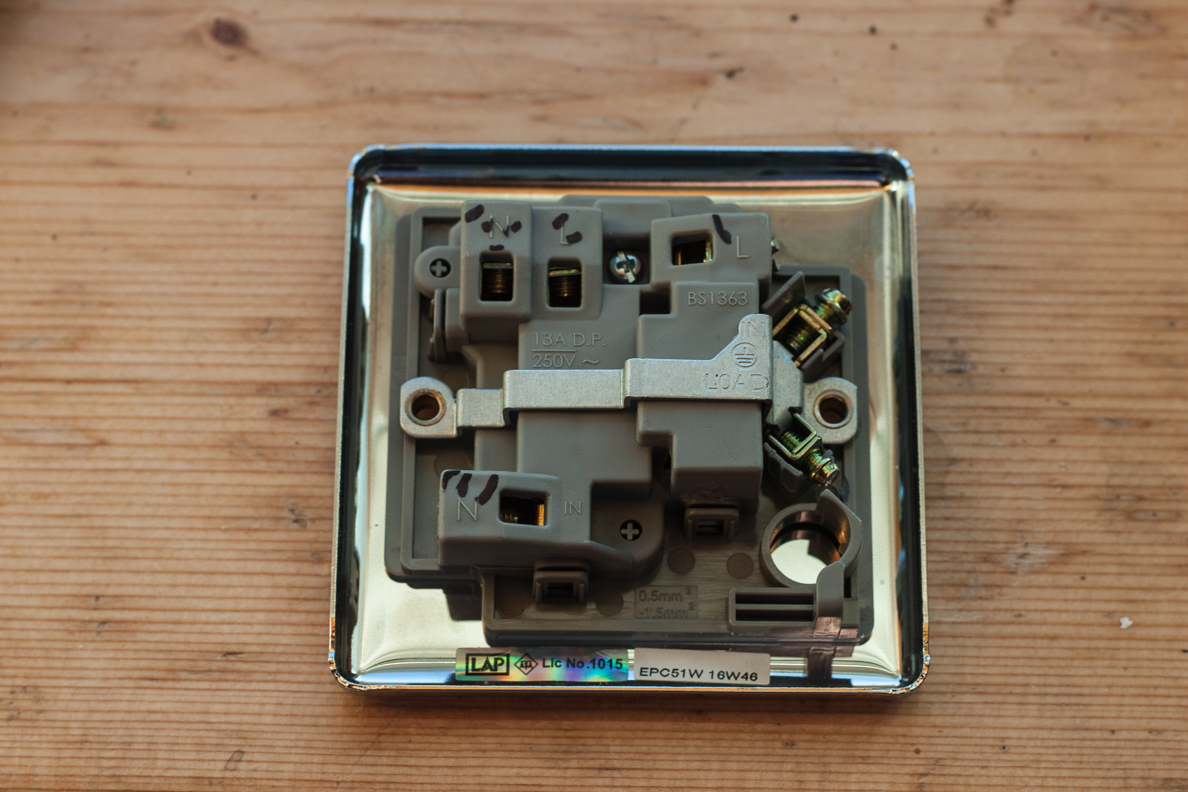

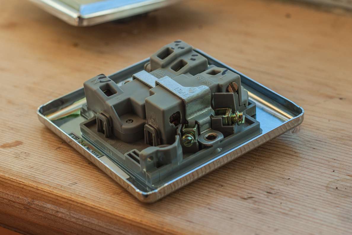

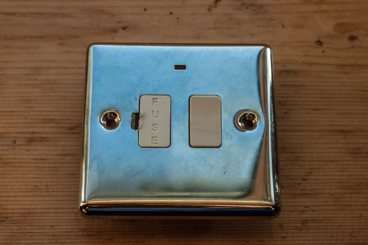

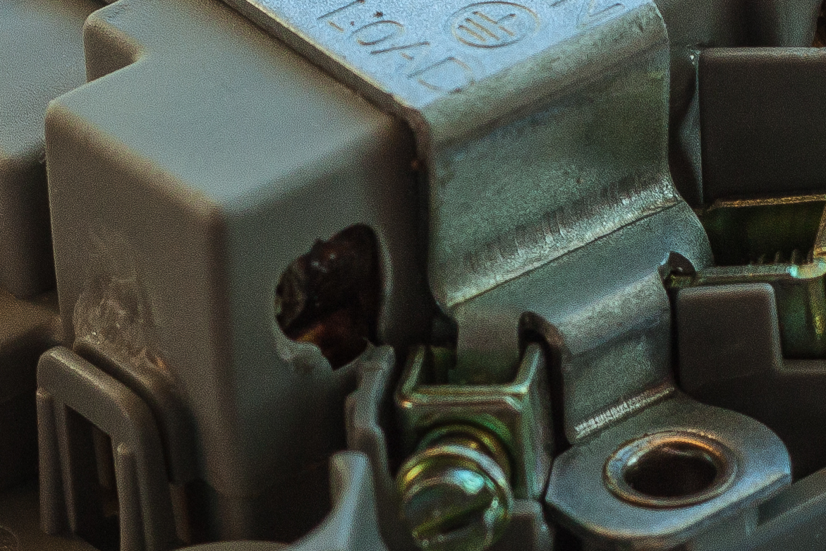

An update:
I swapped out the busted and incorrectly specified fused spur. It is a LAP brand.
At first glance it looks fine.
but the clue it really had popped badly is highlighted by the fact the fuse carrier won't open, even when prying with a beefy screwdriver , so ignore the damage to the fuse tray, that is due to me trying to pry it out (without success).
Looking more closely at the back of the fuse carrier you can see signs of melting.

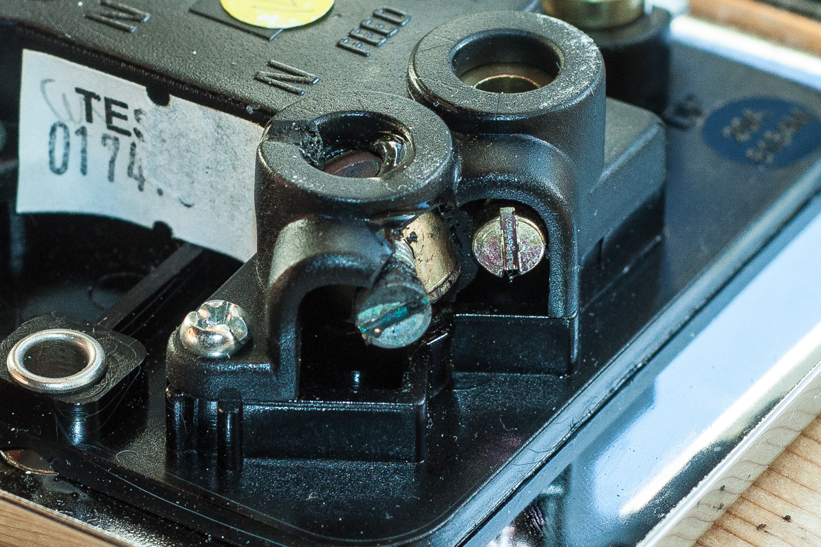

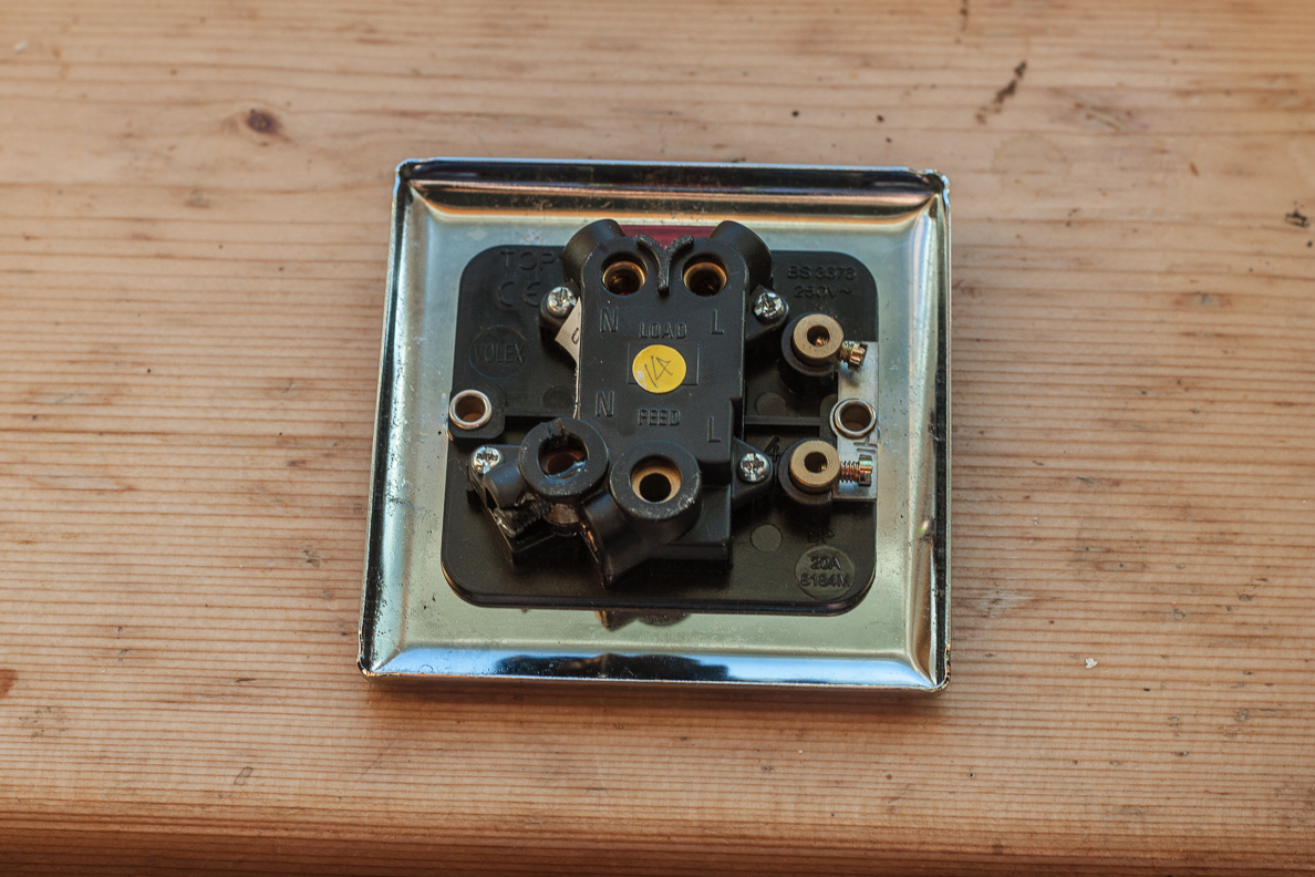

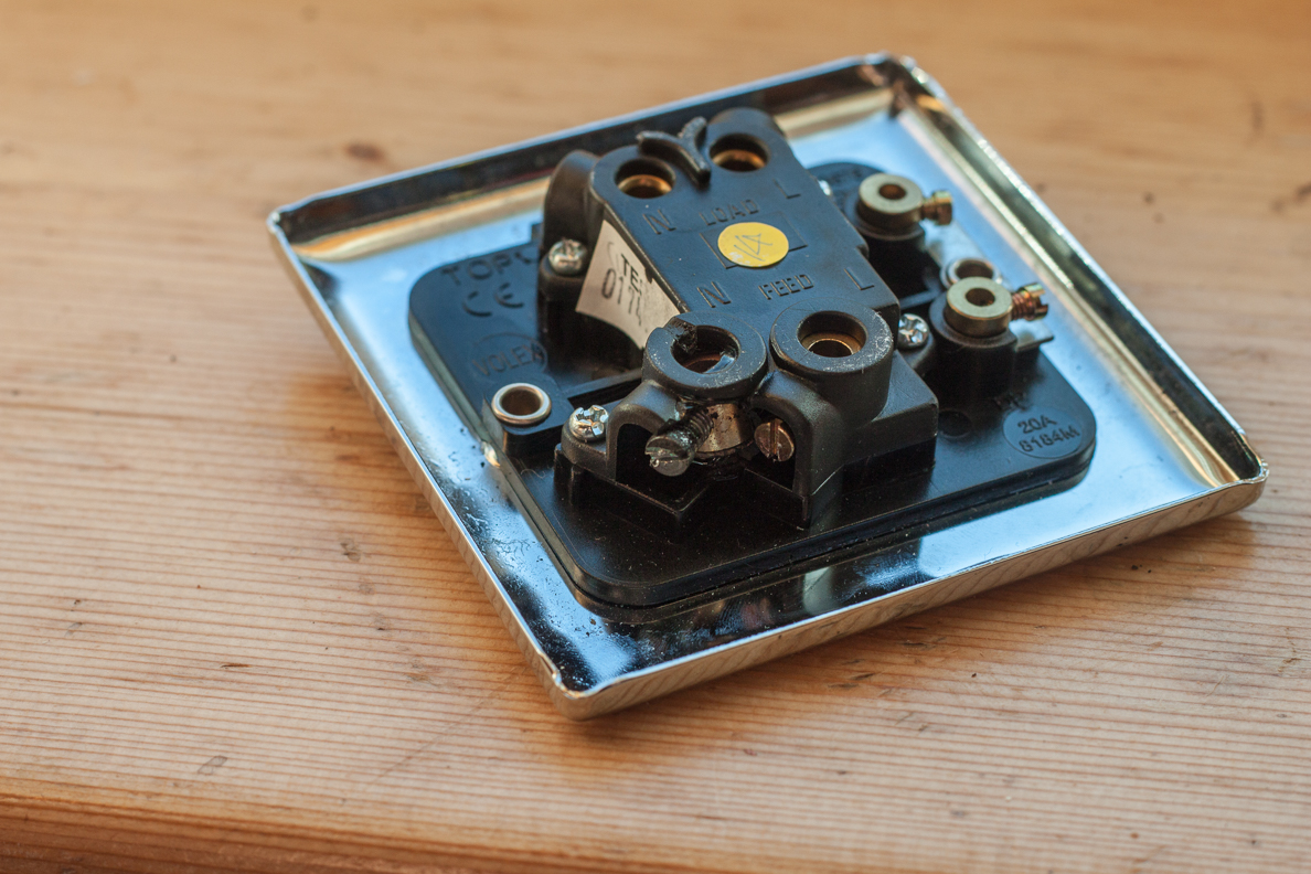

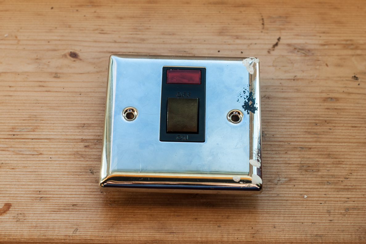

The next switch was the one with the dodgy neon, but also showed signs of not charging when the neon was not lit. So I decided it was a good practice to replace it too.
What I found was perhaps a bit more concerning. It was a volex branded 20A DP switch.
No sign of issue on the front.
The back was a different matter.
note: I had to crack off a bit of the plastic surround as the terminal screw had shifted position so much. This was not broken prior, just melted and probably more brittle.
Could this have been caused by a connection that was not tight? Or could there be an further issue.
The inputs were horribly located in this switch so I can imagine they may not have been done up tightly.
